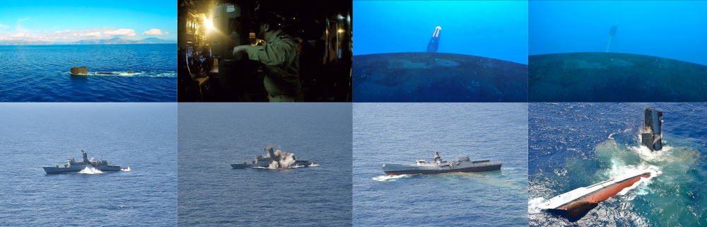

The Turkish Navy performed its first live fire with the DM2A4 SeeHecht Heavyweight Torpedo against the Tepe (Knox) Class Zafer Frigate, which was used as the target ship during the Beyaz Fırtına (White Storm) 2016 Exercise held on May 16-28, 2016. The DM2A4 Heavy Torpedo launched from a GÜR Class submarine scored a direct hit on the target, and the Zafer Frigate, which was retired in 2012, sank within 15 minutes after its hull split into two parts.

Additionally, on October 17, 2018, Mk37 Heavyweight Torpedo was launched from the AY Class TCG Batıray (S-349) Submarine to the target ship ‘Münfesih Taşkızak’ and on June 11, 2018, SST-4 Heavyweight Torpedo was launched from TCG Yıldıray (S-350) Submarine to the target ship ‘Lieutenant Commander Sadettin Gürcan’ logistic support ship, and the target ships were sunk.
On the other hand, a total of eight HWT firings, including a DM2A4, were performed in 2018 using the MÜREN Integrated Underwater Combat Management System installed in the AY Class TCG Doğanay (S-351) and TCG Dolunay (S-352) Submarines, which were modernized under the MÜREN CMS AY Project. The Turkish Naval Forces became the first Navy to fire DM2A4 Heavyweight Torpedo with the AY Class (Type 209/1200) submarine. As Mk48 Mod 6AT and AKYA Heavyweight Torpedoes are not defined within this project’s scope, only DM2A4 SeeHecht Heavyweight Torpedo can be used with MÜREN CMS. Under the ‘MÜREN CMS PREVEZE Project’, contract signed in August 2017, MÜREN CMS will be integrated into a PREVEZE Class submarine by 2023. In this project, besides the DM2A4 SeeHecht Torpedo, Mk48 Mod 6AT and AKYA Heavyweight Torpedoes can also be launched with MÜREN CMS. Within the scope of the MÜREN CMS PREVEZE Project, which has been in progress since 2017, the tests are expected to start in late 2020 or early 2021.
