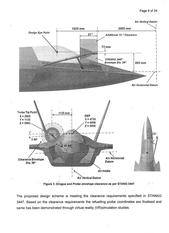

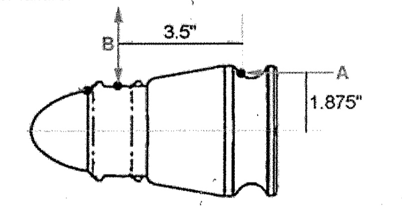

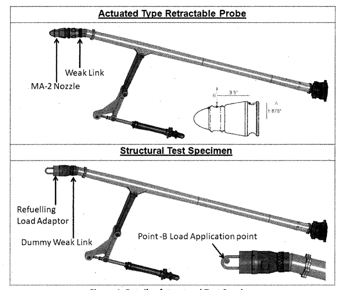

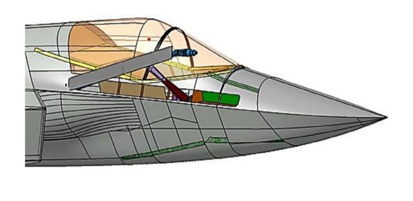

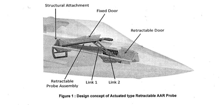

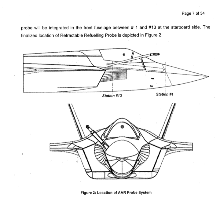

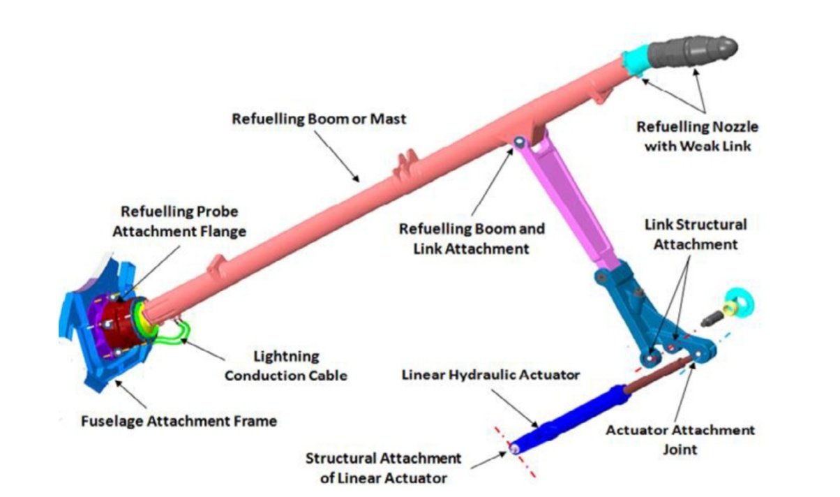

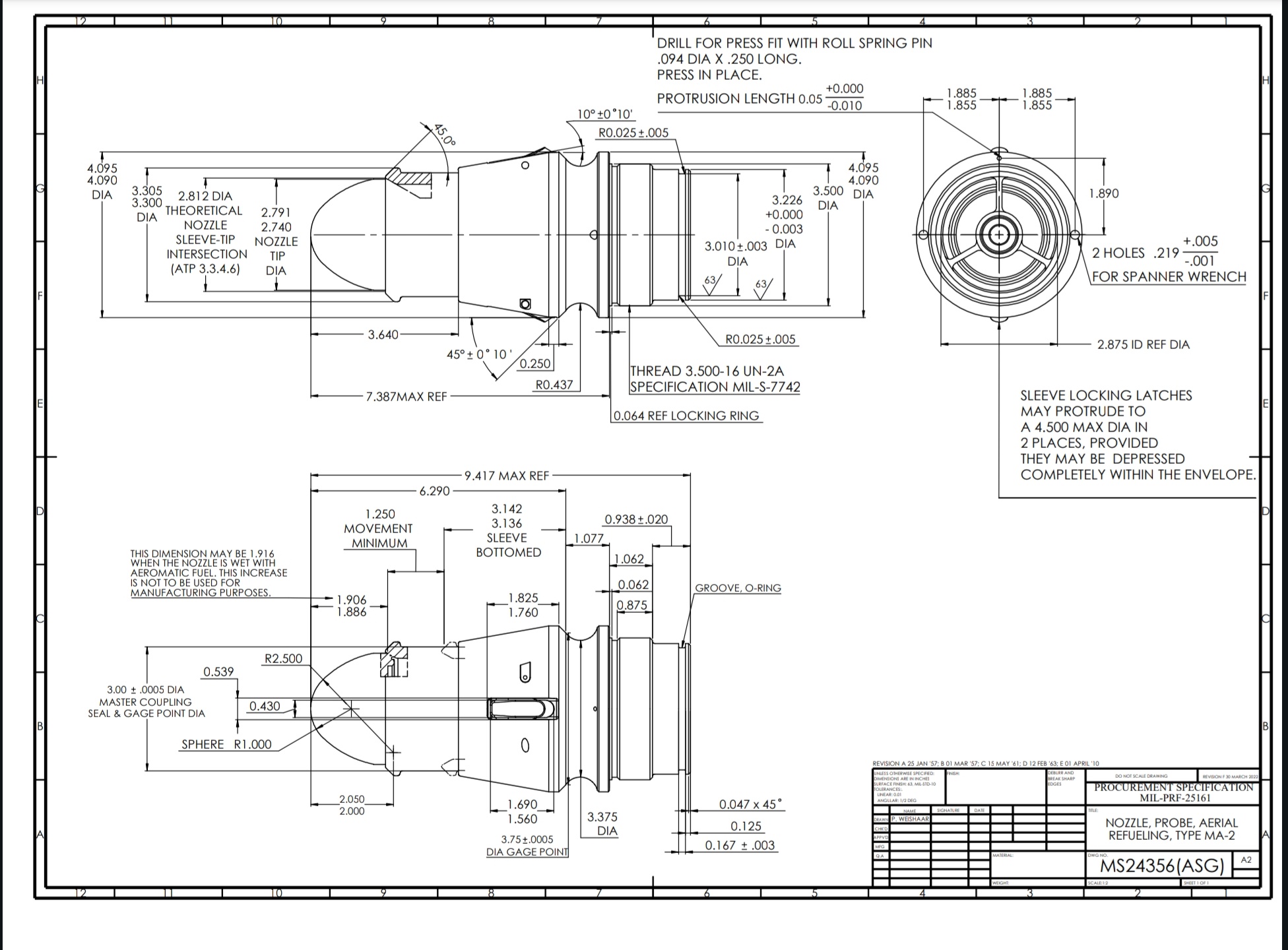

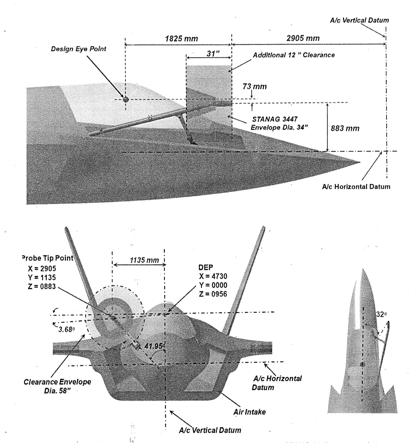

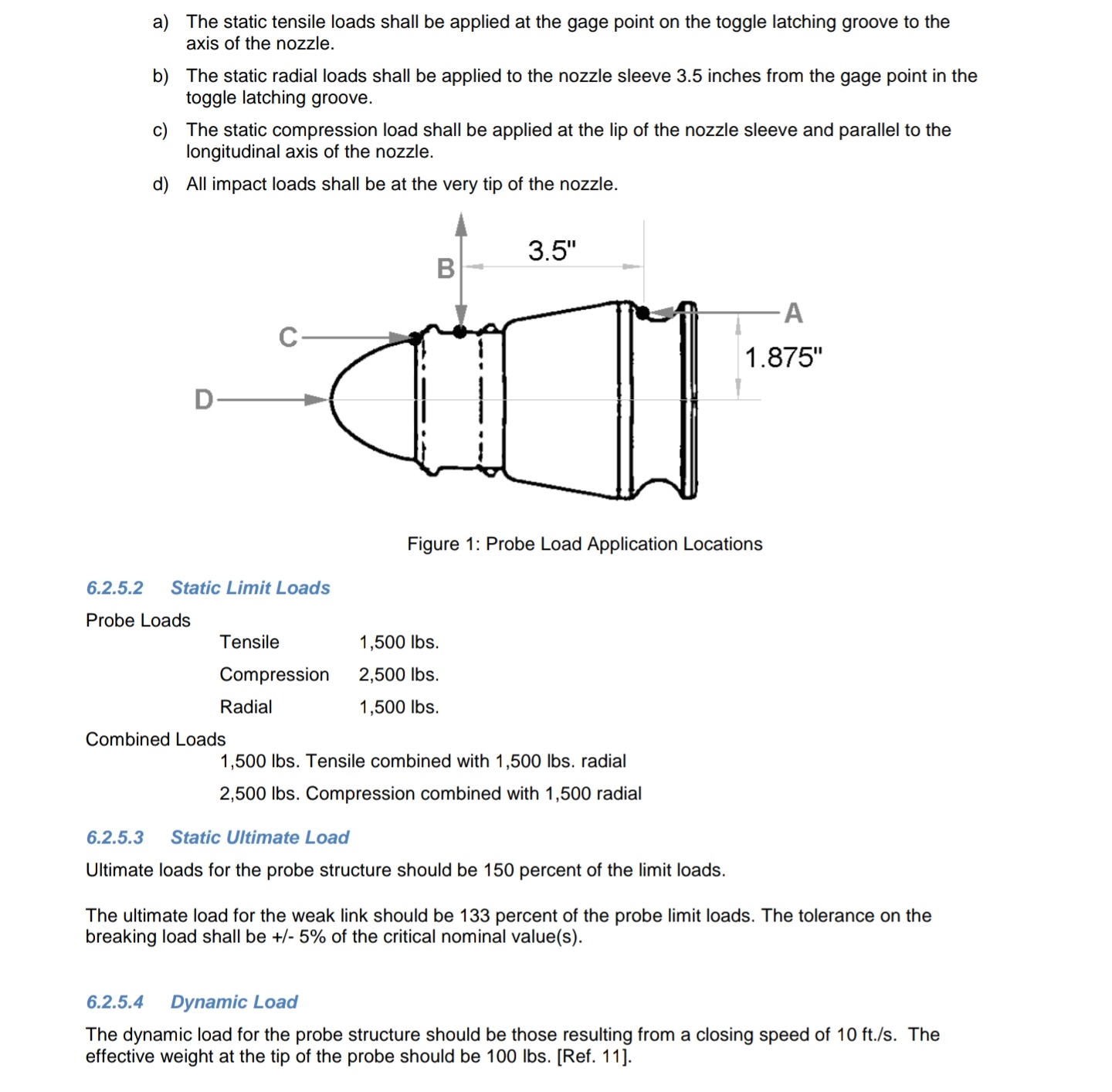

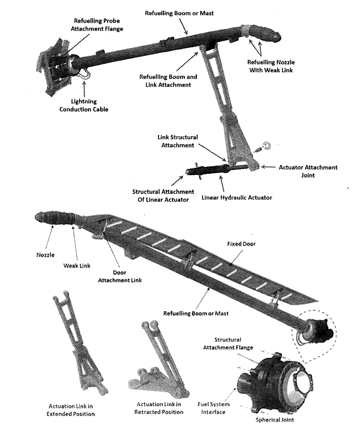

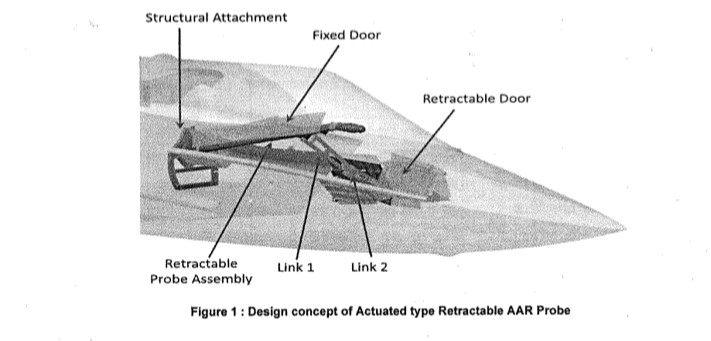

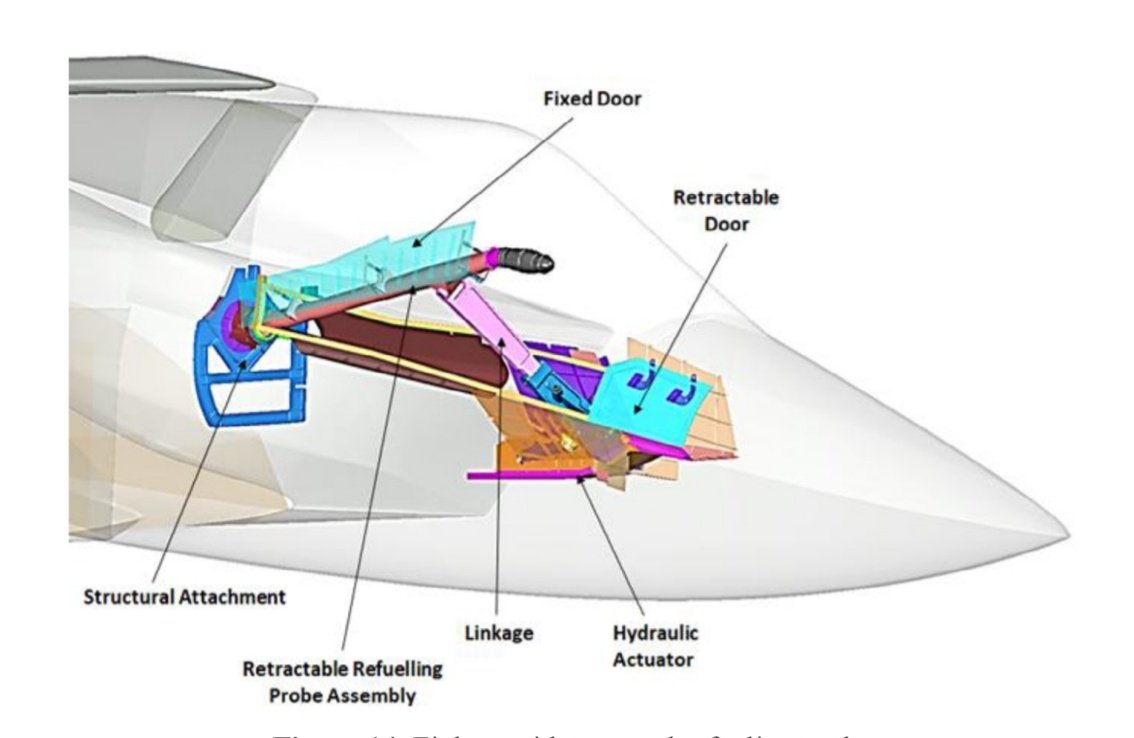

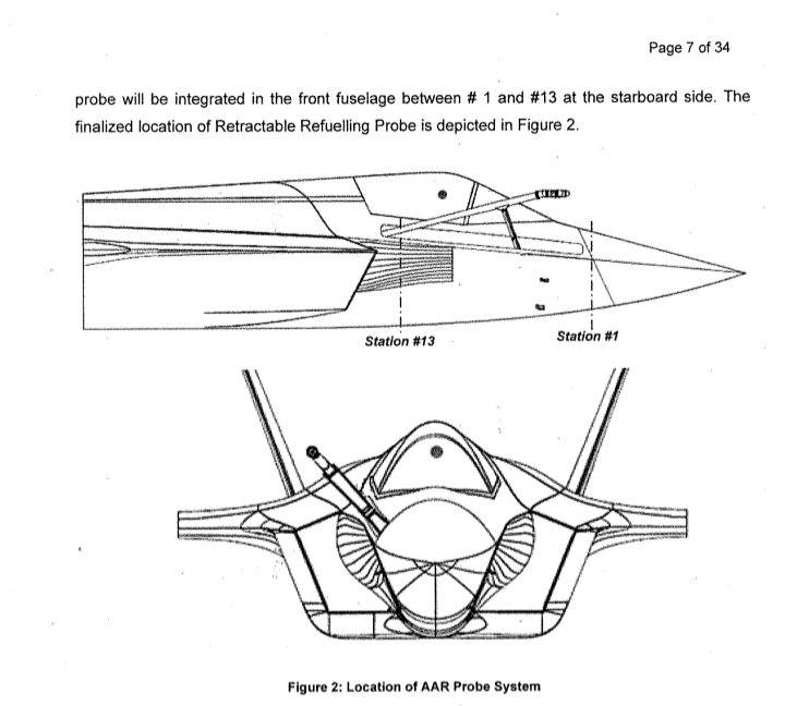

Some details on the AMCA's retractable in-flight refueling (IFR) probe mechanism:
Sourced via another forum.

Others can keep their opinion based on jets with IFRP like F-35, Su-57, etc, but IM🧅 apart from EOTS, i would vouch for a clean shaved cheek like F-22 with spine receptacle, no ladder, one piece canopy w/o arc, TacIRST like multi-function sensor, all these would reduce RCS & improve pilot survival.
Documentaries, articles since decades have shown that surface discontinuities, gaps, bumps, etc need to be minimum even after RAS, RAM treatment bcoz as jets body become smoother, some AAMs & SAMs using wavelengths shorter than X-band & future missiles could be multi-band.
Receptacle system would need additional cost of boom refuelling system, but mixed tankers like KC-46A, A330 MRTT also there. Old gen fighters can refuel by drogue. UCAVs/UAVs depending upon shape, size can be designed to use either system.
Spine IFRP can also be done but AFAIK no X-jet or drone has demonstrated it yet.

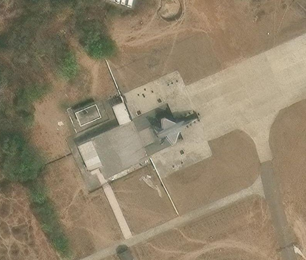

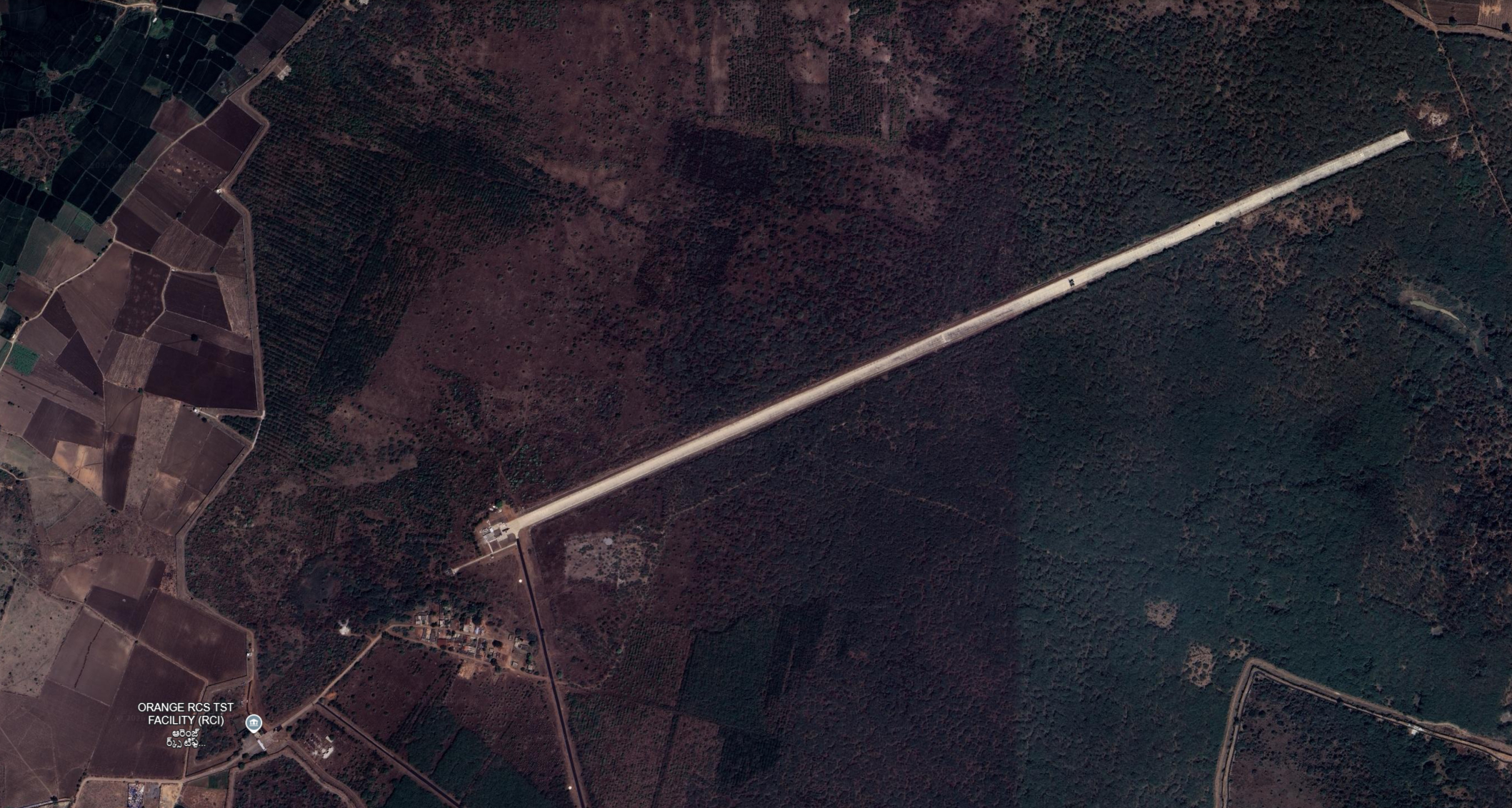

AMCA model spotted at the ORANGE facility near Hyderabad, sourced via Twitter/X (Apple Maps image of May 2026):
ORANGE is the Open-Range RCS Test Facility located just north of the Air Force Academy outside Hyderabad, southern India:

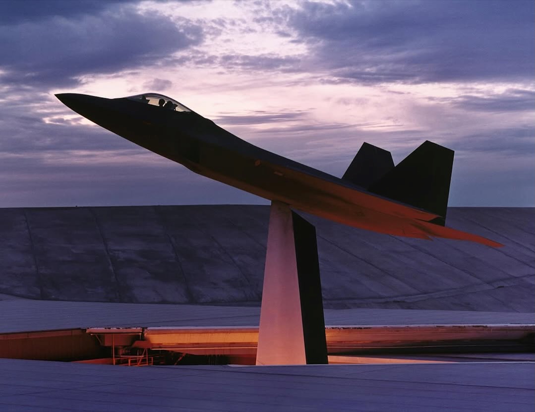

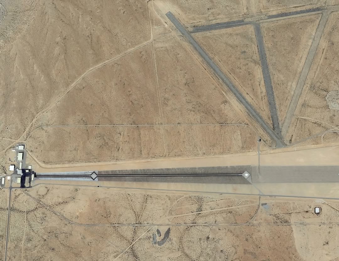

It's outfitted somewhat similarly to Skunk Works' Helendale RCS test facility in California:

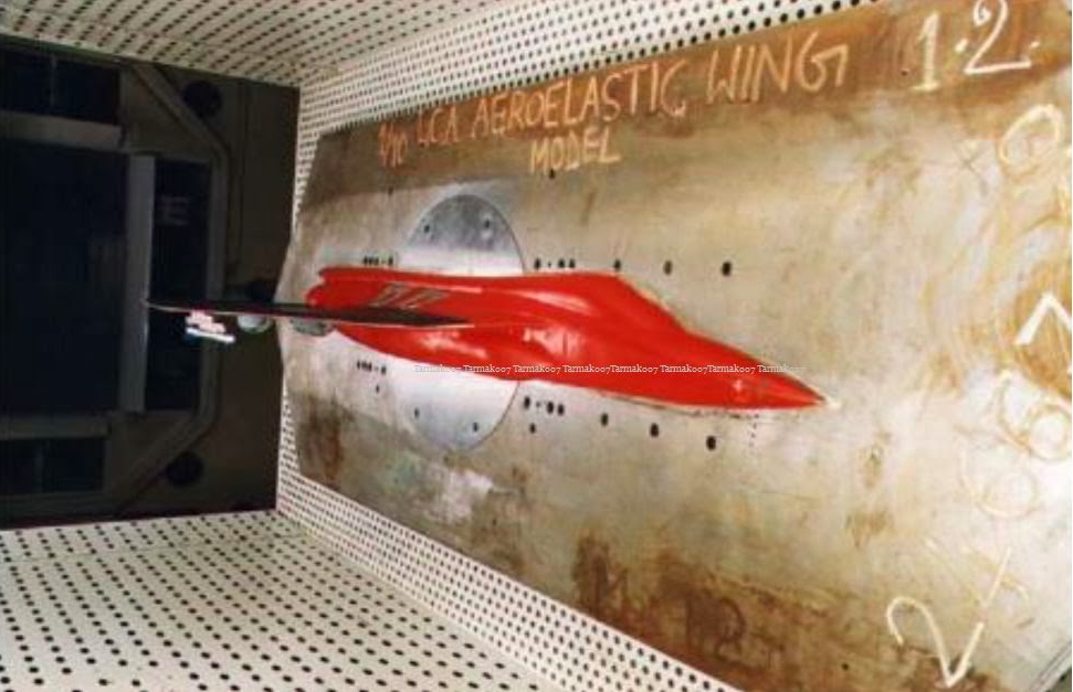

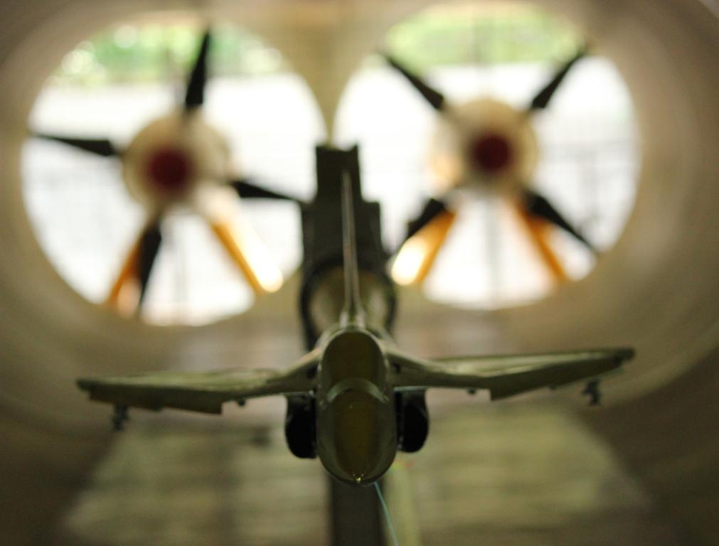

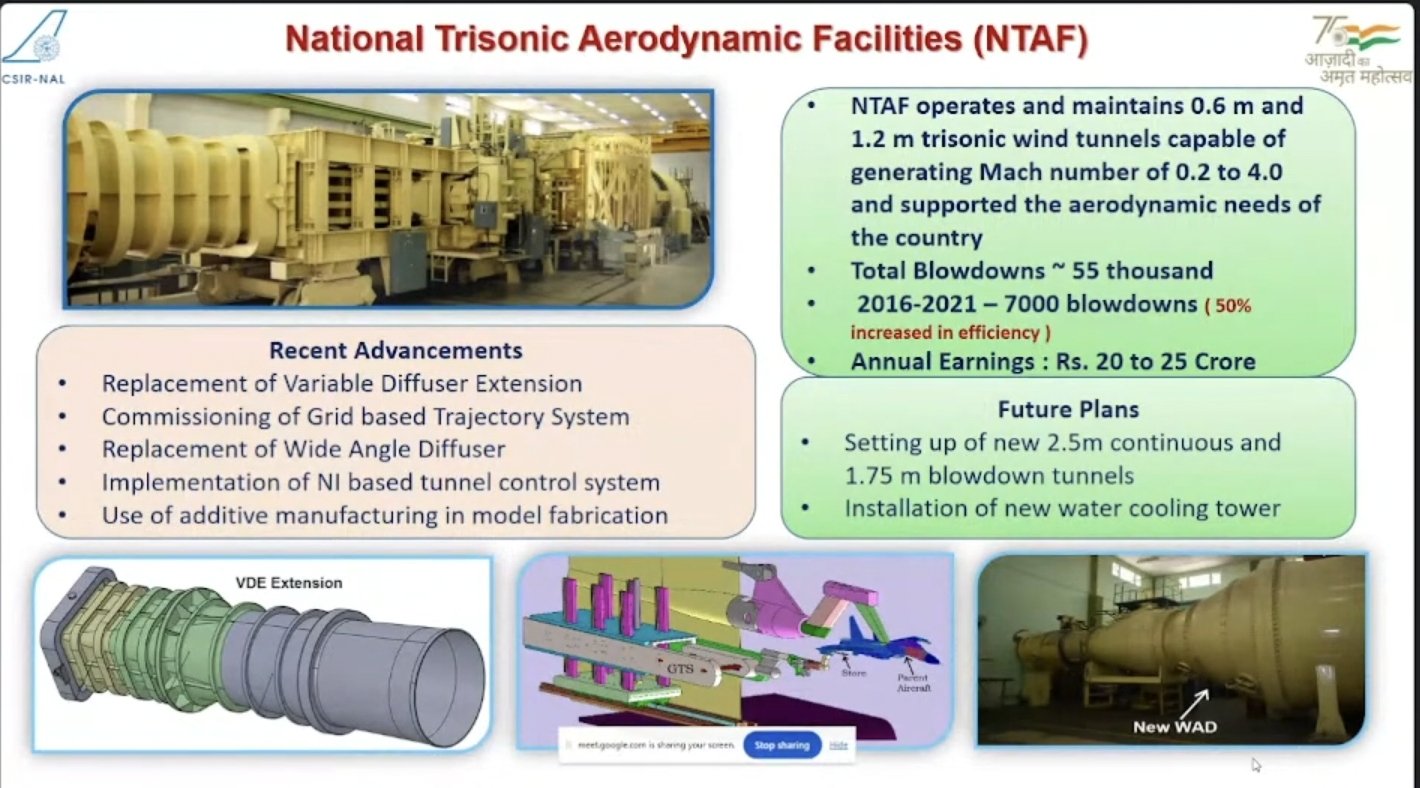

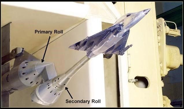

There are extensive trisonic wind tunnel facilities in India, specifically under CSIR-NAL where both Tejas & AMCA models were tested. Along with foreign aircraft models that were later modified to carry Indian stores/weapons:
And then there are larger open-circuit facilities at places like IISc where certain configurations are also tested:
What's probably lacking is perhaps a larger lower-speed facility, I'm not aware of what the plan is in that department - per what I've heard there are areas where they expect computation to nullify some of the needs. I have also heard of a new, larger Continuous-flow Trisonic Wind Tunnel (CTWT) under construction though. @Nilgiri is much more informed than me in these aerospace matters.

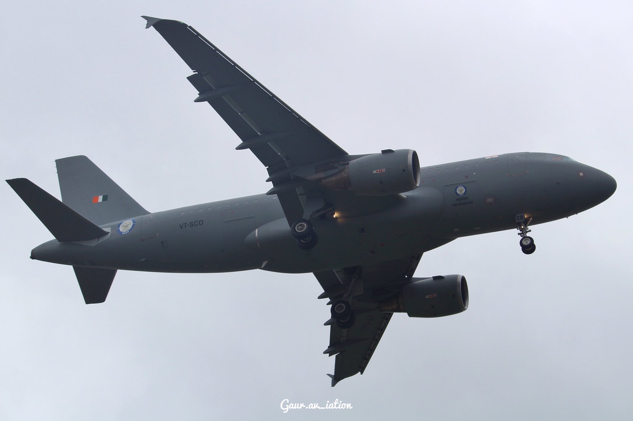

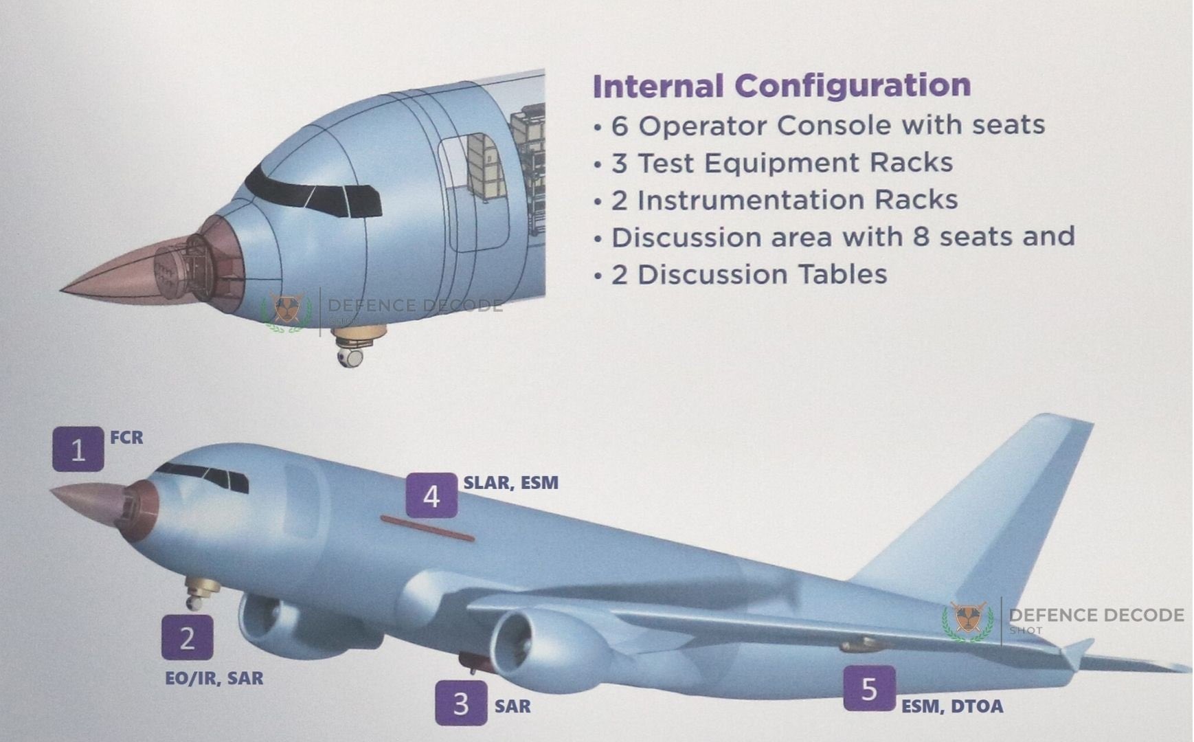

AMCA's avionics FTB aircraft (Airbus A319 platform) has already been procured and is probably being modified as we speak:

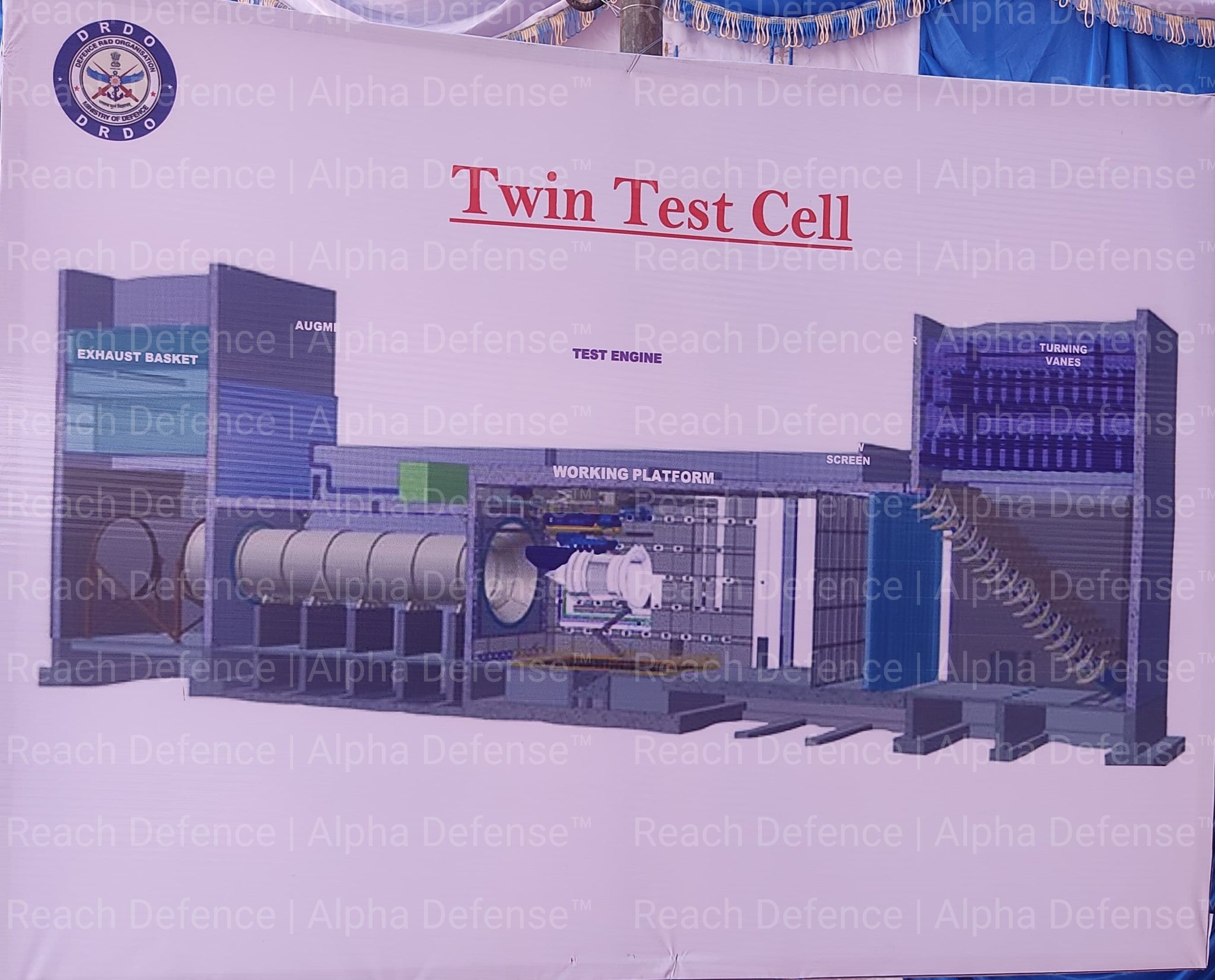

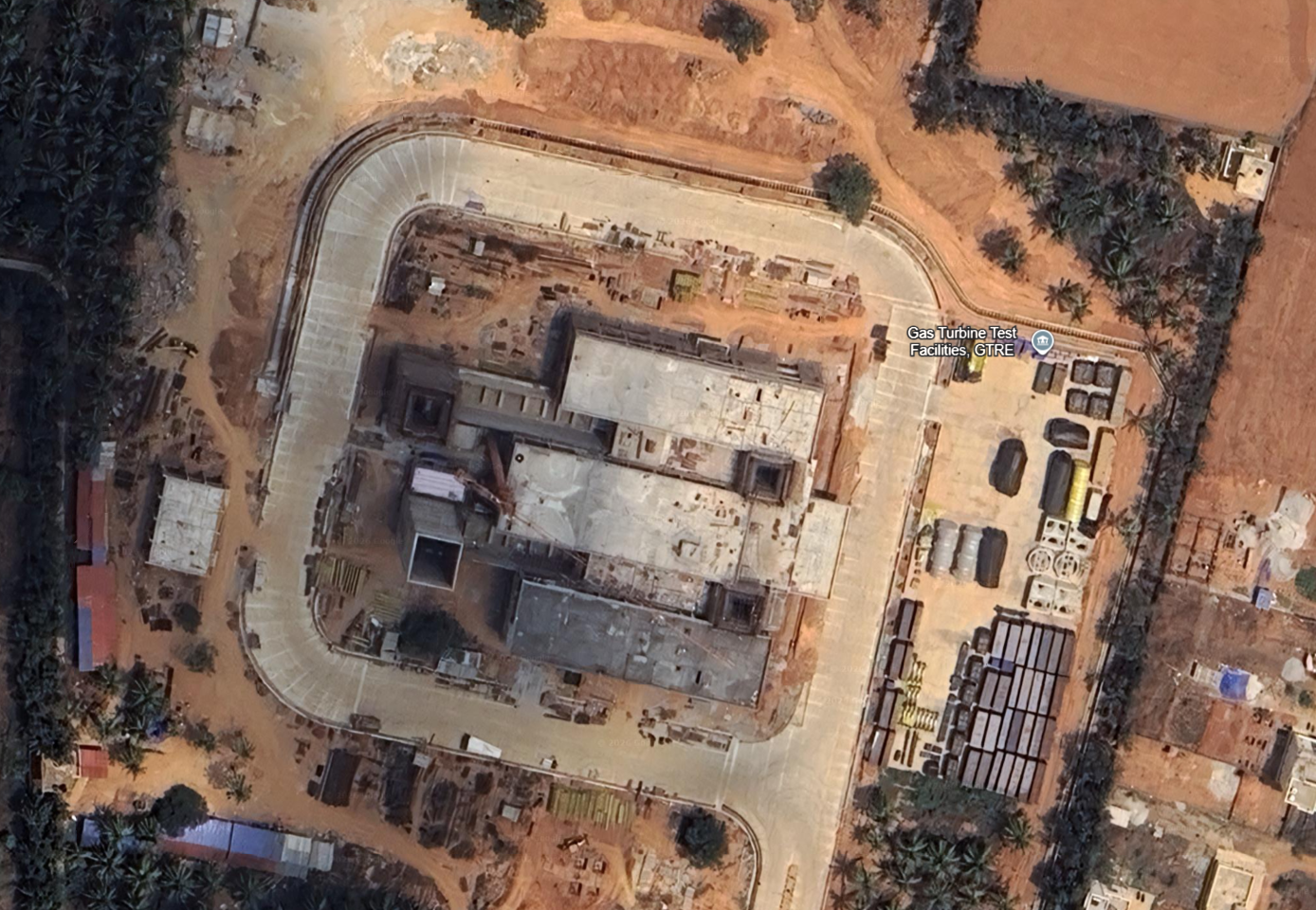

Engines are a separate program and will require their own infrastructure. I'm aware of a new 130 kN-class Twin Test Cell of the GTRE that's coming up though:
The upcoming JV engine to be developed with SAFRAN will likely be tested here^^.

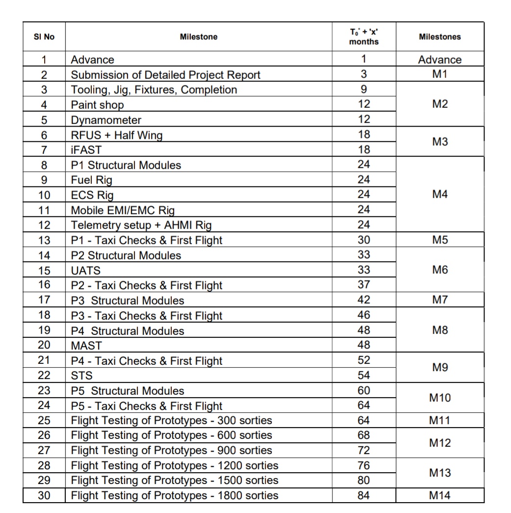

On the requirement that first flight is to be 30 months from signing a contract for prototype building - can that realistically be done? I don't see it but I hope to be proved wrong.
As the tweet says, only the project report submission, getting the jigs & fixtures ready, flight of the 4th prototype & finally completion of 1800 sorties are mandatory deadlines (failing to meet which will result in penalties). The rest of the deadlines (including the 30-month one for 1st prototype's flight) is indicative, meaning there's scope for it to shift around.
I expect the execution by Private-sector companies like TASL, L&T or BFL to be much better than HAL though. Most of HAL's programs get delayed due to funding approvals, which require Govt authorization beyond a certain level. That can be a bureaucratic nightmare.
