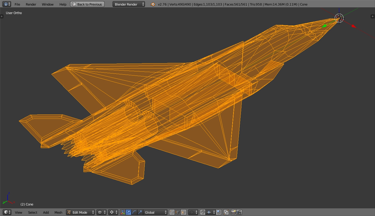

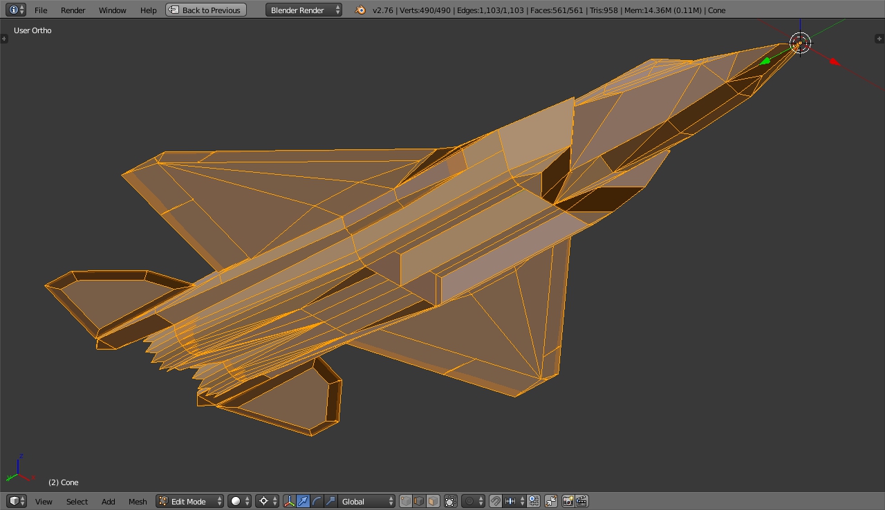

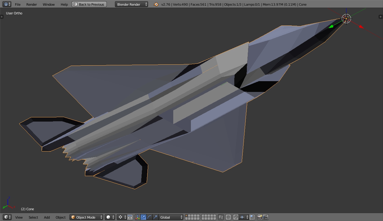

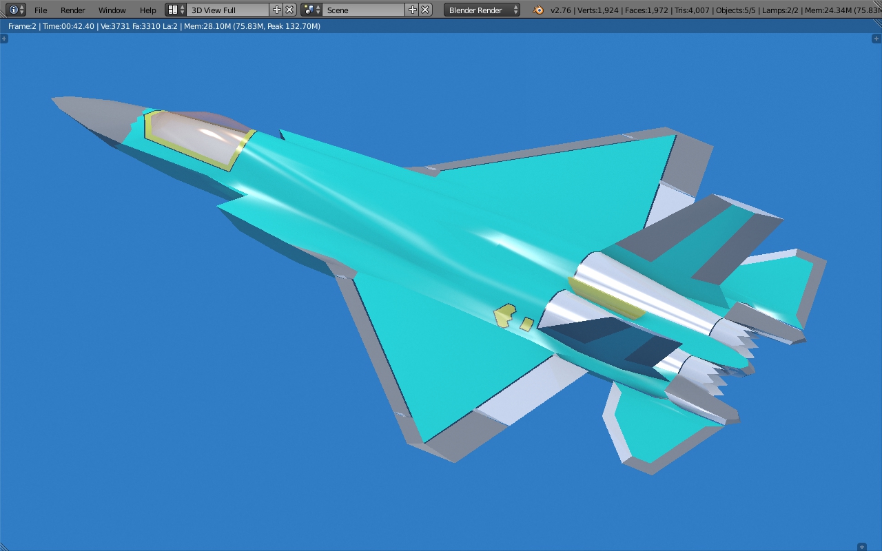

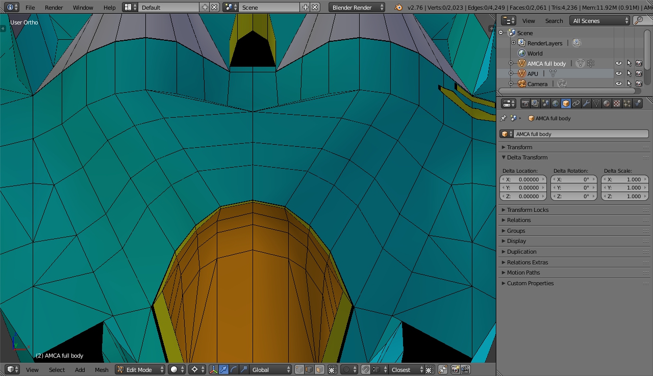

CAD work in progress.
Only surface outline so far based on drawings.
At certain places like dorsal/upper curves, it's difficult to match exact contours from low res drawings, & 3D views.
Keeping low count of vertices, edges, polygons on old laptop.
I've removed some diagonal edges of low bending quadrilaterals where we don't need a crease, Blender displays them smooth enough.
Many small features are remaining like landing gear doors, sensors, etc.
Considering engine exhaust diameter = 90cm, the max dia. of F414.
AMCA Blender, 29 July'26, edit  mode, wire-frame, all selected, front right low angle.jpg
AMCA Blender, 29 July'26, edit mode, solid, all secleted, front right low angle.jpg

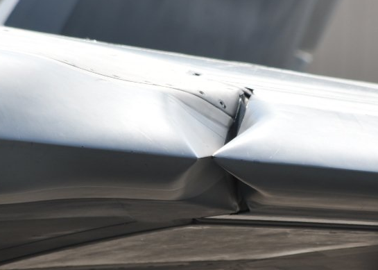

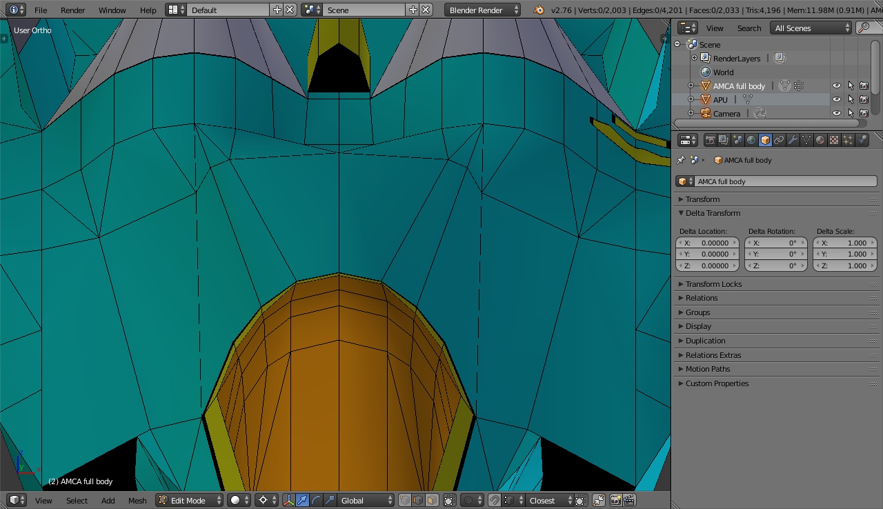

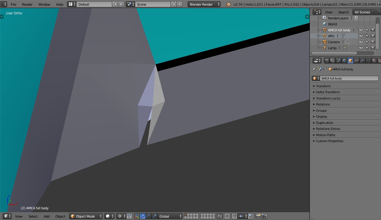

The gaps between control surfaces & body have to be angled, otherwise vertical side becomes side reflector.
The following is example of F-22's slat's gap with wing root -
AMCA Static models focus on broad outline & have not shown the feature yet, but the real jet would apparently have it.
AMCA Blender, 6 Aug'26, gap between slats & wing root, object mode, solid view, front angle.jpg
AMCA Blender, 6 Aug'26, gap between slats & wing root, object mode, solid view, front top angle.jpg

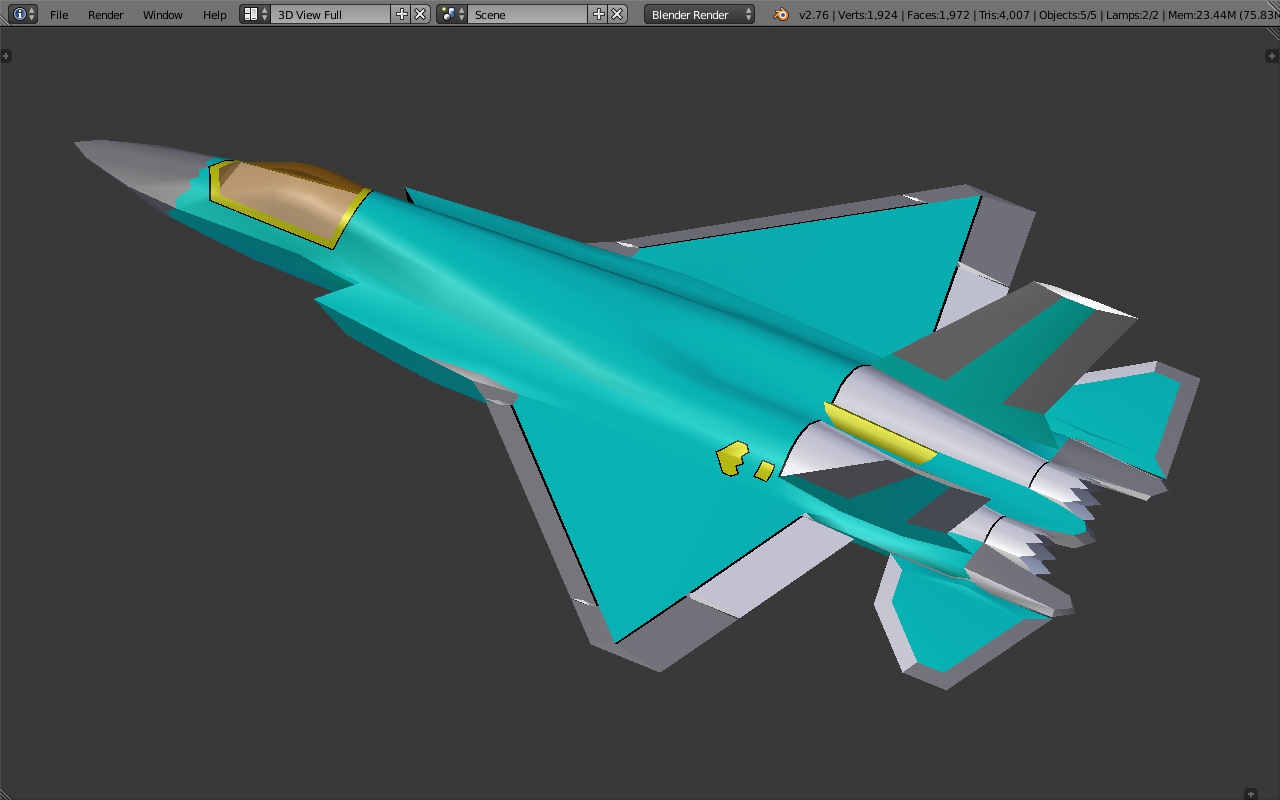

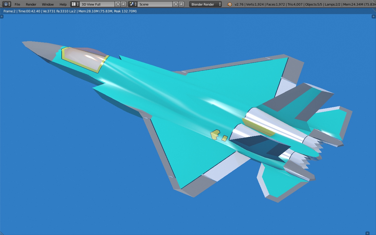

Basic CAD model outline of AMCA is ready.
Solid & rendered views in green primer, stealthy tinted canopy.
Cockpit is empty, needs time to model small area with right measurements.
Full surface features remaining, will model 1 by 1.
Started with F-22 model but AMCA got ahead so far.
Fortunately my old laptop didn't crash or hang bcoz Blender's old versions also work sufficiently well for discussion purpose. No GPU needed, just 100-150 MB RAM with Core-2 Duo CPU.
I'll be tweaking this basic CAD as per my comprehension, but i wanted 1st to make a model closest to used in official infographics, so that we can discuss what improvements can be made with minimum modifications, like FOC & MLU.
AMCA Blender, 10 aug'26, object mode, solid view, left side, rear elevated angle,1280x800p.jpg
AMCA Blender, 10 aug'26, object mode, rendered view, left side, elevated angle, 1280x800p.jpg

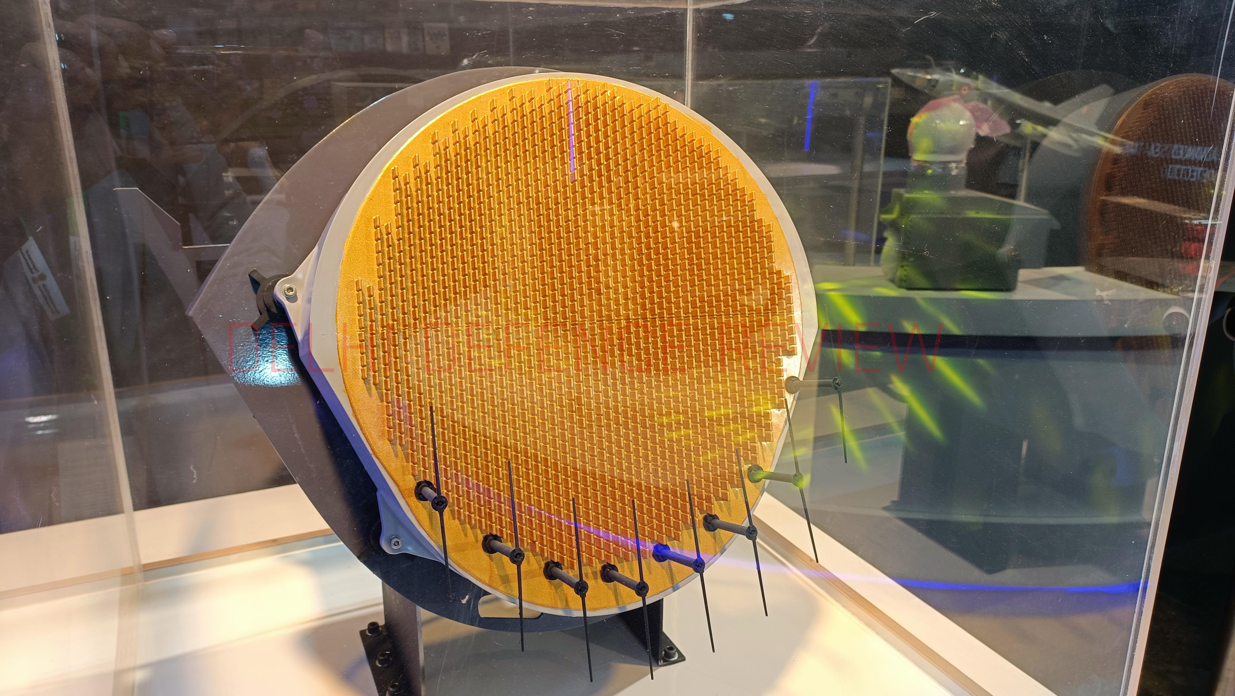

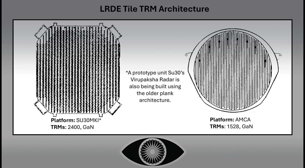

@Gessler do you know if this rendering of AMCA radar is accurate? 1528 TRM.
Gessler
India Moderator
1,208
89 2,847
It roughly gels with the number counted by someone on the 1:2 model shown at last year's Aero India (1,536). I posted about that in another thread back then:
Some other counters gave slightly different numbers, but all are in the ~1550 ballpark give or take a couple dozen. So yeah you can consider it accurate. And yes, it's meant for AMCA.
Though I'm not sure why the IFF dipoles have switched to the top of the array instead of the bottom in that chart.
5,149
104 10,079

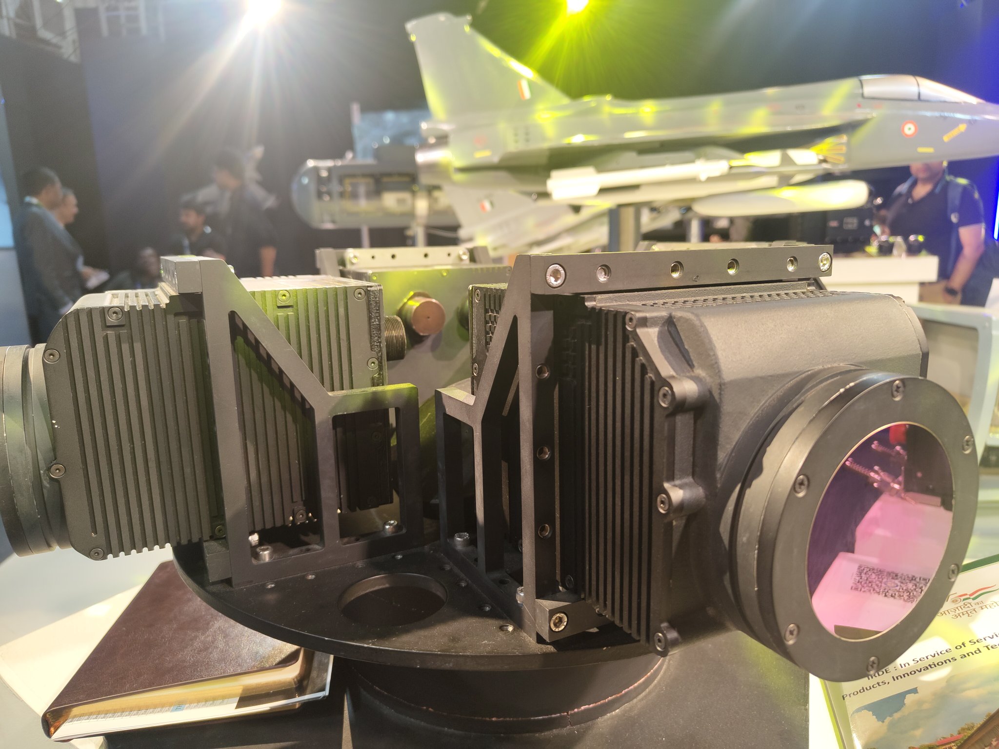

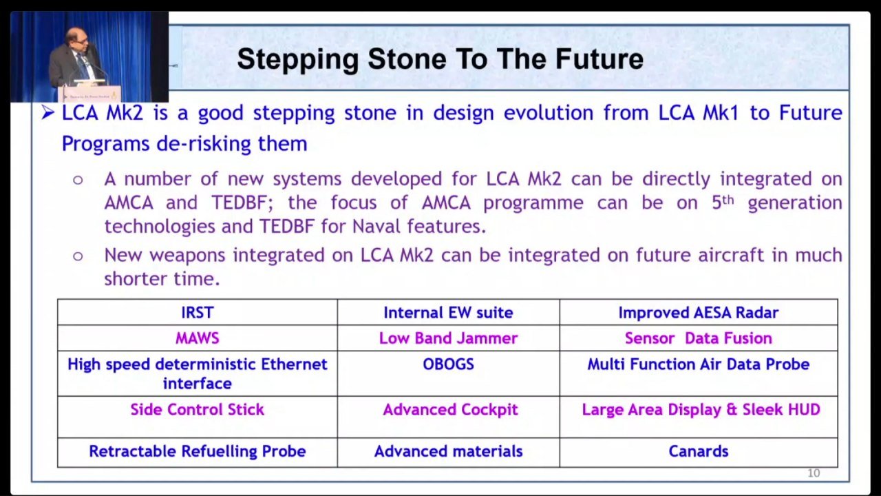

Bro, is there anything on AMCA's EOTS and DAS/MAWS?
I haven't seen any mock-ups on those.
Gessler
India Moderator
1,208
89 2,847

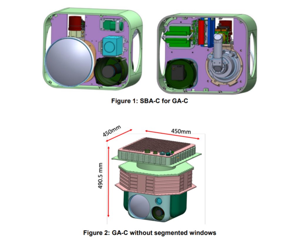

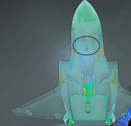

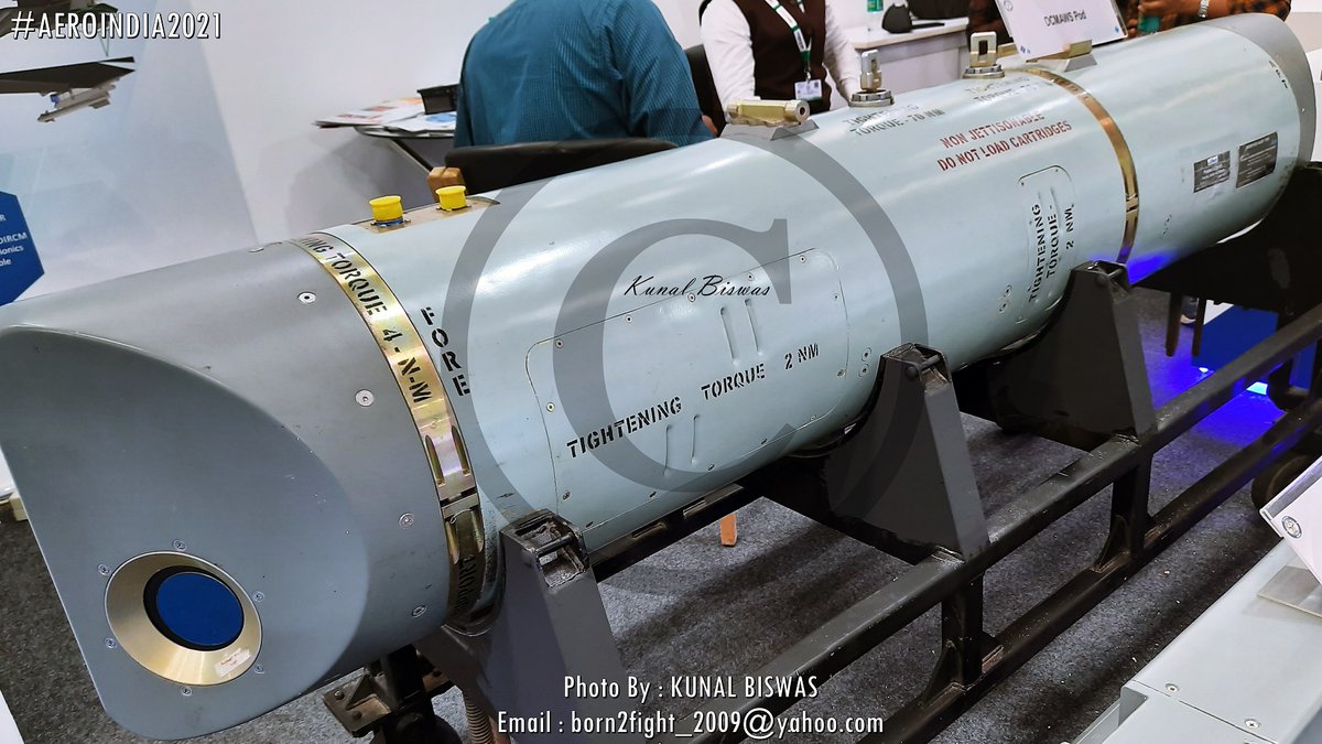

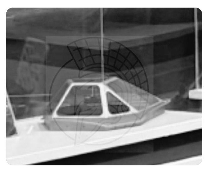

I don't think AMCA Mk-1 will get an EOTS. The fact that models of the plane in beast mode always show it with external LDP supports that thesis. But all latest official graphics of AMCA (assuming they're showing the version after systems-level CDR was completed) show an optical sensor of some kind at the chin station (where F-35 has its EOTS):

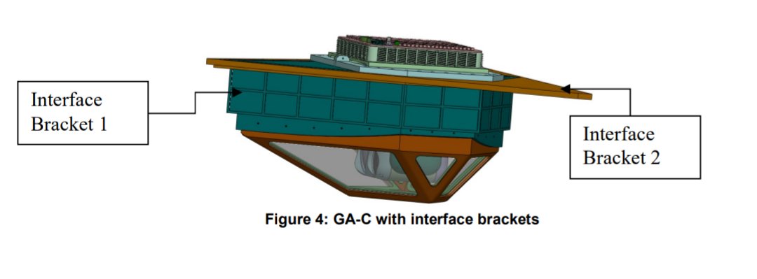

There is a known development program for a sensor called GA-C/GA-R (R is 'Retractable' version while C has segmented-windows like F-35 EOTS). There's nothing to say if this is the sensor being shown on AMCA but I'm convinced it is. This housing has no laser emitter or laser spot-tracker in it though, just an IR camera & visible camera. So essential it's an EO/IR assembly performing functions similar to Rafale's FSO (sans LRF), except both sensors are combined into a single housing, and mounted upside down. So not a true EOTS due to lack of laser-targeting capabilities:
A private contractor had displayed a segmented-window assembly (probably made for this contract) at last Aero India, though they call it an 'EOTS' window:
All-aspect stealth is a requirement for AMCA program, so eventually they'll have to get rid of the external LDP for A2G missions. Probably will be achieved by AMCA Mk-2. I don't know why they aren't doing it on the Mk-1 itself, maybe the tech isn't ready or maybe it's a power limitation.
As of DAS, work on an engineering prototype to prove the sensor-fusion software started in 2024, I made a post on it before:
We don't know yet what the DAS sensors themselves will be like at this point (at least for AMCA Mk-1). Same DC-MAWS as Tejas Mk-2 or a next-gen system? There's two known versions: DAS-DB (Dual-band) & DAS-HD (HighDef). I believe these comprise the next-gen DAS system whereas AMCA Mk-1 might just get the DC-MAWS. The DC-MAWS are already made keeping in mind sensor fusion as the Tejas Mk-2 itself comes with a high-bandwidth ethernet-based avionics/TSN architecture:

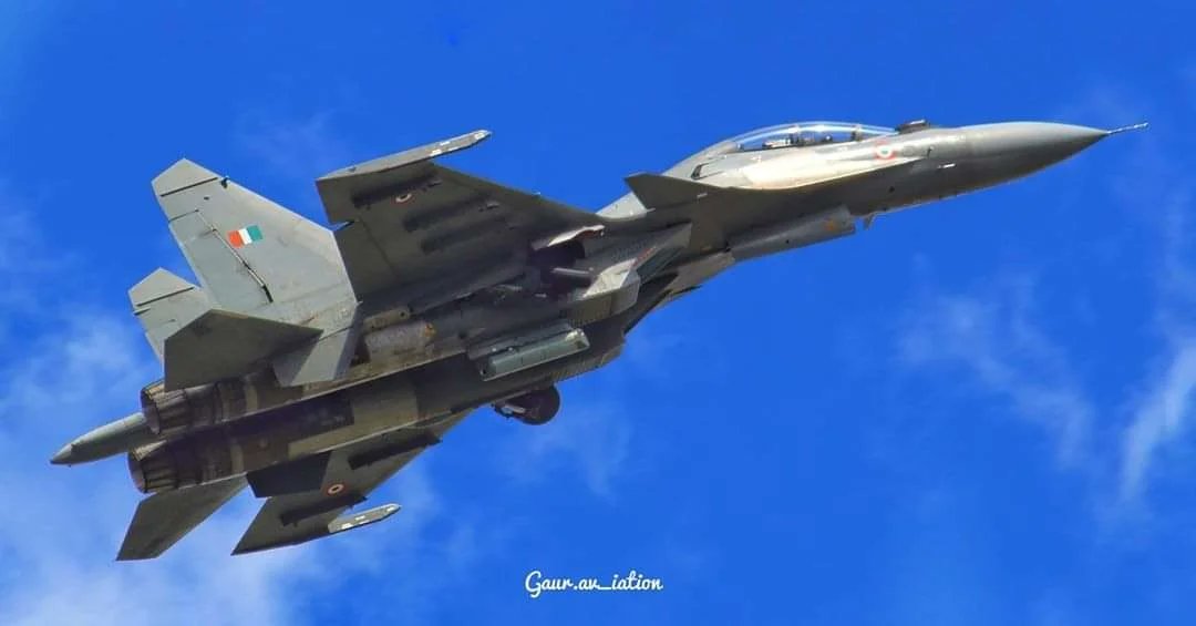

The Tejas Mk-2's MAWS are essentially ready hardware-wise:
The system in a pod-based version has been flying on MKI for a while now:

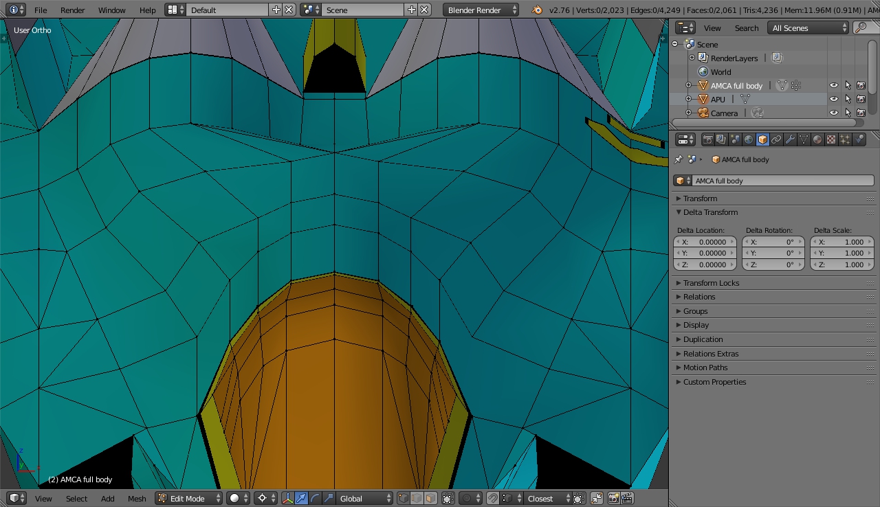

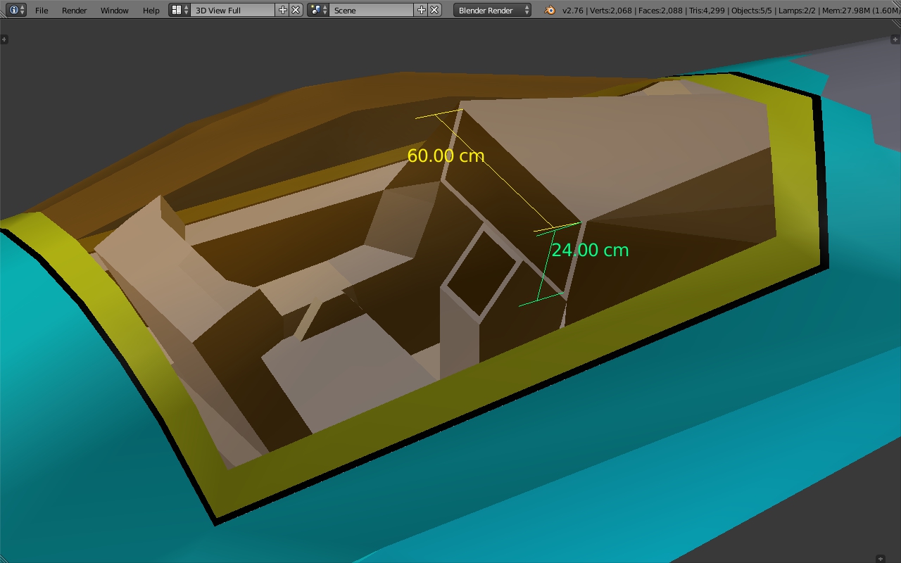

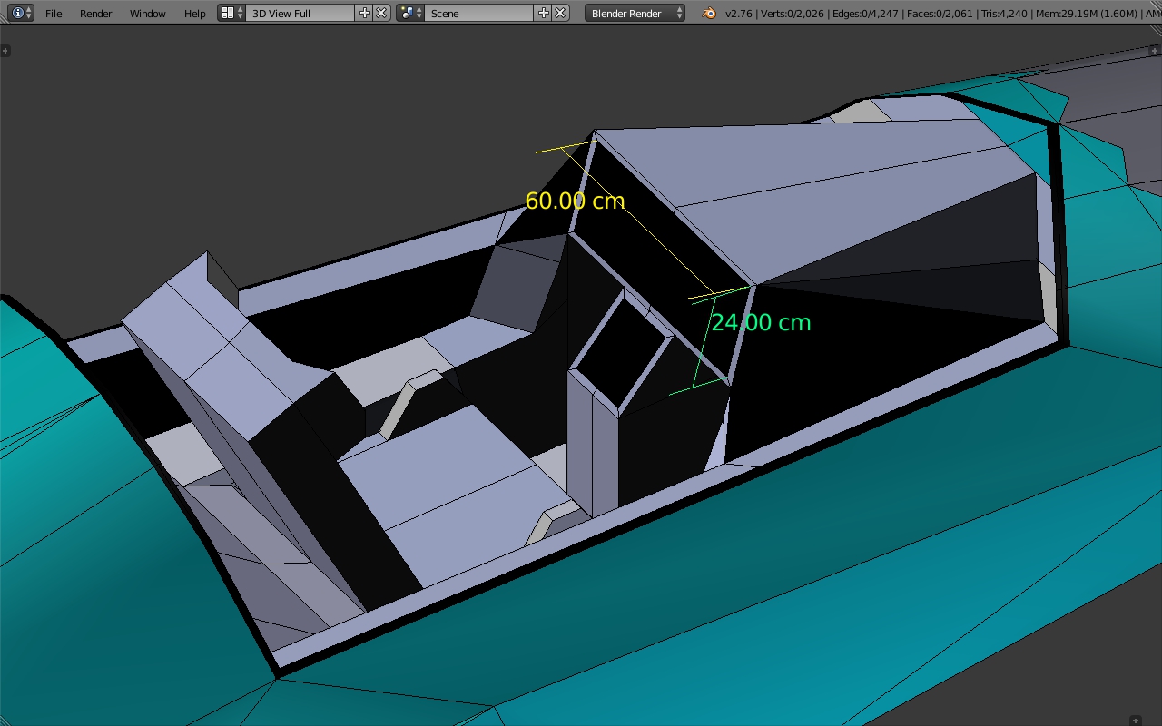

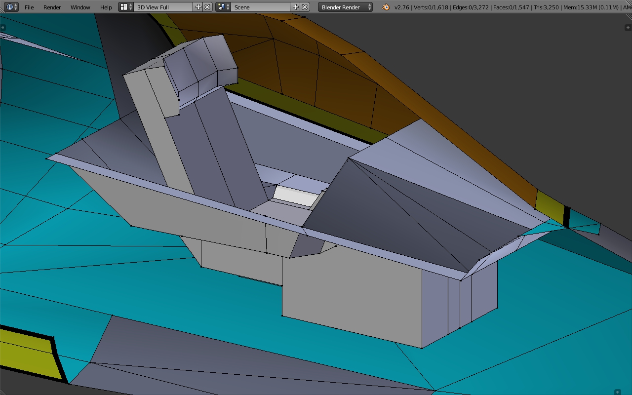

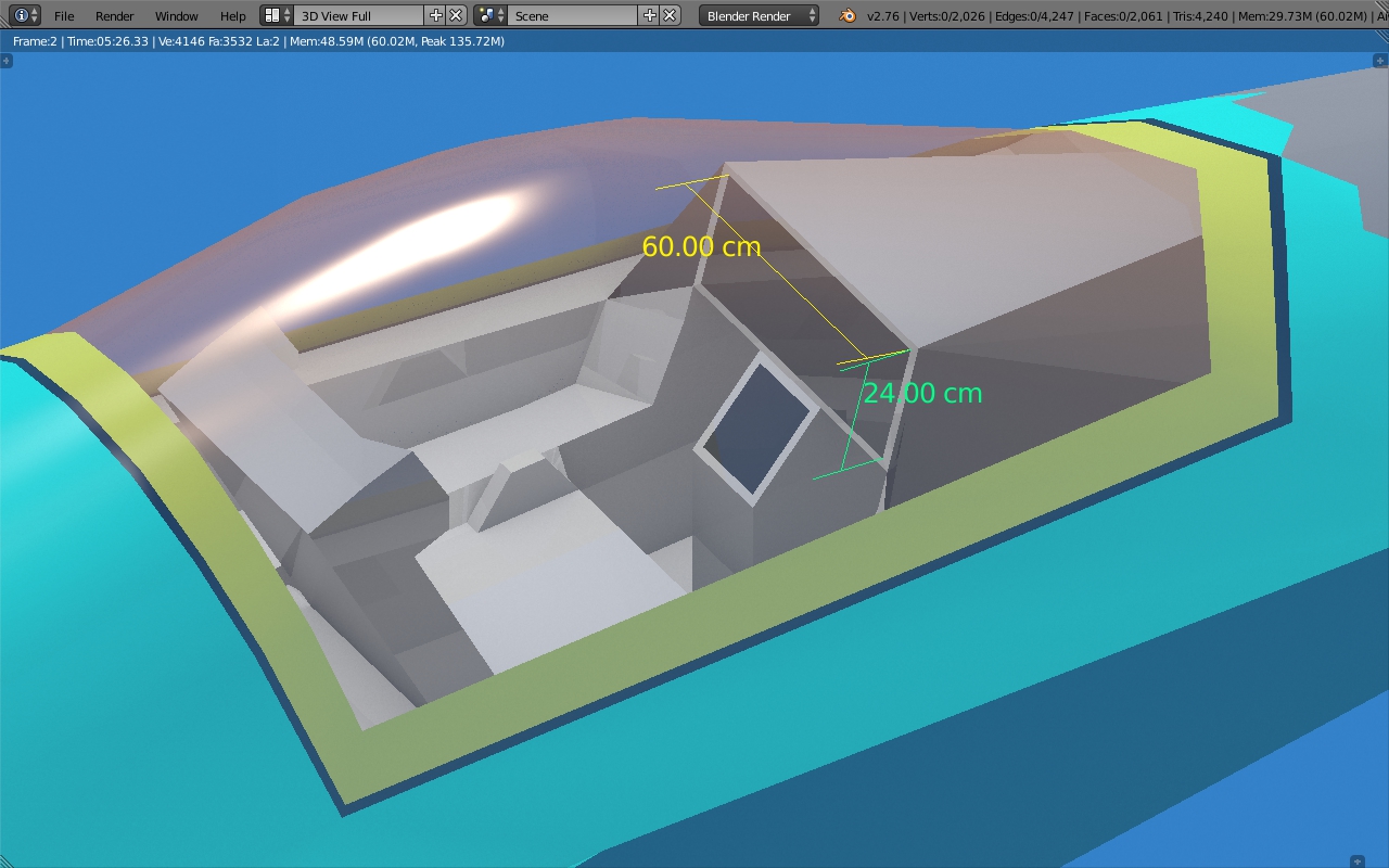

Initial outline of notional cockpit.
1 piece canopy w/o arc.
HMDS instead of HUD.
60 x 24 cms TV, i mean MFD.
From F-22 to F-35, we notice many hard switches, buttons, dials, knobs have been offloaded to MFD & HMDS.
AMCA. blender, 12 aug'26, notional cockpit outline, Edit mode, Solid view, right side rear ele...jpg
AMCA. blender, 12 aug'26, notional cockpit outline, Object mode, Solid view, right side rear e...jpg
AMCA. blender, 12 aug'26, notional cockpit outline, Object mode, Rendered view, right side rea...jpg

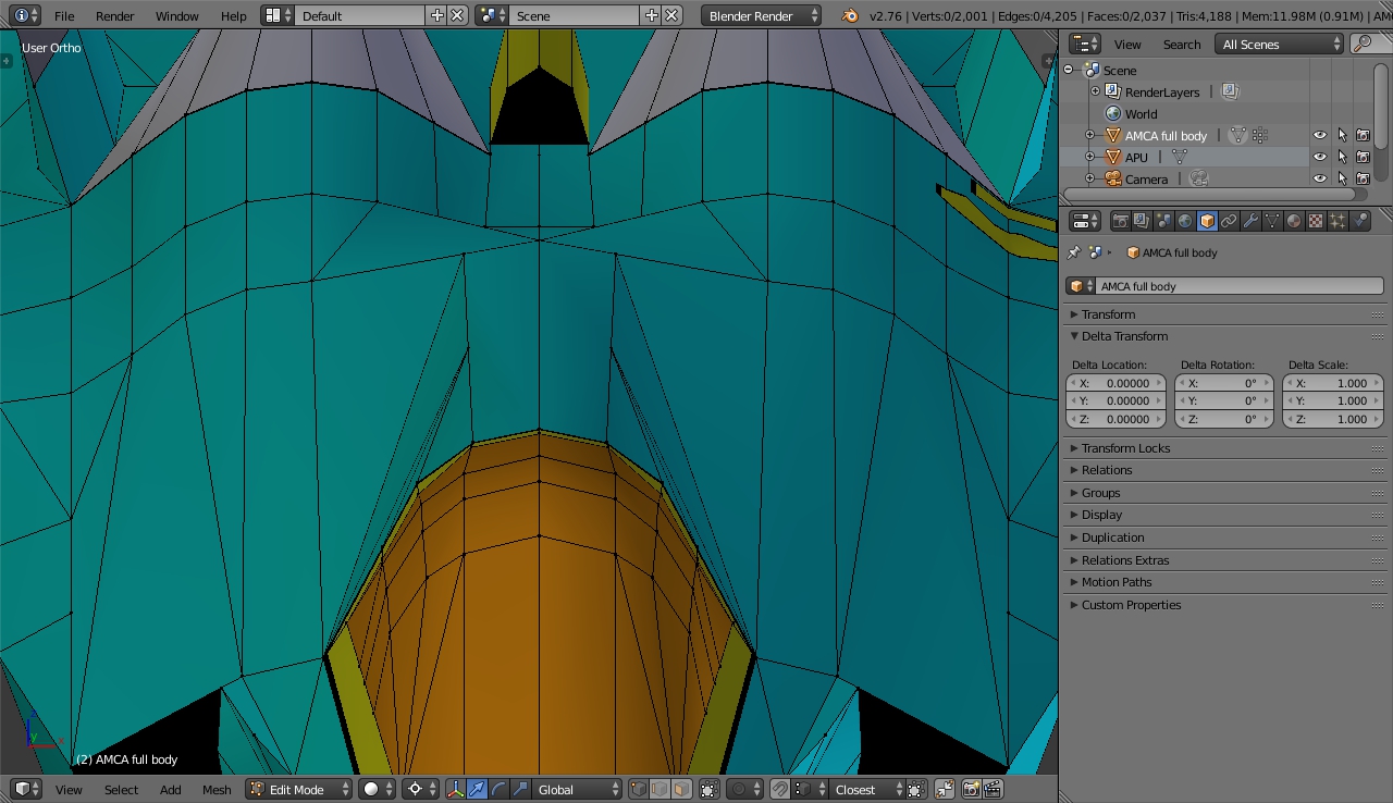

Different static models & CADs have shown minor differences in fuselage shaping & features.
I wonder which forward & mid fuselage blending contour style is best balance b/w aerodynamics, stealth, needed space.
This will affect components like S-duct, fuel tanks, sensors, etc.
I guess i'll have to make the S-Duct 1st & see if it gets out of any contour boundary.
Then decide the contour, then place the surface sensors & features.

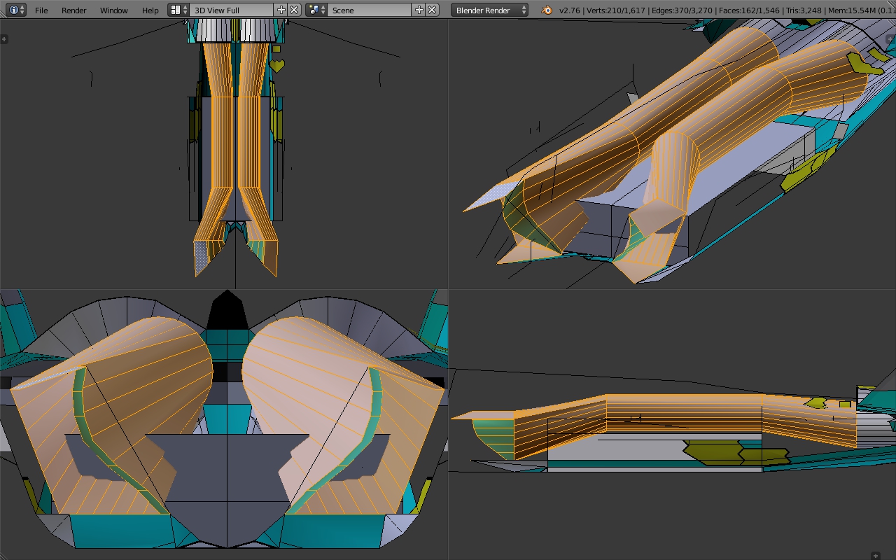

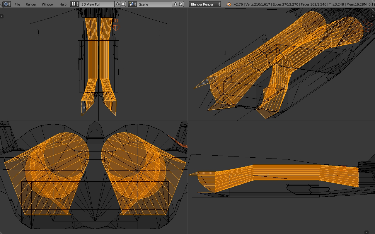

Theoretical straight segments diverging S-Duct.
Engine face not visible through corner of DSI intake for stealth.
Duct cuts through IWB's front upper part.
Theoretically, space for SWB also available but in a medium class jet perhaps that's needed for sufficient internal fuel & equipment. Later i'll check CAD body volume & compare with other jets.
AMCA Blender, 24 aug'26, theoretical straight sections S-duct, quad view, Edit mode, wireframe...jpg
AMCA Blender, 24 aug'26, theoretical straight sections S-duct, quad view, Edit mode, Solid vie...jpg

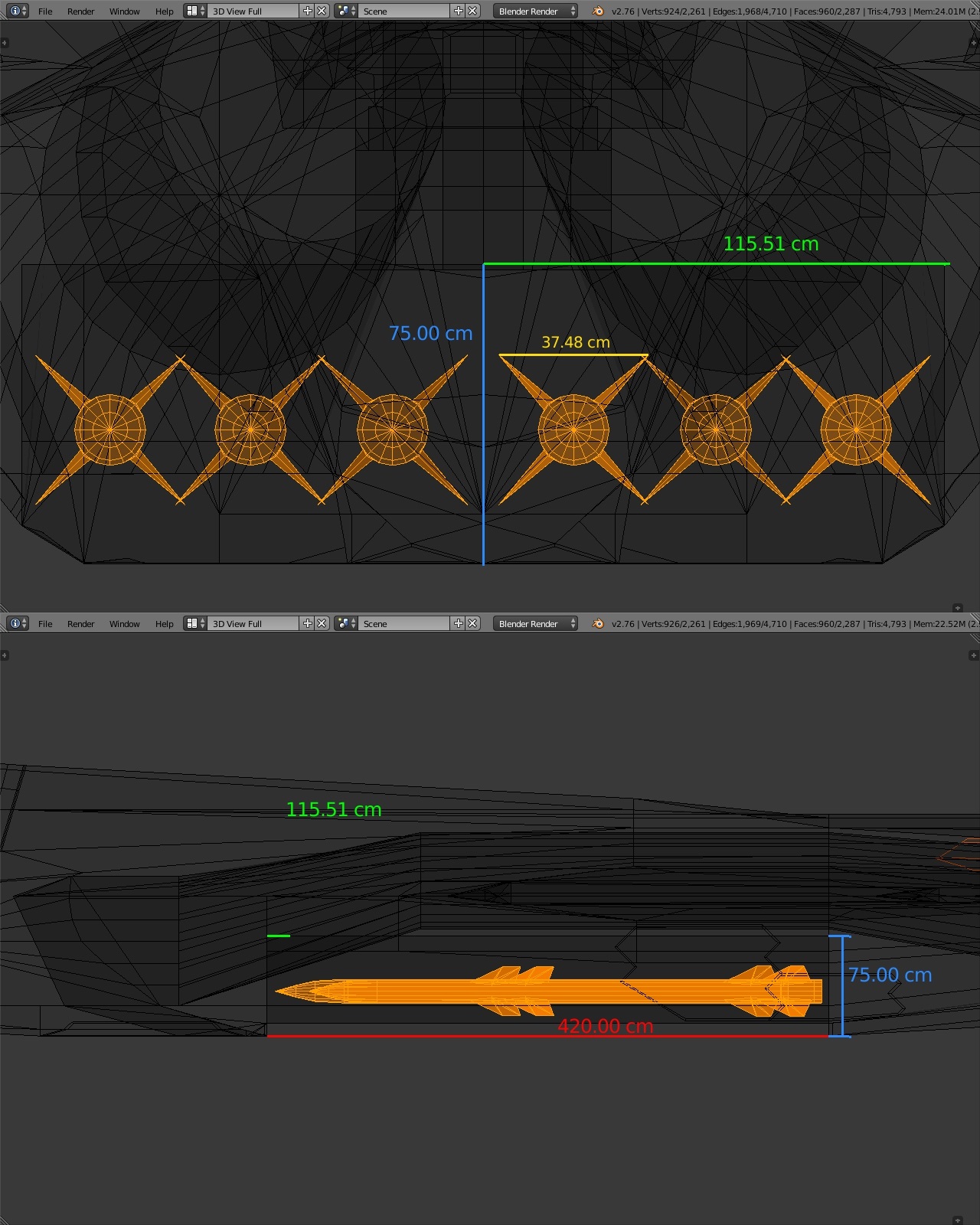

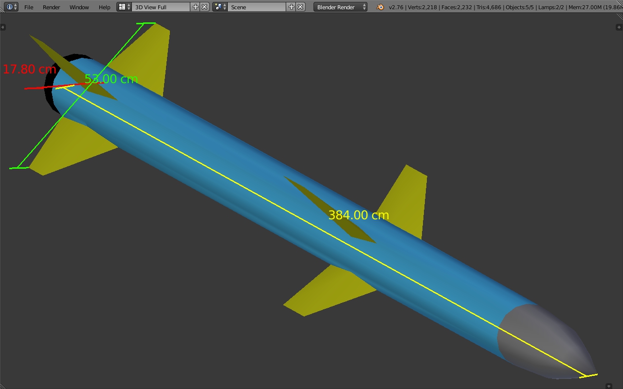

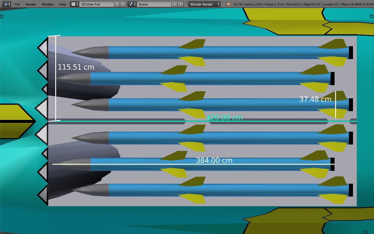

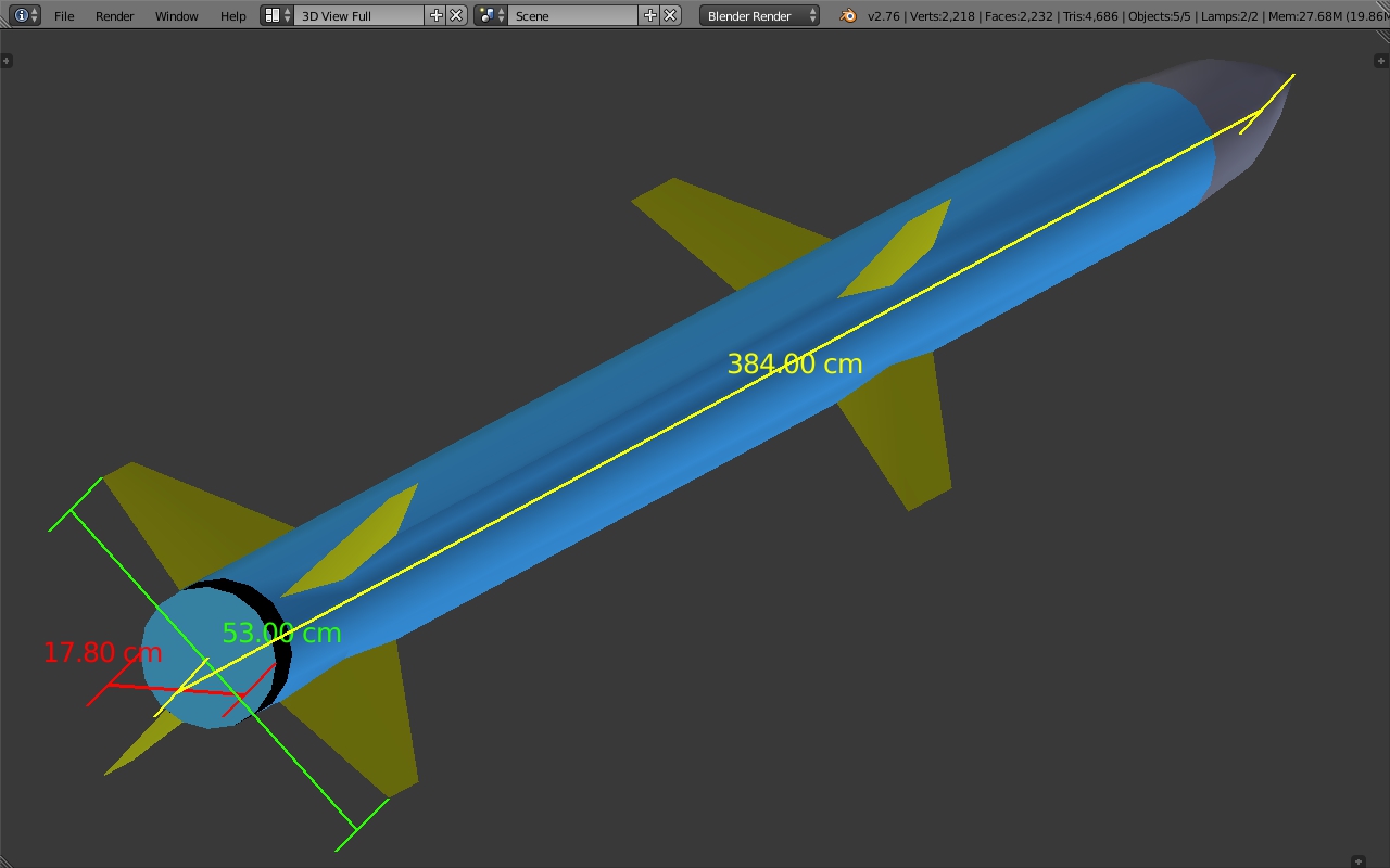

If AMCA's IWB can be widened & Astr-2 AAMs staggered then similar to F-22, 6 Astr-2 AAMs can fit.
In A-G only mode, it may allow total 16 SAAW bombs.
Damn! almost 2 years passed so fast. I wish i searched for Blender's old version many years back.
Anyways, considering notional Astr-2 short-fin AAM length = 3.84 m, diameter = 178 mm, fin-span = 530 cm.
IWB length = 4.2 m, depth = 0.75 m max, width = 2.3 m.
The IWB cannot be perfectly cuboid, but dynamic as per all the weapons needed & equipment around it.
AMCA Blender, 31 aug'26, Astr-2 short-fin AAM, Object mode, Solid view, rear right elevated an...jpg
AMCA Blender, 1 sep'26, Astr-2 short-fin AAM, Object mode, Solid view,front right elevated angle.jpg
AMCA Blender, 1 sep'26, 6x staggered Astr-2 short-fin AAMs in IWB, Edit mode,Wireframe view, A...jpg
AMCA Blender, 1 sep'26, 6x staggered Astr-2 short-fin AAMs in AMCA's IWB,Object  mode, Solid v...jpg
