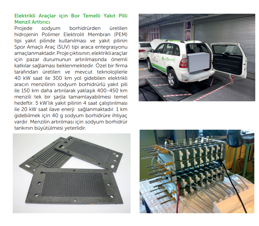

Boron Based Fuel Cell Range Extender for Electric Vehicles
In the project, it is aimed to use hydrogen produced from sodium borohydride in Polymer Electrolyte Membrane (PEM) type fuel cell and to integrate the fuel cell into Sports Purpose Vehicle (SUV) type vehicle. The output of the project is expected to contribute significantly to increasing the market situation for electric vehicles. The main goal of the electric vehicle, which is produced by a private company and can travel 300 km to 40 kWh with current technologies, is to be able to complete a range of approximately 400-450 km with a single charge by increasing the range of the electric vehicle with sodium borohydride fuel cell by 150 km. Operating a 5 kW fuel cell for 4 hours provides 20 kW of additional energy. 40 g of sodium borohydride is needed to travel 1 km. Sodium borohydride to increase the range It is sufficient to enlarge the tank.
