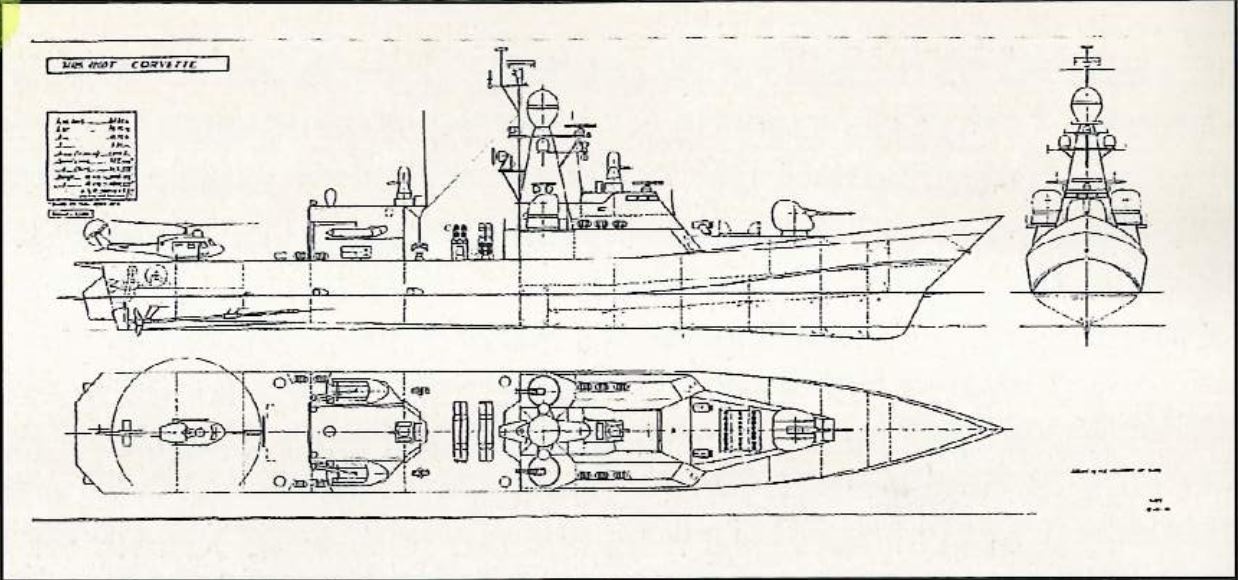

The first sketch of Milgem was made by Erbil Serter at the request of the Admiral and abandoned after his retirement in the following years:
1200 tons, 80~metres and 3.5~draught. 8 SSM missiles and 1 Phalanx CIWS, 2 small calibre autocannons (in role of RWS) in addition to VLS which appears to be Sea Captor, note that the ship lacks hull mounted sonar and relies on towed variable depth sonar. TN requirements were similar at the time, a hangar for 6+ ton helicopters, 2 RHIBs.

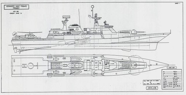

Another design, also 1200 tonnes, was offered as an alternative, with a sea zenith instead of a phalanx, this project was also offered by TKMS as a MEKO 90.
However, one could sense that the following design was also offered as a more capable Light Frigate Corvette in a different role, the VLS configuration was deliberately exaggerated to show capabilities, and some of these (the aft) were bound to be replaced by CIWS.

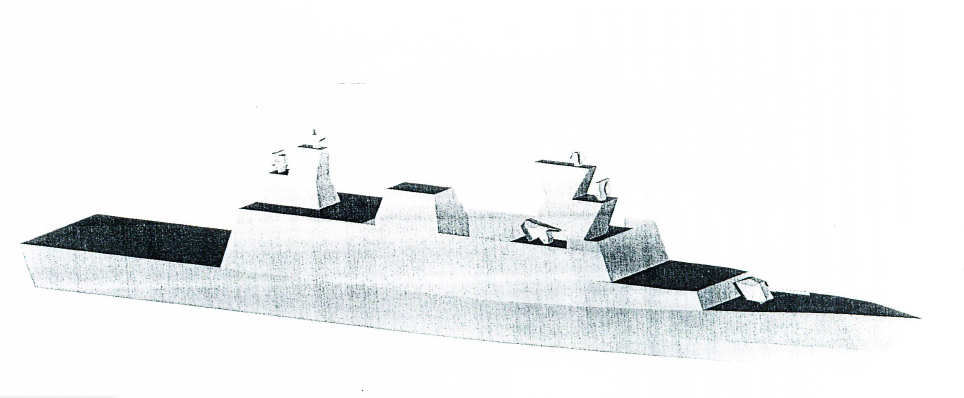

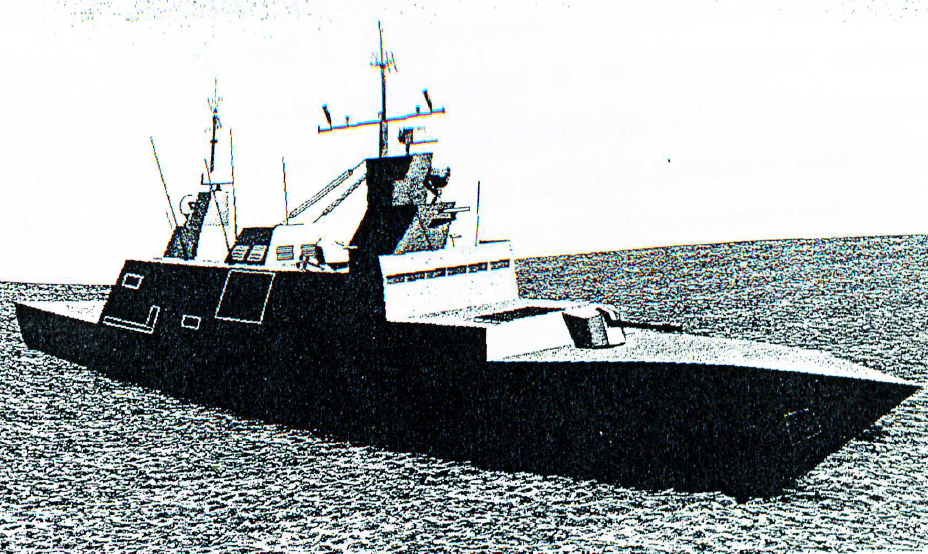

Also, in addition to previous designs, the following one might have been proposed and designed by another team led by Yücel Odabaşı, where one can sense La Fayette inspirations for the low-RCS design:
This particular image shows the radar reflecting parts for RCS analysis.
The newer design had VLS, probably Sea Sparrow, and no CIWS - probably in place of RWS or dual purpose guns. However, this particular design may be a temporary form.

Milgem project quasi-officially was launched in Mid 80's amid raising thoughts of having a corvette in Turkish Naval forces, following the upcoming and foreseeable trend of smaller and effective surface assets capable of more firepower with the advanced technology.
The first sketch of Milgem was made by Erbil Serter by request of the Admiral, and abandoned upon retirement of him in following years:
1200 tonnes, 80~meters and 3.5~draught. 8 SSM missiles and 1 Phalanx CIWS, 2 small caliber auto-cannons (in role of RWS) in addition to VLS which seems to be Sea Captor , note that the ship lacks a hull mounted sonar and relies on variable depth towed sonar. Requirement of TN was similar back then, a hangar for 6+ tonnes helicopters, 2 RHIB
A different design, again 1200 tonnes, was offered alternatively, sea zenith instead of phalanx, this project was also offered as MEKO 90 by TKMS.
However, one might sense the following design was also offered as a more capable Light Frigate- Corvette in a different role, the VLS configuration was exaggarated purposedly to show capabilities, and some of these were (the aft) was bound to be replaced with CIWS.

Also, in addition to previous designs, the following one might have been proposed and designed by a different team in lead of Yücel Odabaşı:
This particular image represents the radar-reflecting parts for RCS analysis.
The newer design had VLS, probably Sea Sparrow and No CIWS - probably in place of RWS or dual purpose guns were intended. However, this particular design can be temporary form.

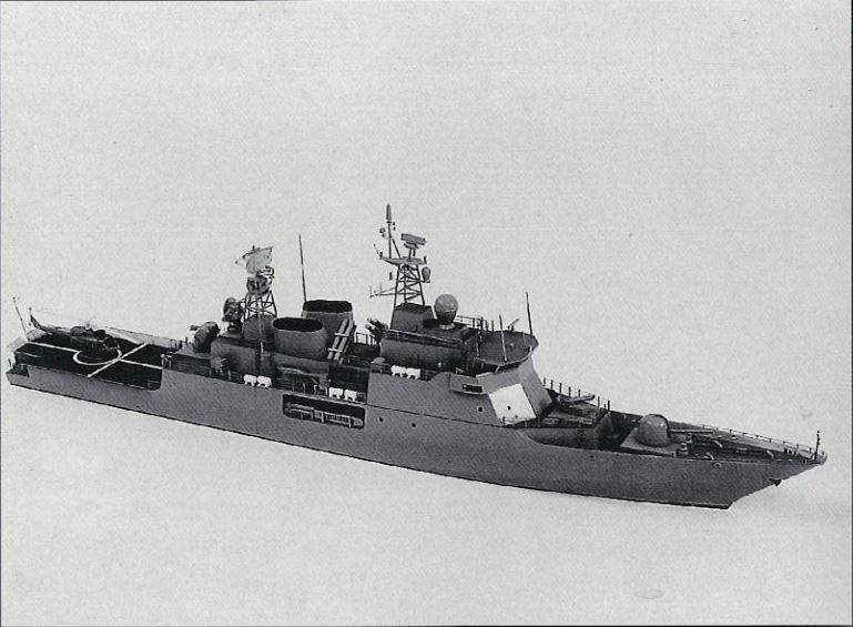

I like the 6th one, very similar to a K130
In earlier designs, the Ada class had a slender mast and V-shaped bow, later replaced by a blunt mast to support the EW suite, and a bulbous bow was added to increase speed and hydrodynamic efficiency.
Image reference : https://www.siyahgribeyaz.com/ for one image (orko_8 had it on another blog a long time ago, I had saved it then and can no longer access the blog.)
Source of the first image is unknown.
