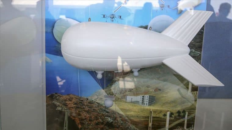

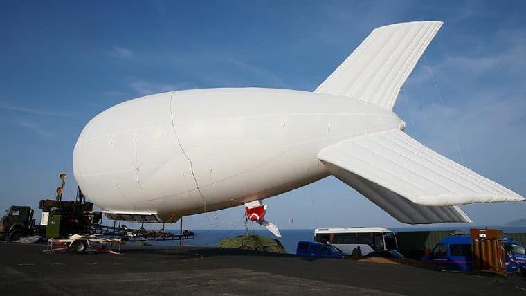

Another development worth mentioning is the Karagoz System.
This is a Zeplin type balloon that is placed about 500m high and tethered to the ground with cable connection to the balloon’s electronic systems. it’s main job is to look out for aerial threats and pass it to ground units.
In a battle ground like Libya where the geography is flat, it is necessary to implement equipment such as Karagoz.
For ground based radar systems and air defence systems Karagoz would be priceless.
114 19,730

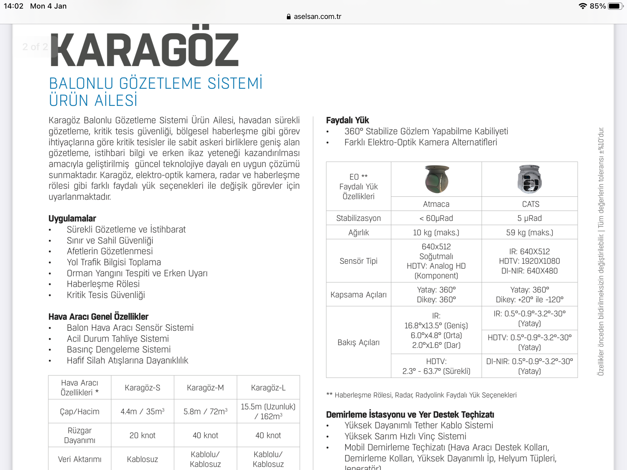

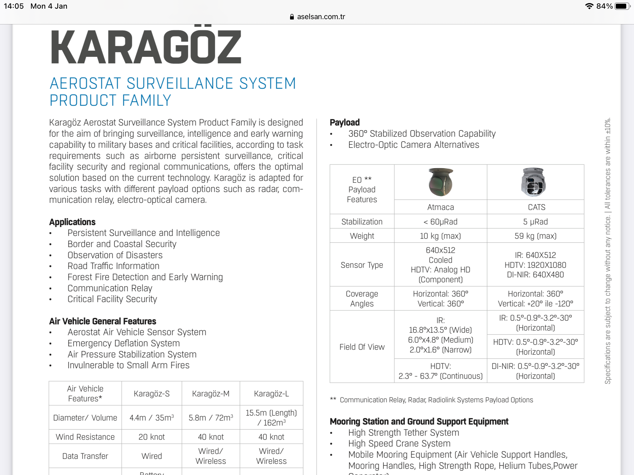

I am interested in its EO system and its specifications but couldn't find anything.
Have you tried Googling reference books related to Electro Optical Systems , Also later adding “military” and “handbook of“ to the search parameters?
There are quite a lot of publications you can purchase. But there are papers and sites that give you a lot of information too.
here are a few:
check this site
114 19,730
here are a few:
check this site
I mean of the exact system. We know that other company was marketing a wide area surveillance gimbal but nothing about Aselsan's solution in Karagoz.
