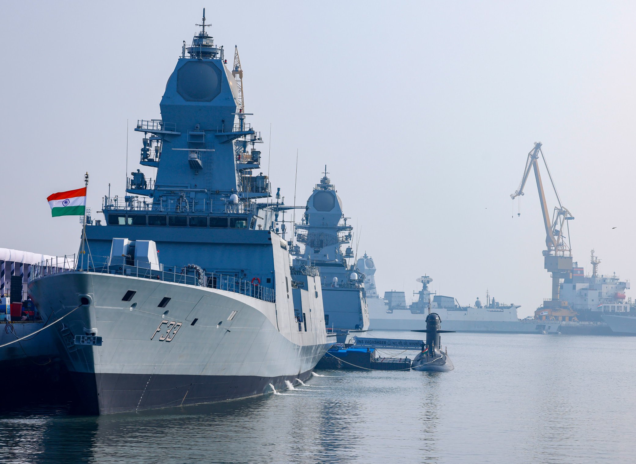

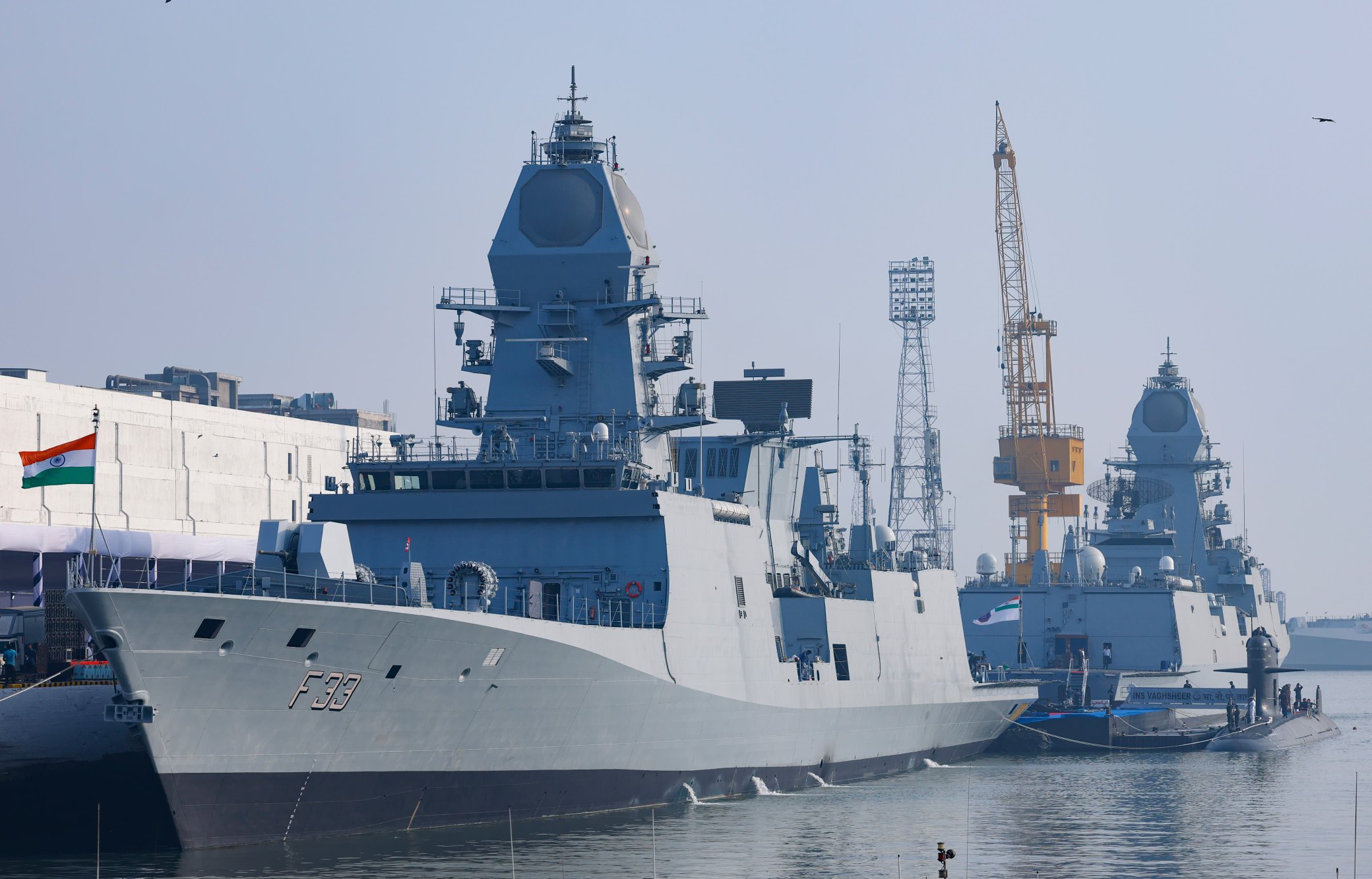

Nilgiri at the commissioning ceremony, berthed alongside the 4th P15B destroyer Surat and the 6th P75 submarine Vagsheer.
Good to see proper flush deck finally maturing in Indian naval design now.
I guess we can expect this to continue going forward with the upcoming destroyer class.
