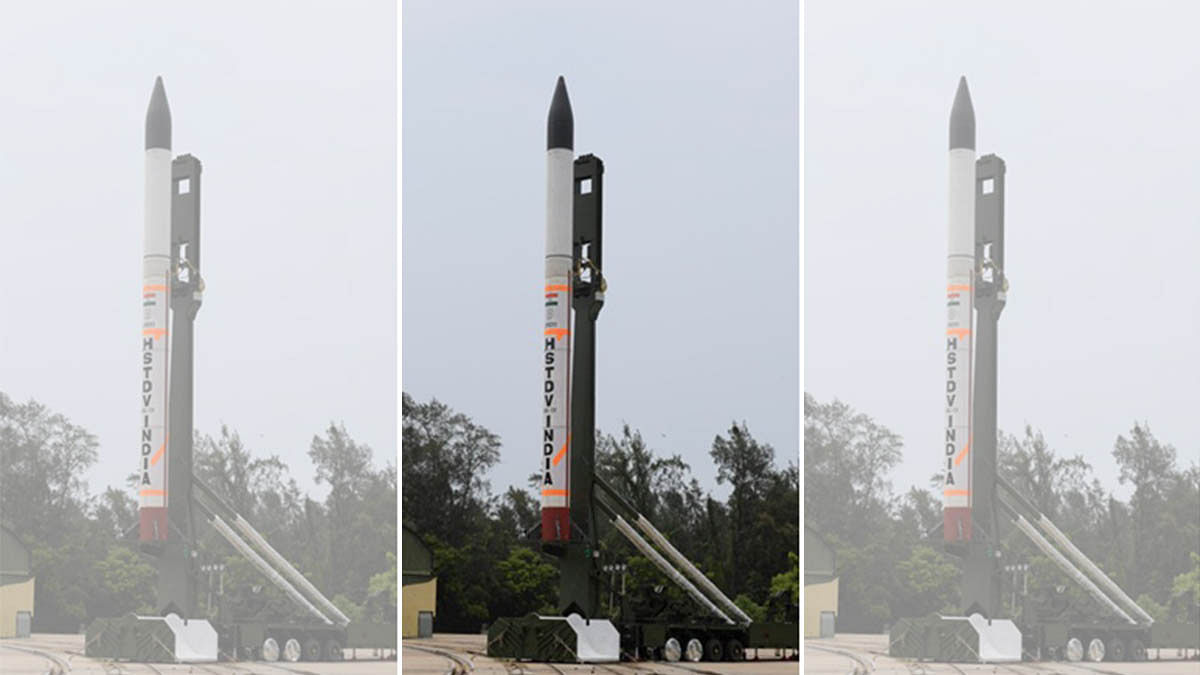

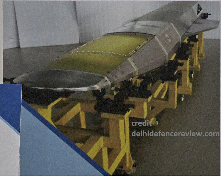

Pic of the first prototype in the assembly jig. Assembly work was handled by L&T Defence. L&T and some other entities were engaged in manufacturing of the various segments. DMRL, a lab of DRDO, made the very fancy alloys that make scramjets work without tearing itself apart :
This is not the one fired today. Today was the second flight test, in the first test the scramjet engine didn't ignite. Everything else worked though.
In today's test we managed to ignite the engine at 30 km height for 22 secs and hit speeds of Mach 6, which was the target for today's test.
The final targeted Mach number for HSTDV is 6.5, it will take a few more tests to iron out the kinks. Here are some old photos of the HSTDV to provide a broader idea of the parameters encountered in scramjet flight:

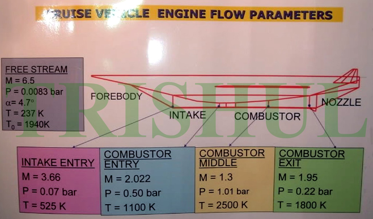

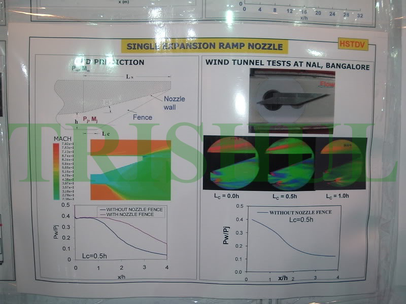

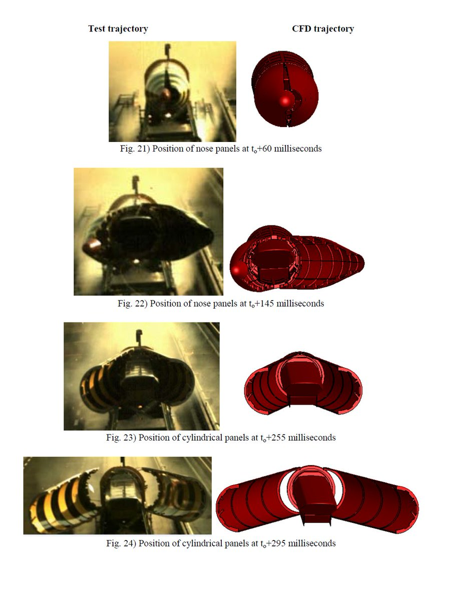

Test of panel separation. Left: Footage from actual test, Right: CFD simulation. Notice how accurately the simulations managed to predict the panel separation.

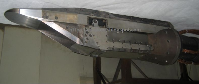

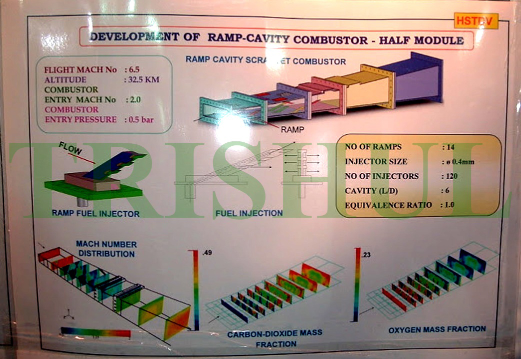

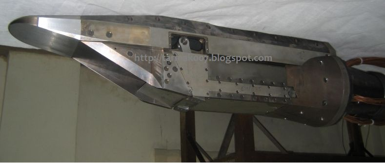

Forebody and intake test piece. For designing the proper shape/dimensions of forebody, nose and intakes :

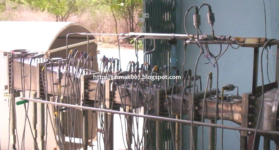

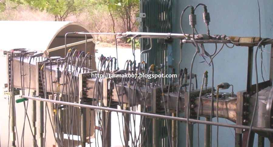

Scramjet engine test stand for testing design and structural integrity of ignitors, flame holders etc. The probes and wires are for gathering valuable pressure, speed and temperature data at various points of the tube :

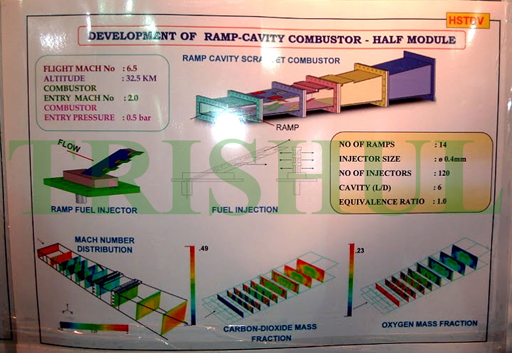

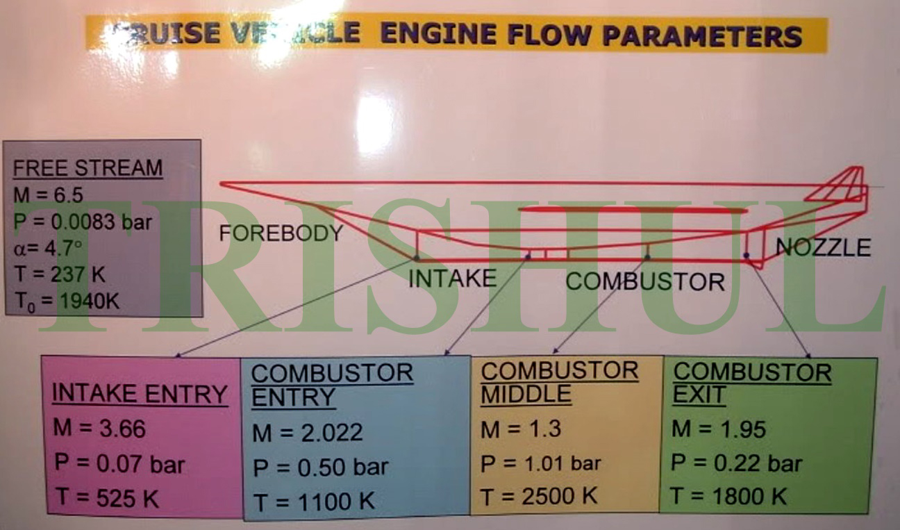

From an old study published in 2015 :
DRDO conducted studies on scramjet combustor with alternating wedge shaped strut fuel injector. The tests were conducted at Mach 7 & at 3 different angles of attack ( α = −3°, α = 0°, α = 3° ).
The results show that the geometry with negative angle of attack (α = −3°) have lowest ignition delay and it improves the performance of scramjet combustor as compared to geometry with α = 0°, α = 3°. The combustion phenomena and efficiency is also found to be stronger and highest in case of α = −3°.
The placement of the Combustor:
Full view of the entire combustor/fuel injector arrangement :
Test model used for the simulation study :
The strut design. The holes are fuel injectors. The wedges are to create compression shockwaves behind the strut. When the shock waves converge they will greatly increase the temperature and pressure thus creating conditions conducive for Ethylene ignition and combustion :
From the simulations :
The conclusions from the simulations are :
1. There is no impact of the wedge formed strut injector in upstream course towards the isolator when α = 0°. Meaning at α = 0°, the shockwaves created by the struts do not cause any backflow in the direction of the intake. All shockwaves are formed in the direction of the exhaust nozzle.
2. The flow properties, shock structure, mixing and combustion phenomena are exceptionally sensitive to the variation of the angle of attack. Here there is a displacement of the shock train in the upstream direction for a negative angle of attack was found. This shock displacement improved the combustion phenomena and decreased the ignition delay. This shock also helps in modifying the shock pattern in the combustor.
3. No thermal choking was found for this setup. The range increment in the different combustor is adequate to keep away from inlet instabilities.
4. The highest temperature found for a negative angle of attack α = −3° is approximately T = 2,980 K. The least ignition delay was enlisted for negative angle of attack (α = −3°) which was ~95 mm downstream the fuel injection and longest ignition delay was found for positive angle of attack (α = 3°). The combustion efficiency is the best for α = −3°.
From the conclusions it is pretty clear that to create initial scramjet ignition just after separation of the first stage. The HSTDV is to be maneuvered to attain an angle of attack ( α ) = −3°. That is the intake nose slightly pointing down. In this α we have the lowest ignition delay and the highest combustion efficiency. Once the ignition stabilizes we can go for α = 0°, as at the α we can get the maximum speed. Although speed will come at the cost of less than the optimum combustion efficiency.

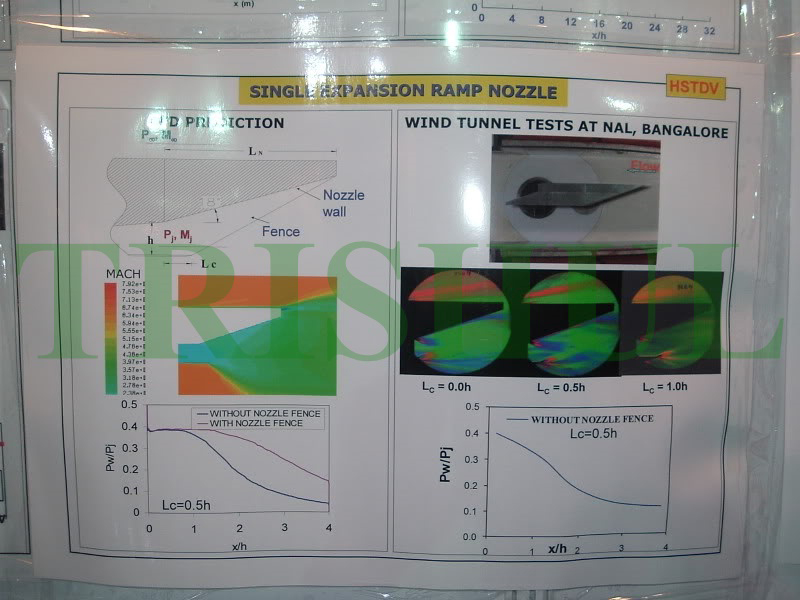

HSTDV's early wind tunnel models were aimed at developing the intake of the scramjet. When that was accomplished design studies of combustor began. With the recent successful test flight it can be said that the intake and combustor designs have attained a degree of maturity. Early wind tunnel models :
1. Earliest wind-tunnel model :
2. Wind-tunnel model seen in the intermediate years :
In the new wind tunnel model ( shown below ) there is an expander nozzle at the end of the engine. Nozzle designs are crucial as they determine the IR signature of the missile. More importantly they play a direct role in maneuverability and thus survivability of the missile. This indicates an increasing focus towards weaponisation of the technology. Some time later when the nozzle design attains maturity and the scramjet engine is able to ignite & combust for longer durations, we should start seeing wind tunnel models with control surfaces like wings, fins etc. That will allow proper aerodynamic drag measurements to be done.
10,592
137 21,480
