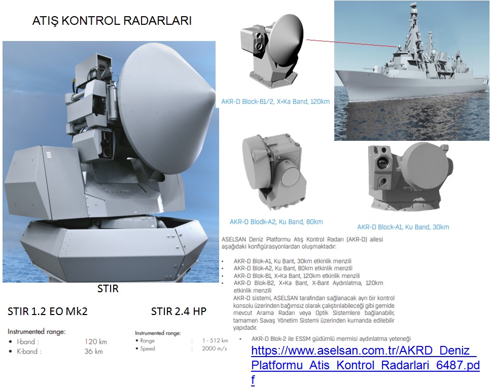

Aselsan plays critical role in ATMACA AsHM success.
Aselsan produces Fire Control System, Seeker Head, Guidance Computer and Power Distribution Unit.

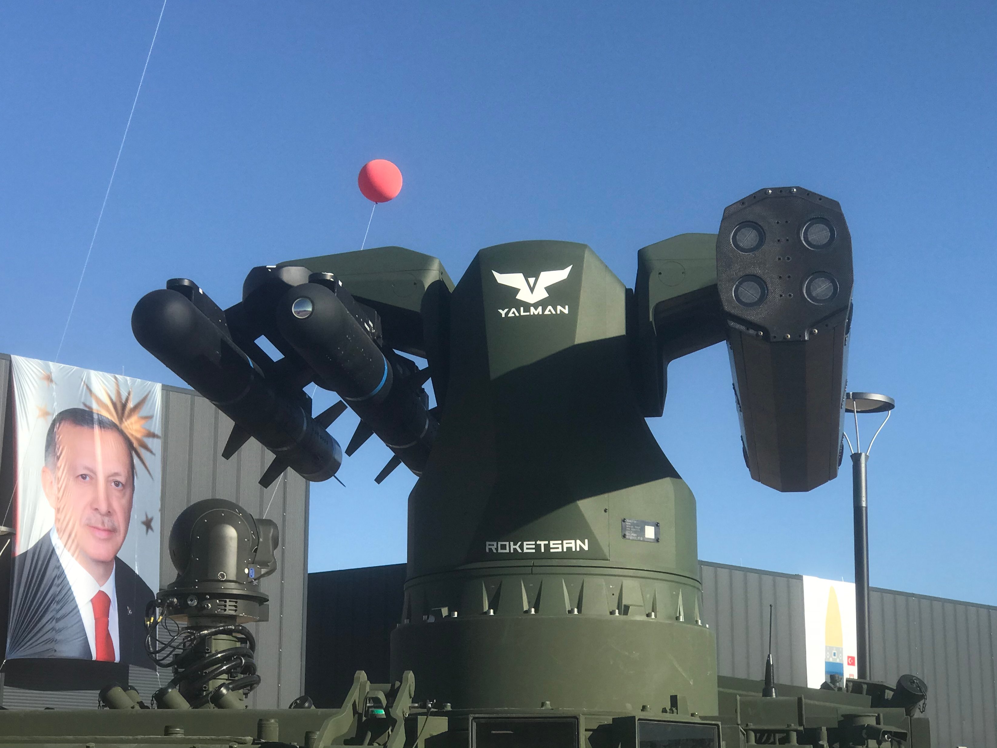

OMTAS, UMTAS, LUMTAS and 4 CIRIT can be used simultaneously with the Yalman Weapon System.

Ohh ASELSAN's radar looks great but upgrading old sm1's is still impossible. The ASELSAN STIR will suit Hisar G and G40.
This ships already equipped with essm mate our priority is long range . Even iran can be able modified sm-1's with buk missiles active radar seekers and add him booster in the end they create a succesfull air defence system sayyad series.
