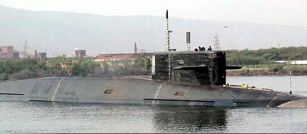

Ballistic missile submarine Arighat in final stages of trials, to be commissioned early 2021​
Once Arighat is commissioned, India will have two operational SSBNs that are equipped with the 750-KM range K-15 missile, designed for retaliatory nuclear strikes.

New Delhi: Arighat, the second of the indigenous Arihant class nuclear-powered ballistic missile carrying submarine (SSBN), is in the final stages of sea trials and will be commissioned early next year, ThePrint has learnt.
Sources in the defence and security establishment said the submarine has performed well during the sea trials so far, and added that the commissioning of the vessel was delayed due to the coronavirus pandemic.
“It should be done (commissioned) early next year,” a source said.
The Arighat was quietly launched in November 2017 by the then Defence Minister Nirmala Sitharaman.
With Arighat in, India will be operating two SSBNs that are equipped with the 750 KM range K-15 submarine-launched ballistic missile, meant for punitive retaliatory strikes in case of a nuclear attack.
Both INS Arihant, which is on operational deployment, and the Arighat have the capacity to carry four missiles each.

The larger, improved and better-armed Arighat is within the last phases of sea trials and is more likely to be commissioned into service early subsequent yr. After teething troubles, India’s nuclear submarine programme — the nation’s costliest defence venture, monitored immediately by Nationwide Safety Adviser Ajit Doval — has made massive strides lately.
Indian Navy To Get 2nd Nuclear SSBN Arighat
In October 2018, the veil of secrecy across the programme was lifted for the primary time when India acknowledged that INS Arihant, its first SSBN — a nuclear-powered submarine geared up with nuclear-tipped ballistic missiles — had accomplished its first deterrence patrol. Now, Arighat is within the last phases of sea trials and is more likely to be commissioned into service early subsequent yr.
“It ought to be executed (commissioned) early subsequent yr,” a supply mentioned. The submarine has carried out nicely throughout sea trials and its commissioning has been delayed by the outbreak of Covid-19.
With the Arihant-class venture now working at “assembly-line tempo”, the programme has additionally acquired a brand new vertical — SSNs or nuclear-powered submarines which, in contrast to the SSBNs, are armed with missiles with standard warheads. In 2019, the federal government granted Rs 100 crore for the preliminary section of growth of those submarines. With success within the preliminary design section, the programme has obtained clearance from the federal government for the detailed design section. Which means that the federal government will now deploy extra sources for this venture.
