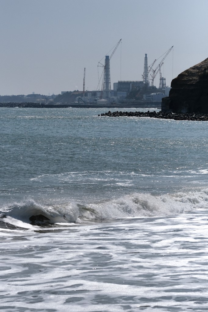

The earthquake and tsunami that struck eastern Japan on March 11, 2011, caused a serious accident at the Fukushima Dai-ichi nuclear power plant on the northeastern coast of Japan.
How did it happen?
The earthquake cut off external power to the reactors. tsunami, which reached levels more than twice as high as the plant was designed to withstand, disabled backup diesel generators, crippling the reactor cooling systems. Battery power was quickly exhausted, and overheating fuel in the plant's operating reactor cores led to hydrogen explosions that severely damaged three of the reactor buildings. Fuel in three of the reactor cores melted, and radiation releases from the damaged reactors contaminated a wide area surrounding the plant and forced the evacuation of nearly half a million residents.

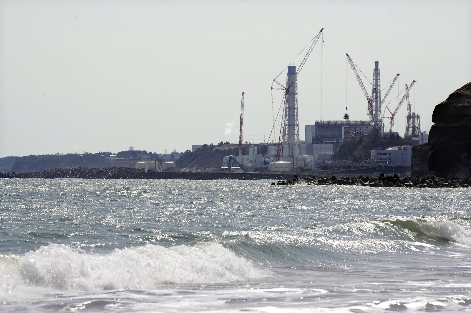

Fukushima, Japan, March 2011The earthquake and tsunami that struck eastern Japan on March 11, 2011, caused a serious accident at the Fukushima Dai-ichi nuclear power plant on the northeastern coast of Japan.
How did it happen?
