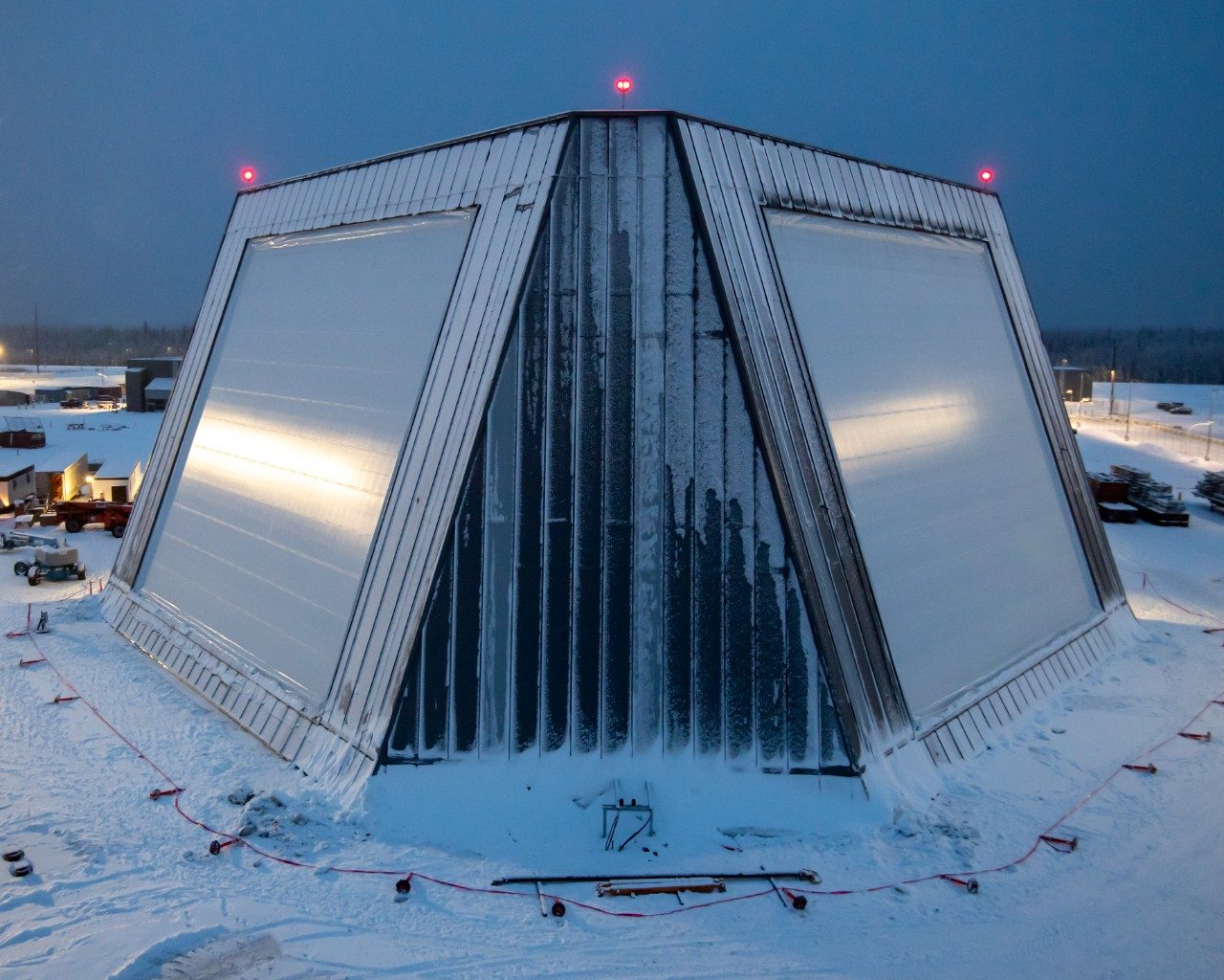

Hello "oldcpu". Yes indeed the Lockheed Martin/MDA Long Range Discrimination Radar (LRDR) is based in the LM SPY 7 Radar Technology and is a massive undertaking by both LM/MDA & US. Although they do not say how many MRAs are in each 4-sided Phased Array Assembly blocks, each block is 60 feet by 60 feet so I would think at least a few hundred RMAs minimum each, as can be seen by the pictures of the ones in Alaska & Guam (Just a "few" more than either the SPY 7 (V1, V2 V3) ships or even the new SPY 6 (V1) on the Arleigh Burke Block III ships. There is a picture of part of the inside of an assembly array. These Ground Based LRDR Radars (GBRs) are strictly for BMD to protect the US and part of DTs "Golden Dome" project which Canada is "considering" joining. The IDIOT in the WH has said recently that Canada's costs would be somewhere around $61 Billion US (over $84 Billion CDN) but would cost us nothing as the 51st state (take that with a grain of salt)!! This system has already been successfully tested between Guam & Alaska and the technology has been proven by both LM/MDA. There are also videos on line of the process from initial launch to missile destruction. "If" Canada were to join the Golden Dome program, I suspect the River Class Destroyers (RCDs) would also have this BMD capability. These Arrays would most likely have some powerful cooling generation to keep the system going.
