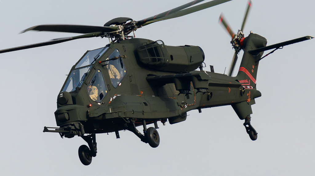

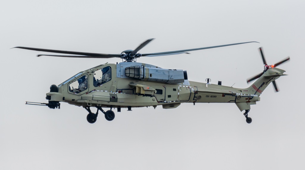

The first prototype of the Leonardo AW249 next-generation attack helicopter flew for the first time on August 12, 2022, from the company’s plant in Vergiate. The helicopter, formally designated as AW249 NEES (Nuovo Elicottero da Esplorazione e Scorta / New Exploration and Escort Helicopter), will replace the AW129 Mangusta, which has been in service with the Italian Army since the 1990s and upgraded throughout the years until the current AH-129D variant.
The helicopter flew with just its primer paint and the experimental serial CSX82069. On the fuselage and tail boom we can see some lines created with grey and red tape, with the latter possibly being used to attach strain sensors on the surface to monitor the stress on the airframe during the flight. Also, the helicopter has already been equipped with the TM197B 20 mm cannon and the Rafael Toplite targeting system inherited from the Mangusta.
