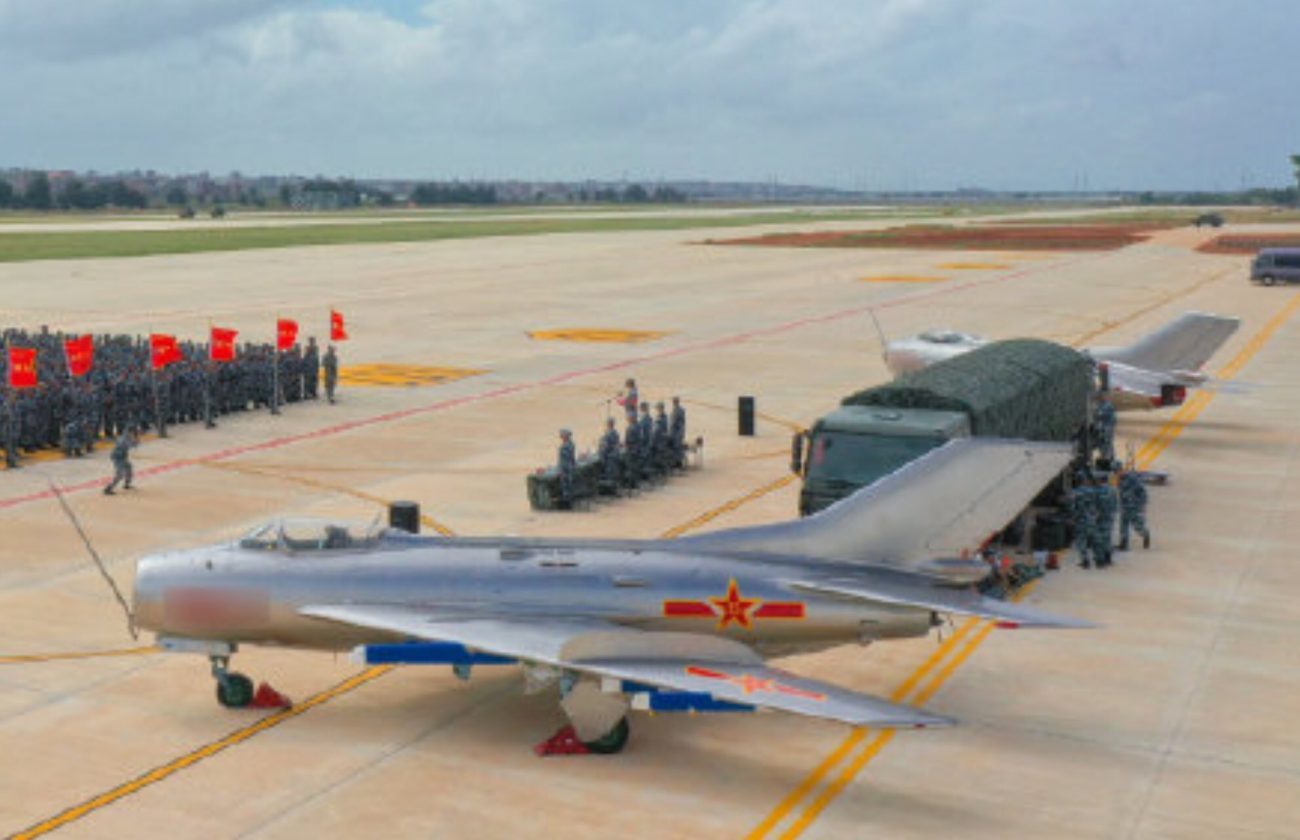

Can look at doing something similar to this:
Has China copied an American tried-and-tested formula? The US Air Force has long undertaken a similar project to convert its aging F-16 variants and repurpose them as operational drones.
The USAF, however, intended to use these “dronified F-16s” to test new weapons and air assets, particularly the F-35 Joint Strike Fight. Prior to its refurbishment of F-16s, the service had been catering to this training requirement with its F-4 Phantoms.
The US, however, turned towards the F-16 following a shortage of obsolete F-4 Phantoms to repurpose. The process, according to Woodrow Bellamy, writing for Aviation Today, involves ripping out unnecessary components and replacing them with 3,000 wires, a flight control computer, and a new autopilot.
The planes are also redesignated with the prefix “Q,” the military aviation code for unmanned aircraft, making them QF-16s.
