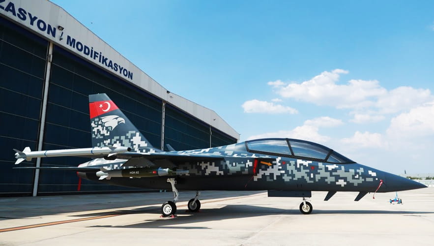

Would be cool if they have this camo then:
