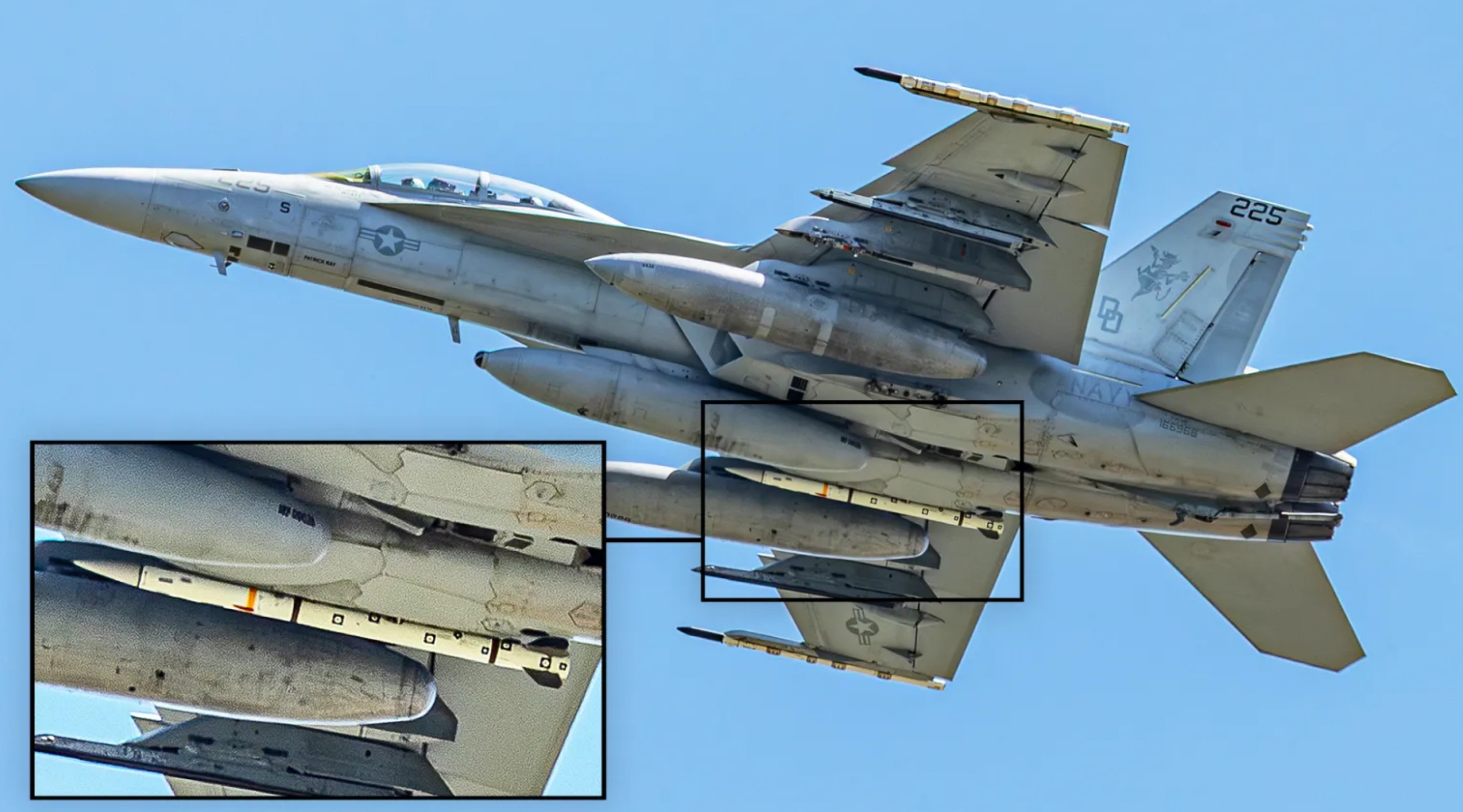

The first picture of the U.S. military’s new AIM-260 Joint Advanced Tactical Missile (JATM) has emerged. Flight testing of the JATM is known to have started years ago, but it has never been seen publicly before now. The missile is expected to augment and ultimately replace the venerable AIM-120 Advanced Medium-Range Air-to-Air Missile (AMRAAM) in U.S. service.
Photographer Jonathan Tweedy took pictures of several U.S. Navy test jets departing Eglin Air Force Base in Florida on May 13. This included an F/A-18F Super Hornet from Air Test and Evaluation Squadron 31 (VX-31) carrying the AIM-260 on the fuselage station outboard of its right engine intake. The jet also has a modified FPU-13/A drop tank with an infrared search and track (ISRT) sensor on its centerline station, as well as flight data pods on its wingtips. The Aviationist was the first to publish Tweedy’s pictures of the VX-31 jet with the JATM.
Eglin is routinely used as a staging point for U.S. military aerial weapons testing, as well as other aviation research and development and test and evaluation work. The base is situated right next to extensive over-water ranges over the Gulf of Mexico, off the coast of the Florida panhandle.
When it comes to the AIM-260, Tweedy’s picture confirms the design is very minimalist, at least externally, with only four fins at the tail. Unlike the AIM-120, it has no mid-body control surfaces, or even strakes running along the sides. The JATM’s overall configuration reflects optimization for maximum speed and range.
The JATM in this case looks to have a live high-explosive warhead, as indicated by a yellow band at the front end of the body. There are also two black bands toward the rear, which could point to the location of the missile’s rocket motor.
The nose cone has a distinct light gray color compared to the rest of the predominantly white body. There are square markings at various points at the rear of the body, which are often seen on aerial munitions and aircraft during testing to help with visual tracking, as well.
Overall, the AIM-260 seen in Tweedy’s pictures looks entirely in line with what had previously been depicted in official renderings of the JATM, both in terms of its design and markings.

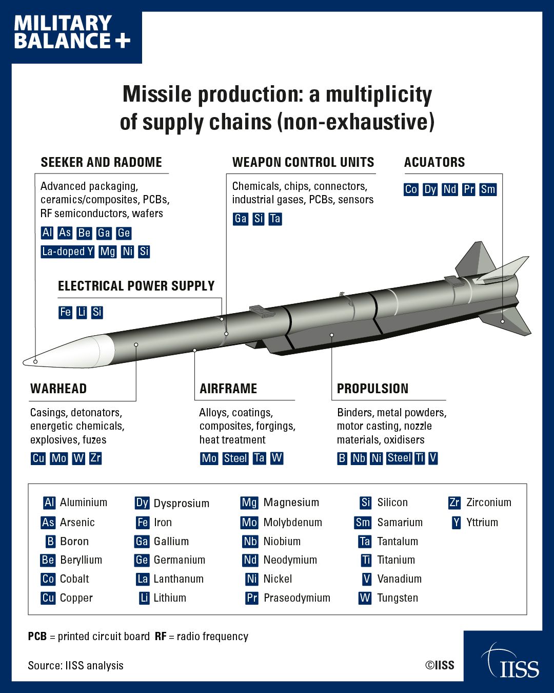

Missile production illustrates the complexity of contemporary defence-industrial supply chains.
Between the raw materials, mining operations and final assembly, the manufacturing process requires propellants, batteries, printed circuit boards (PCBs), semiconductors, industrial gases, radome materials, actuators, connectors, testing equipment, and manufacturing and processing equipment, to name but a few.
Read the full analysis by Dr Lucie Béraud-Sudreau: go.iiss.org/3R5mov2
