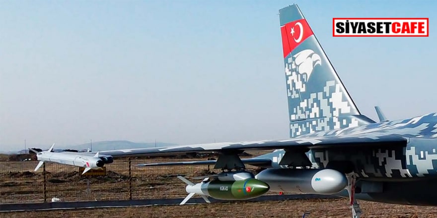

Hürjet capable of VTOL mentioned by Ismail Demir.
I know conditions/need change and our defence industry must adapt to the changes/needs. I would be really sorry to see Storm P makeshift changes to built platforms unless we're entering war. I see such changes as being waste of money and reduces lifetime of the platforms.
I will not get excited or overjoyed based on palavra. Hürjet is a must I don't care if it can land on LHD, or AC. Building our own fighter jets will be a big enough step in itself to offset the balance, even if it's a Light Jet.
If you need reason to spend more money to keep the capital flow high, then build more Naval Vessels. I don't mind if TN grows. If we have 10 ekstra Ada class then that means our TN personnelle doesn't have to break records.
15 8,752
