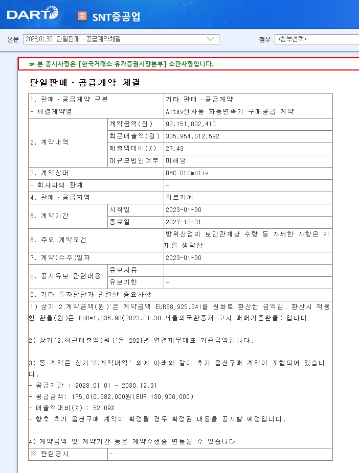

Today, the Electronic Disclosure System Service of the Financial Supervisory Service (DART, Data Analysis, Retrieval and Transfer System), a South Korean government agency, registered a record of a 267 billion won (200 million euro) transmission supply contract for Altay tanks signed by SNT Dynamics and BMC. In the first contract signed by SNT and BMC, EST15K transmissions to be integrated into the Altay of about 90 units will be supplied from South Korea from 30 January 2023 to 31 December 2027.
In addition, there is an additional contract worth 175 billion won (130 million euro) to supply approximately 150 transmissions from 1 January 2028 to 31 December 2030. Under the deal, SNT will supply BMC with transmissions for approximately 240 Altay tanks from January 2023 to December 2030.
I am now sure that the EST15K transmission has passed the Altay durability test. I'll be back if there's any another news. There's really no more Yılan Hikayesi.

There was word in turkish media about the Korean transmission being modified in Turkiye by Turkish engineers, so that's probably how it passed the durability tests. Also why so may purchased, isnt BMC planning to use their own powerpack after 2025.
The transmission will not be produced in Turkiye, but will be assembled and produced in Korea and sent to Turkiye. The new korean transmission to be supplied to the BMC has been previously improved by SNT. As I said before, I understand that engineers from Hyundai Rotem and SNT joined BMC and participated in Altay's transmission test.
In six durability tests conducted between January 2016 and February 2017, German parts, which account for 30 percent of the transmission, were replaced with Korean parts after the Korean transmission failed to pass due to defects.

I didn't say it would be produced or assembled in Turkiye, I said that according to statements by SSB officials in the media the Korean powerpack was going to be modified by Turkish engineers to reach a more desirable performance.
I've never seen such a source in my information. Korean transmission already mentioned that SNT official fixed the defect in December 2021. Modifying the design of an engine or transmission typically requires the designer's permission. Engine and transmission design drawings are required for BMC engineers to technically access Korean-made engines and transmissions, which are highly unlikely to have been approved by Korea.
If such an enhancement were to be done it would just be done by South Korea as part of the contract when they make the transmissions.
