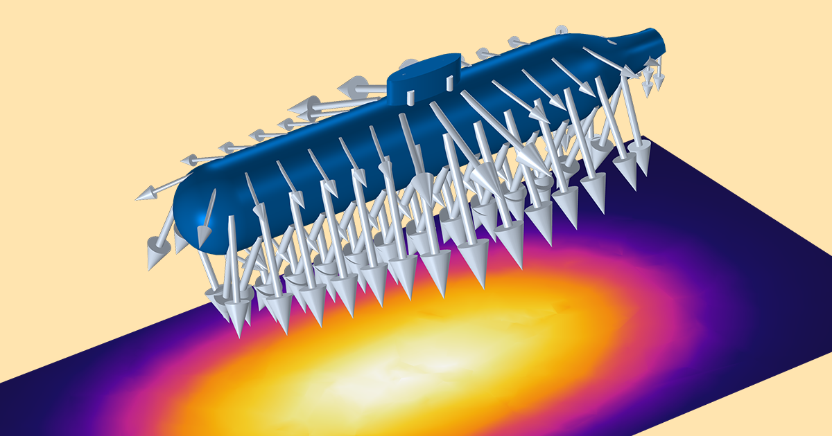

Some basic background on this topic:
Much of the state of the art in hiding such magnetic signatures is currently classified.
