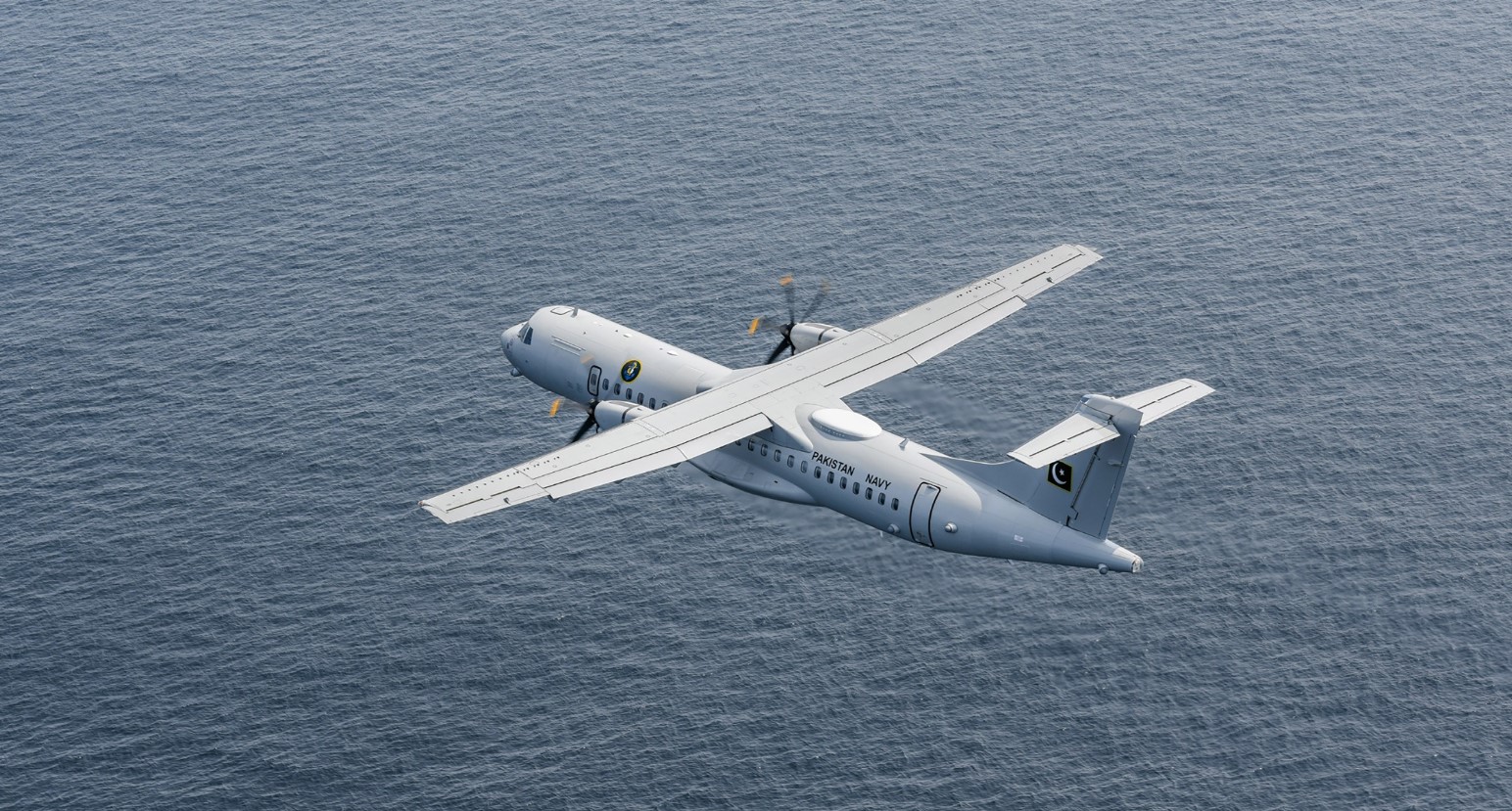

The RAS-72 Sea Eagle is among the Pakistan Navy’s (PN) newer inductions. The RAS-72 is a maritime patrol aircraft (MPA) based on the ATR-72, a commercially available commuter aircraft. The PN initiated the RAS-72 MPA program in 2016 by contracting a German aircraft maintenance, repair, and overhaul company – Rheinland Air Service (RAS) GmbH – to carry out the integration and testing work.
It seems that the PN ordered the RAS-72 to replace its Fokker F27s. Compared to such a predecessor, the RAS-72 is a significant capability upgrade. The RAS-72 consists of a new-generation subsystem and sensor suite. Moreover, unlike the Fokker F27, the RAS-72 can also carry torpedoes and anti-ship missiles.
Currently, the PN operates two RAS-72s, with a third aircraft on order.[1] According to the main contractor, Rheinland Air Service (RAS), the PN planned to acquire a total of four RAS-72s.[2]

The Pakistan Navy’s RAS-72 Sea Eagle
The PN contracted RAS GmbH to configure two ATR-72s into MPAs in 2015, with RAS GmbH starting the work on the first aircraft in 2016.[3][4] The PN received its first RAS-72 MPA in July 2018, and formally inducted that same aircraft in December 2018. It inducted the second RAS-72 in January 2020. The third aircraft is undergoing the conversion process at RAS GmbH’s facility in Mönchengladbach. Currently, the PN intends to acquire four RAS-72 MPAs, ostensibly to replace its Fokker F27s.
The PN selected the ATR-72-500 to serve as the basis for its RAS-72s. However, the PN opted to configure its aircraft’s Pratt & Whitney Canada PW127F turboprop engine to the level of the PW127M. The engines offer an output of 2,750 shp. In other words, the PN’s ATR-72-500 is similar to the ATR-72-600.[5]
