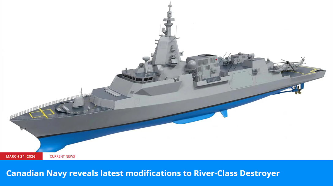

CSC TYPE 26 LM/DND RCD DESTROYER LATEST INFO GRAPHIC/CAPABILITIES AS OF 24 MARCH 2026
Here is the latest updated CSC Model as is either known or self-speculated as of 24 March 2026 for the Canadian Surface Combatant (CSC) Type 26 RCD Destroyer weapons & systems design at the Calgary, Lockheed Martin (LM)/DND booth at DEFSEC West 2026. The total Leonardo Suite including the Leonardo 127mm 5” Vulcano/Lionfish & 2 x Marlin 30mm Gun systems (including the NA-30S Mk 2 systems) have been fully removed and replaced by the US Mk 45 Mod 5 (radar system center-lined on top of the Bridge) and 2 x Bushmaster British made Mk 38 Gun systems (Port-S'tbd either side of Hanger Top). The NSM placement has changed (again). Now located Midships-Top-side/Stb’d Aft. The RAM 116 Missile system (21) is finally confirmed located Top-side Port on a plinth with a firing arc (just Fwd of the Port Bushmaster Gun (looks like just 1 x RAM 116 Missile system-for now). The US-AN/SLQ-32 (V) 6 EW suite is now included along with new 2 x 9 USN Long Endurance Electronic Decoy (LEEDS) “soft kill” Systems (Port/S’tbd Waiste Areas). ExLS System Aft of the funnel is gone and no longer part of the design. The number of MK 41 VLS Cells Fwd is still at 24 Cells vice 32 but there is still room for future growth to 32 Cells. As seen by this latest graphic, the mast is taller but has lost the X Band Illumination AESA Radar. It has been identified that the X Band Illumination Radar is now not required for the CSC Destroyer as the SPY 7 (V) 3 has the capability of targeting all threats on its own. The Port/Stb'd Waiste areas midships are still "cut-out" to save weight no doubt (or perhaps for “future-proofing”). The crew size is still at 210 personnel. The ship tonnage is still at-8,080 tonnes although that may not be the full-load weight (possibly around 9,400 tonnes):

Latest CSC Info-graphic from Lockheed Martin (LM)/DND-24 MARCH 2026
Overall, this model confirms a lot of what’s been expected over the past year-simplification, more Standard NATO Systems, and fewer experimental additions. Still some mysteries but we’re likely getting closer to the final configuration as the program moves towards CDR.
