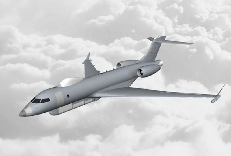

I read somewhere Turkey are having a dedicated jammer , based on a business jet.
5,360
81 45,456

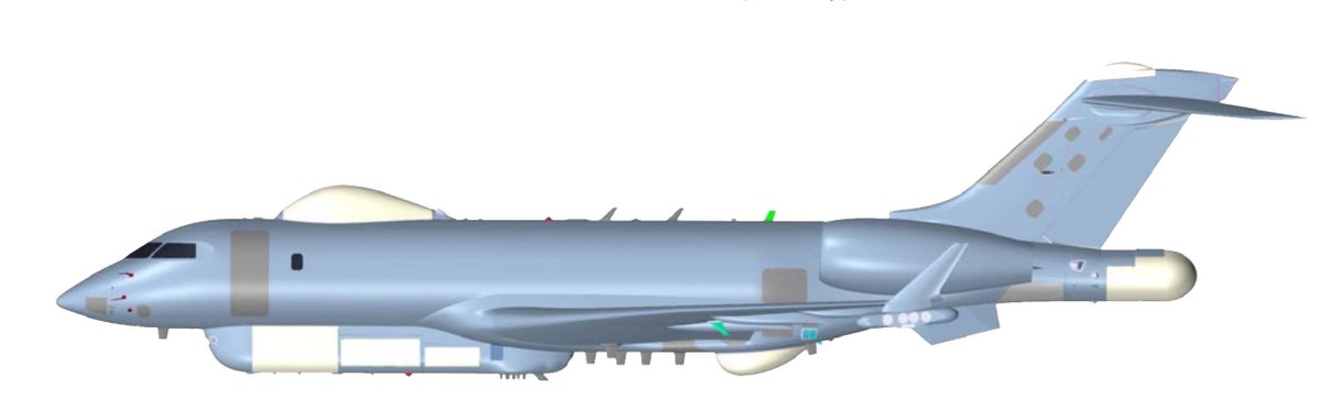

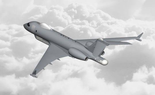

4 Hava-SOJ will be delivered to Air Force. When they are completed, they will be a new force multiplier without any doubt. Aİrcrafts delivered to TAI and Aselsan/TAI is modifying the aircrafts with Turkish sensors at present.
8,361
22 12,854
at what possible scenario will Turkey deploy this??, what is it going to differ with Fighter jet based pod jammer??
What makes a jammer system different from another is about the resistance to heating and electromagnetic radiation power outputs. Resistance to heating is about semi-conductors technology you are using on antennas/radars and It limits the power younare going to use on these Systems and power output is about the energy you are going to feed these systems with. It is not possible for a fighter aircraft to provide the energy Hava-Soj can give to its own sensors. Aircraft has many other optic, radar and Electronic warfare self protection sensors that is consuming great percentage of generated energy.
5,580
125 25,412
It can do wide-area jamming of frequencies and probably can be used on long range ELINT/SIGINT. A fighter based EW will serve for fighter itself to jam R/F and other guided missiles, engaged enemy aircraft/cruise missiles or AA systems in short range and in a limited area and protect the fighter from jamming.
