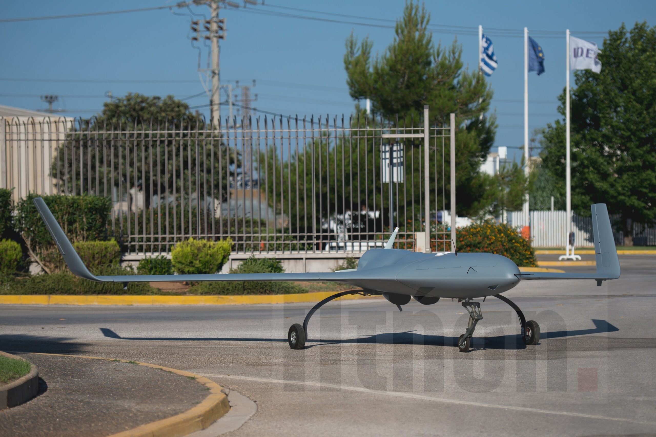

DELAER-RX3
RX3 Scaled

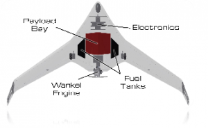

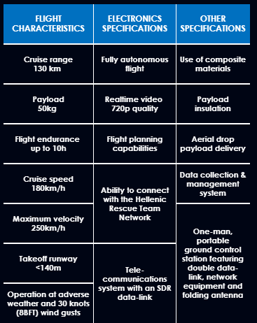

Objective and goals
The main goal of the DELAER research project objective is the design, development, manufacturing and flight testing of a prototype Unmanned Aerial Vehicle System (UAS), which will provide direct support to Greek isolated territories and islands, via aerial delivery of lifesaving supplies and dedicated equipment. The system will be based on a large-scale, autonomous, fixed-wing, novel Blended Wing Body (BWB) Unmanned Aerial Vehicle (UAV) configuration, as well as a portable ground control station (GCS).
Mission
The DELAER RX-3 mission involves cruising to the point of interest for up to 65km, payload delivery, and cruising back to the base of operations.
Payload
RX-3 payload has been selected to support a wide range of humanitarian missions (life rafts, medical equipment, provisions etc.).
Aerodynamic Design
The DELAER RX-3 design was based on well-established aircraft design textbooks and methodologies. In-house sizing tools and routines were used to facilitate the layout, aerodynamics, and stability calculations. These tools were adjusted to the needs of UAVs and tuned to incorporate the unique characteristics of the novel BWB platform. They have also been validated through the design of the HCUAV RX-1, the first large-scale Hellenic Civil UAV for surveillance missions, which has successfully undergone several flight tests.
Computational analysis
The layout design and sizing procedure is compatible with FAA pt. 23 regulations and supported by high-fidelity aerodynamic analysis (CFD) and structural analysis (FEM) tools. The geometry used for the analyses was generated with the use of existing parametric 3D CAD tools, which allow the changes at the aerial vehicle configuration to be executed with speed and accuracy. The results were imported in a dedicated flight simulator software, for the evaluation of the key performance, aerodynamic and stability specifications of the RX-3.
Electronic systems
Both the RX-3 and the GCS will be equipped with state-of-the-art electronics and telecommunication systems, which will be developed in order to satisfy the operational requirements and will be capable of operating under adverse weather and environmental conditions. The aerial vehicle will communicate with the GCS through encrypted radiocommunications. A data gathering and management software will support the operations of the DELAER RX-3 system.
Construction
The manufacturing procedure of the RX-3 will comply with the latest machining and composite material fusion methods. Both the metal parts and the carbon fiber molds will be manufactured using state-of-the-art 5-axis CNC machines, to ensure an accurate representation of the complex 3D shape, as well as high surface quality. The final processing will be performed in a composite materials auto-clave, under strictly monitored temperature and pressure conditions, based on certified procedures.

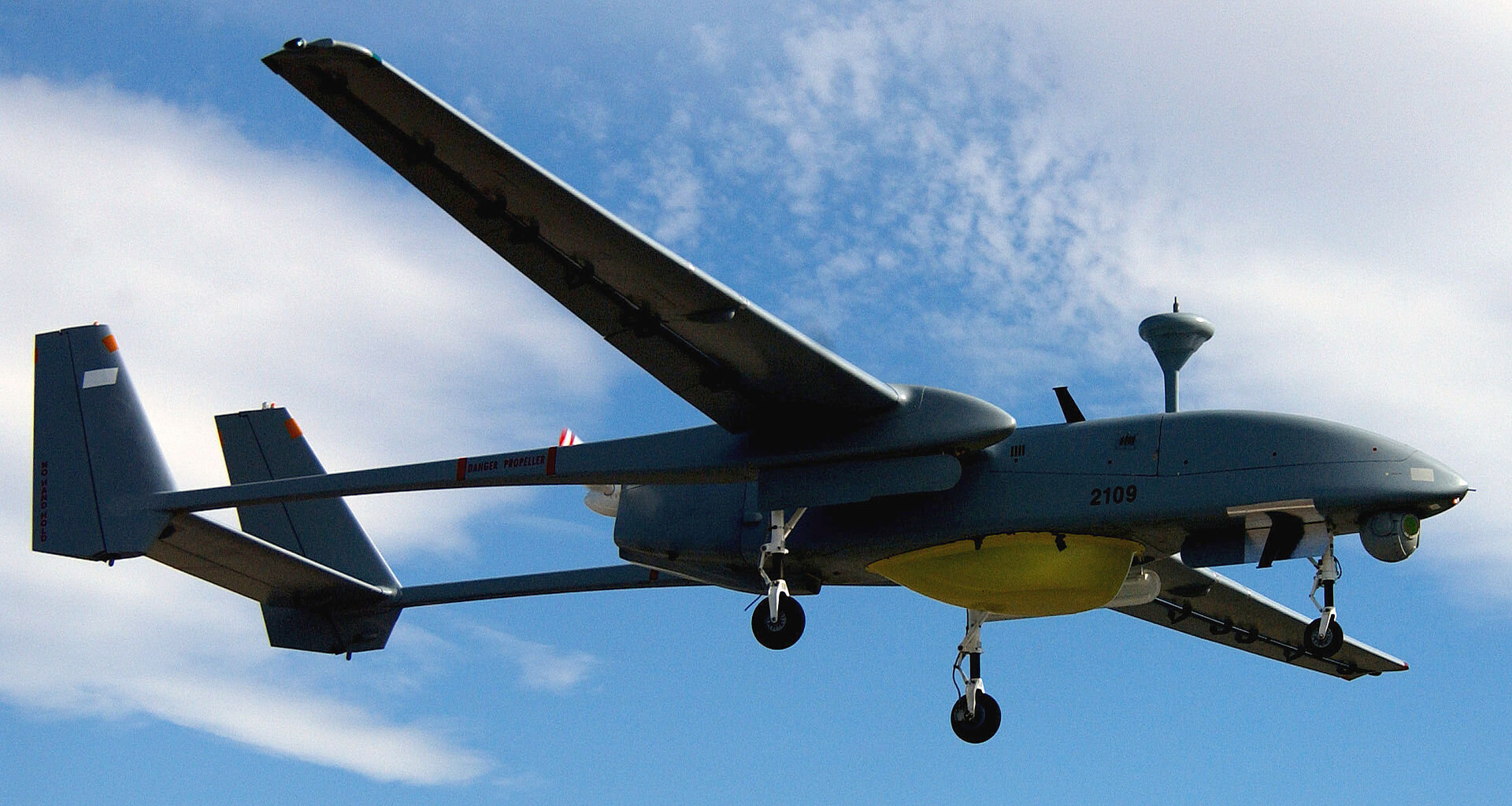

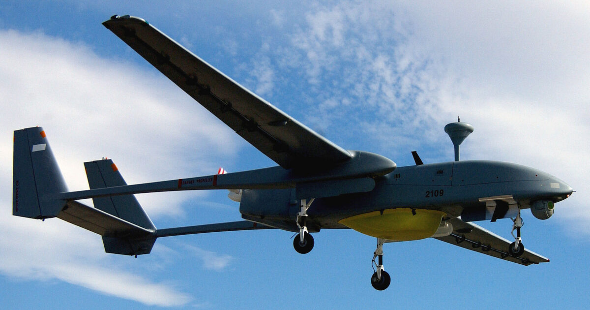

In April, the two UAV IAI Herons that Greece has acquired through leasing from Israel are expected to appear in the Greek ethers. In the previous days, the training of Greek pilots in Israel was completed, as well as the control of the operational and technical specifications by a unit of the Hellenic Air Force. The drone station will be installed in Skyros while the UAV IAI Heron will be able to relocate to other Aegean islands. UAV IAI Herons can carry out missions up to 1,000 kilometers from their base. According to the manufacturer, the functional configuration of the system consists of marine surveillance radar and an electro-optical sensor with capabilities for operation both day and night. The Greek Ministry of National Defense has rented the two Israeli UAVs for 3 years for 35.5 million euros. The contract signed by the General Directorate of Defense Investments and Equipment provides for the possibility of acquiring the UAV IAI Heron after the end of the leasing.

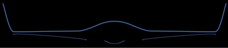

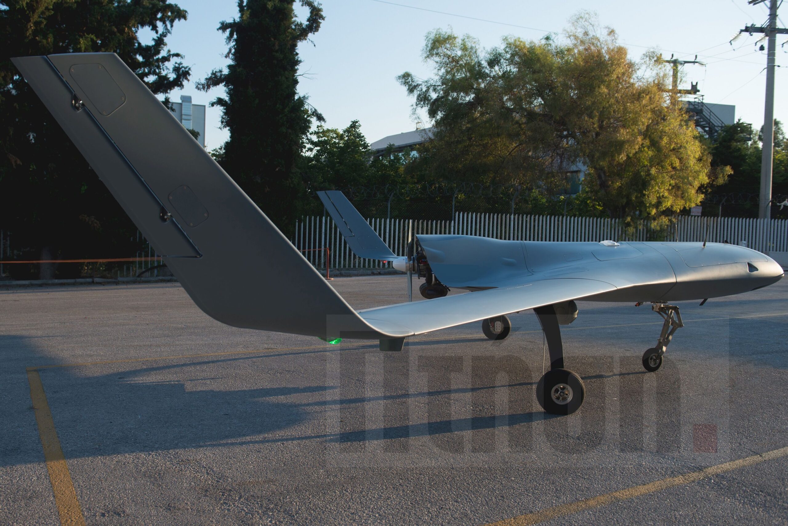

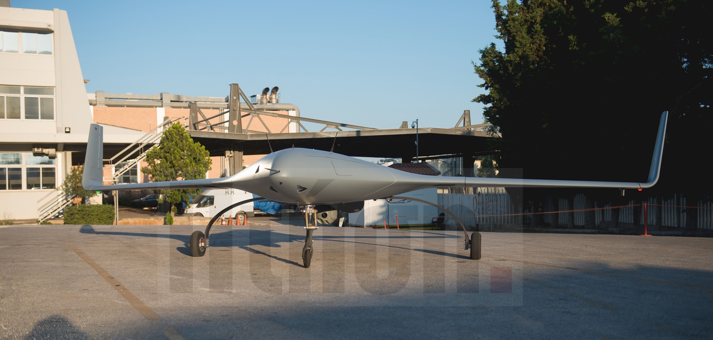

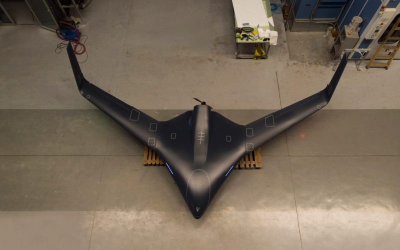

DELAER RX-3plus​
One of the most interesting Greek appearances at the DEFEA exhibition , which opens its gates on Tuesday 13 July and will last until Thursday 15 July, is the Tactical Remotely Piloted Aircraft System (TRPAS) RX-3plus , of INTRACOM DEFENSE (IDE).
It is a direct evolution of the corresponding aircraft of the DELAER research program(DELAER RX-3) , which was recalled aimed at the design, development, construction and flight test of an ACE (Unmanned Aerial Vehicle) system that could meet the needs of rapid transport of sanitary supplies and other critical equipment hard to reach areas of Greek territory. The Aristotle University of Thessaloniki, Department of Mechanical Engineering, participated in the DELAER program, with the funding of the General Secretariat for Research and Development, while IDE was responsible for the aircraft's electronic equipment, radio-communication infrastructure and ground control station.
Given the flexible approach to innovative design, the UAS of the DELAER program was easy to evolve for other applications. One of these is the RX-3PLUS version as Tactical Unmanned Aerial System (Tactical Remotely Piloted Aircraft System - TRPAS ) designed for performing surveillance functions and identification - ISR (Intelligence-Surveillance-Reconnaissance -) with advanced autonomy via line incorporating innovative technologies.
The system consists of a Unmanned Aerial Vehicle-UAV (Unmanned Aerial Vehicle) fixed wing and a Ground Control Station (GCS).
The key technological features of the RX-3plus are :​
  • The BWB (Blended-Wing Body) configuration, ie a wing that "merges" with the fuselage offering high aerodynamic efficiency, which translates into:
  1. Lower fuel consumption, therefore greater autonomy
  2. Increased load carrying capacity
  • Equipped with multiple sensors and an innovative data processing system where AI (Artificial Intelligence) techniques are widely used to detect, identify and categorize targets. This minimizes the operator's burden and maximizes its efficiency.
  • The integration of reliable avionics designed with an emphasis on safety and operation in GNSS-denied environments (GNSS-denied environments) and field-tested. They consist of a triple autopilot, a high-performance navigation system with tracking points (waypoints) and all the peripherals and instruments needed for safe flight.
  • The Ground Control Station (GCS) that is safe in cyber attacks and easily configurable to serve the needs of all potential users.
  • The long-range communications system with ad-hoc networking capabilities, secure transmission, as well as transmission of data from the aircraft sensors in real time to recipients on the ground.
The RX-3plus system was designed to be used to perform collaborative missions in the form of teaming and swarming with other manned and non-manned vehicles via FANETs (Flying Ad-hoc Networking topologies) communications support.
Technical characteristics of the RX-3plus
Extent : 7.15 m
Length : 4.3 m
Maximum take-off weight : 260 kg
Autonomy : 13 hours
Maximum cruise speed : 180 km / h
Loiter speed : 120 km / h
Take-off / landing : runway 150 m long
Operational roof : 12,000 ft
Maximum wind speed for businesses : 8 Beaufort
