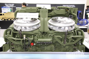

SMV-1000
One of the biggest advantages of the SMV-1000 mentioned in the video is the ability to replace the K-9's engine (MTU MT 881) without changing the system equipment.

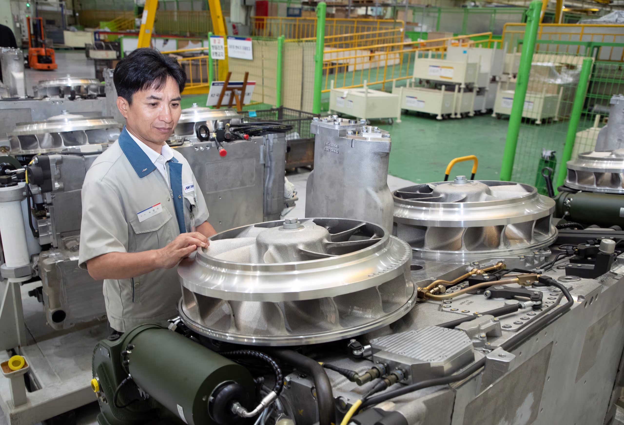

The first mass-produced power pack for export to Turkiye was delivered in April last year, and the power pack under test in the article is the second mass-produced power pack. Unit 3 is in the works at another plant. It takes more than six months to make a single transmission, but once a large-scale mass production system is in place, it is said that a transmission can be made every three days. SNT Dynamics is planning to set up two transmission production facilities to meet the initial volume of Altay tanks.
Testing the Turkiye export power pack in the 1700-hp test chamber at the SNT Dynamics Reliability Test Center.
From left, an automatic transmission for the K-9 self-propelled howitzer, an automatic transmission for the K2 tank, and a power pack for the K2 tank.

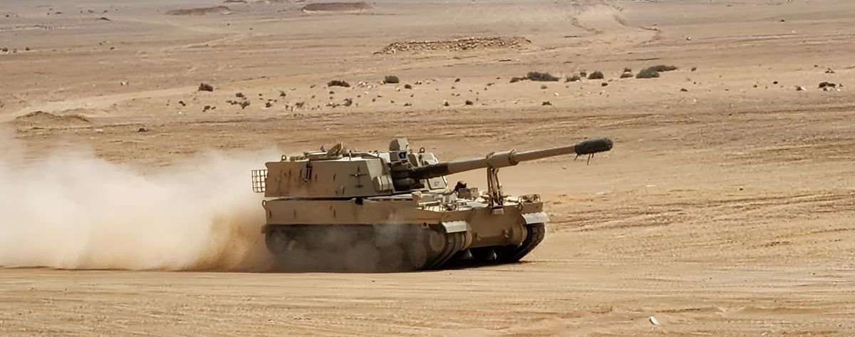

Hanwha Aerospace announced on Wednesday that it has recently successfully completed the durability test of the K9 self-propelled howitzer 's domestic engine, which was conducted from the second half of 2023 to December last year. The engine was tested for 10,000 kilometers in various driving environments, including deserts and mountains, at home and abroad, including Middle Eastern countries such as Egypt, and met all technical and operational requirements for performance and maximum power.
Accordingly, the K9 self-propelled howitzer with a domestically produced heart will be mass-produced in Egypt from the second half of this year(I saw a press article that said December.).
In February 2022, HANHWA Aerospace signed a contract with the Egyptian government to export a package worth 2 trillion won, including the K9 self-propelled artillery gun, K10 ARV, and K11 FDCV.
To integrate the newly developed indigenous engine into the existing K9 system, veteran pilots have been driving the vehicle for over a year. Each day, four pilots took turns driving 100 kilometers.
