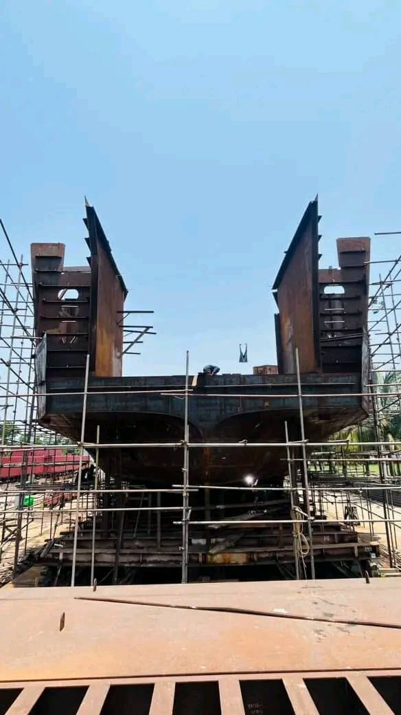

So instead of DEW, KSY's gonna build the three LCTs for BN. DEW is probably responsible for supplying design and materials only. Keel laying ceremony was held yesterday. This design ☝️ KSY displayed few months ago was also displayed in the background. Lets hope this is the real design. Construction will be completed in two years.

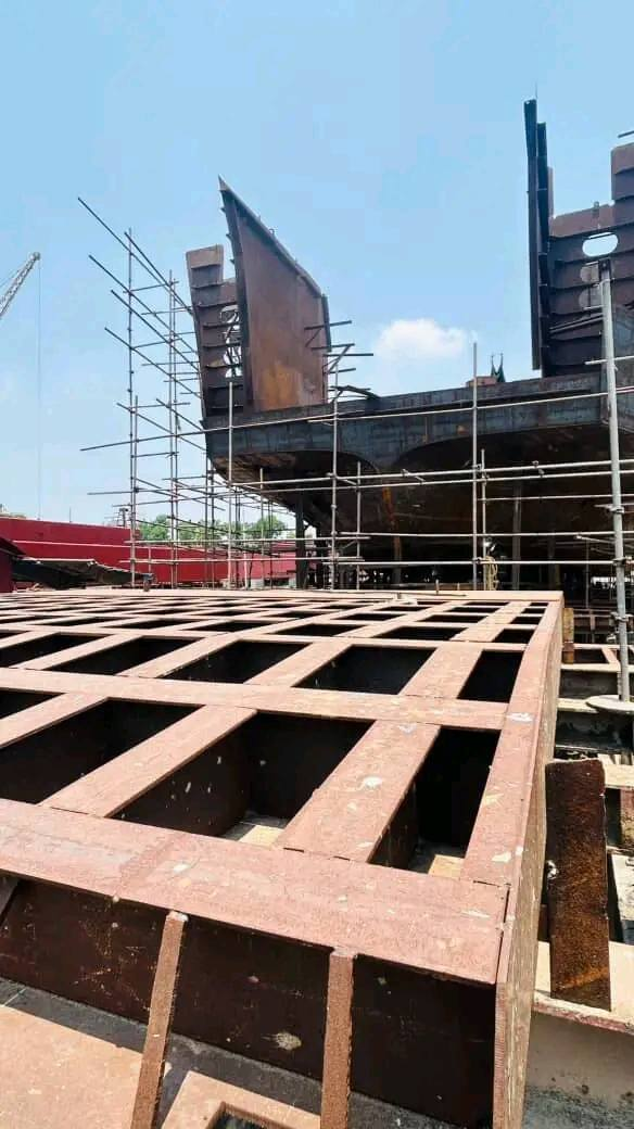

Clear picture of the new LCT. Not clear if these are getting RWS or not.
