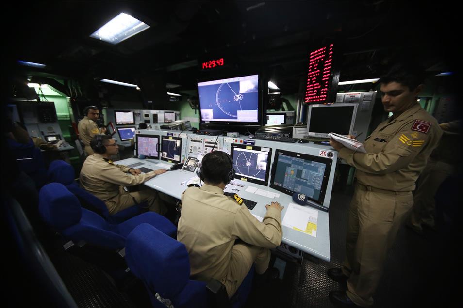

The CIC prior to the GENESIS upgrade. (Havelsan)
The CIC after the GENSIS upgrade shows a dramatic modernization. (Havelsan)

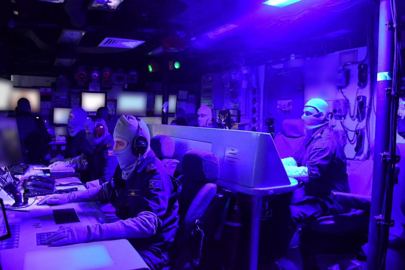

The consoles for the GENESIS upgrade provide an advanced interface for sailors to take the most advantage of the ship’s new capabilities. (Havelsan)
