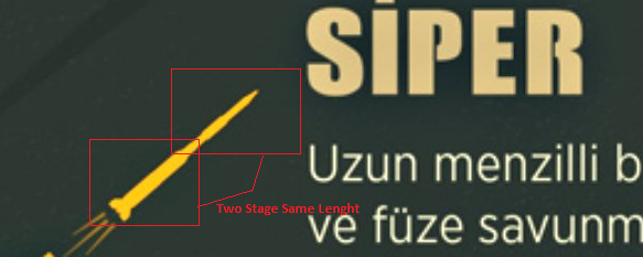

As we see in the concept of siper we can see 2 stage. And lenghts of two stage is same. There two option about first stage of missile. Directly Gökdoğan or 1.5 times more diametered g-40. For two option its first stage lenght will be around 3-3.5 meter. Just because one of them copy of amraam/mica other one copy of essm. İf two stage lenght is same on siper. So it could be 6.5-7 meter lenght. So we can fit him our vls's.
But we can clearly see booster section diameter is more larger than missile section. So that means first stage missile is g-40 there is no hope for quadpack capability on siper. But if first stage is gökdoğan there is hope for quadpack capability on siper. Just because gökdoğan diameter will be 160-180 mm and booster looks 240-260 mm on this condition.

The Siper missile in the innography could be just one example bro, we don't know if it could be double-tiered. In addition, even if it is double-graded, why should it be the Gokdogan it can be something like Barak 8 when we have Hisars.
Yes bro. I had a thinked much more about İnfography. I think if drawer does not see real design he should be draw a missile like patriot or s-300/400. That is very specific. Two stage, first stage like a gökdoğan or g-40 like. On the other hand if that's not true we need a missile like a stated in the post. Other wise we have no options. And we can achieve that kind missile .

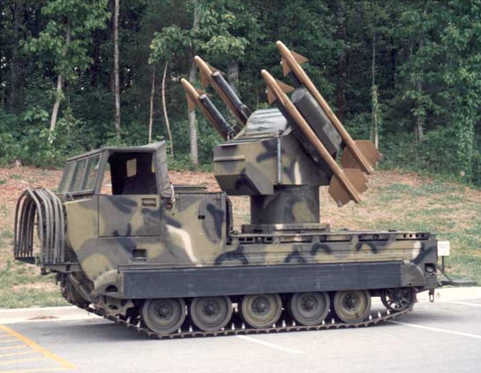

İnstead of sungur , data linked sidewinder derivatives would be better.
Kinda early variant of RAM. What about new Gökdoğan putting on ships?
