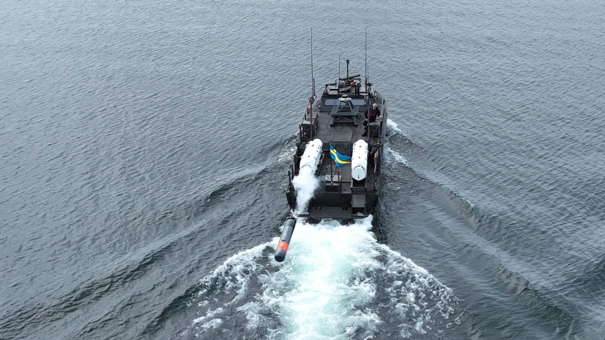

Saab test-fires lightweight torpedo (SLWT) from CB90 Fast Attack Craft
CB90 firing SLWT (FMV image)
The successful test-firings conducted over the stern from two single-tube launchers of the SLWT, also known by the Swedish Armed Force’s designation Torped 47, mounted on the rear deck of a CB 90 does open up new possibilities for integrating the ASW-mission into the mission set the marines are able to handle, or alternatively can be used to allow the Navy to produce a lighter torpedo-carrying platform able to operate either with its own sensors or as part of a networked ASW-effort.
The press release states that the results are currently analysed by the Armed Forces and FMV in cooperation to decide how to best employ these. Notable is, however, that the press release also explicitly states that the tests do show that the combination of CB 90 and SLWT work “very well” together, which might be an indication of what the studies eventually might show as the way forward. Saab, as one parties involved in the test firings, also notably is the company behind both the torpedo as well as the CB 90, following their acquisition of the Dockstavarvet shipyard back in 2017.
