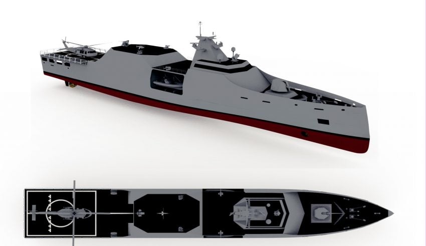

Delta Marine (Subcontractor of Milgem Project, Also cooperates with TAIS):
84 meters, landing platform, RWS (2-3), fore 76 mm cannon.

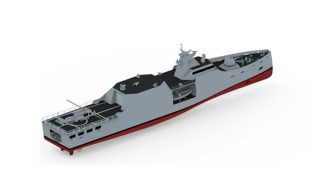

RMK Marine (Contract builder of 80 meters coast guard ships, in collaboration with Fincantieri):
Two versions are presented:
-66 meters, 2xRWS, 1xFore cannon, positions for SAM (Stringer type) 2x2 SSM launchers (Multi Mission Corvette)
