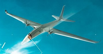

In a way, I think we can also see these developments as Italy's desire to revive the piaggio p.2hh. For Baykar, Italy is in a position to create favorable conditions for it to become a major unmanned systems supplier in the EU market. The collaboration between Leonardo and Baykar has the potential to make a big difference to French and British competitors. From tactical systems to unmanned combat jets, Baykar's product range is already largely ready.
@dBSPL
So, this Leonardo avionics “integrated” line, do you think it will become the key for them to open up the EU door as well as Baykar?
Because I, somehow, got the impression that they would co-develop a new line of UAV/UCAVs, even maybe a stealth one too rather than avionics integration.
