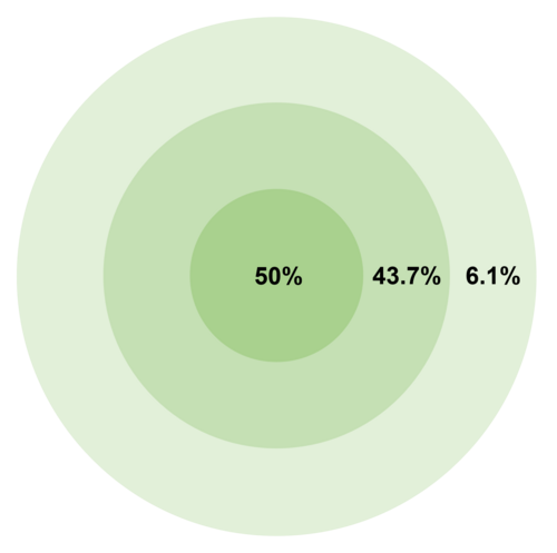

LGK-82 has a a CEP value of around 10 metres.
Teber-82 has a CEP value of less than 3 metres.
(Tolun-P has a CEP of less than10m too.)
So really being laser guided means, these are extra precision hitting missiles.
93.7% of LGK-82s should hit within 20 m, with 50% being inside 10 m.
93.7% of Teber-82 should hit within 6m, with 50% being inside 3m.

Teber 82 just about hits the target. But it is not really representative of a guidance kit that Roketsan states has a CEP of less than 3m. Teber is a guidance kit Specifically produced for precision hits.
TolunP is a complete miss though!
That is well within collateral damage area.
Roketsan gives “less than 10m CEP” for that munition.
that means 50% of missiles will fall within a circle of less than 10m radius. 43.7%. will fall wihin less than 20m radius circle.

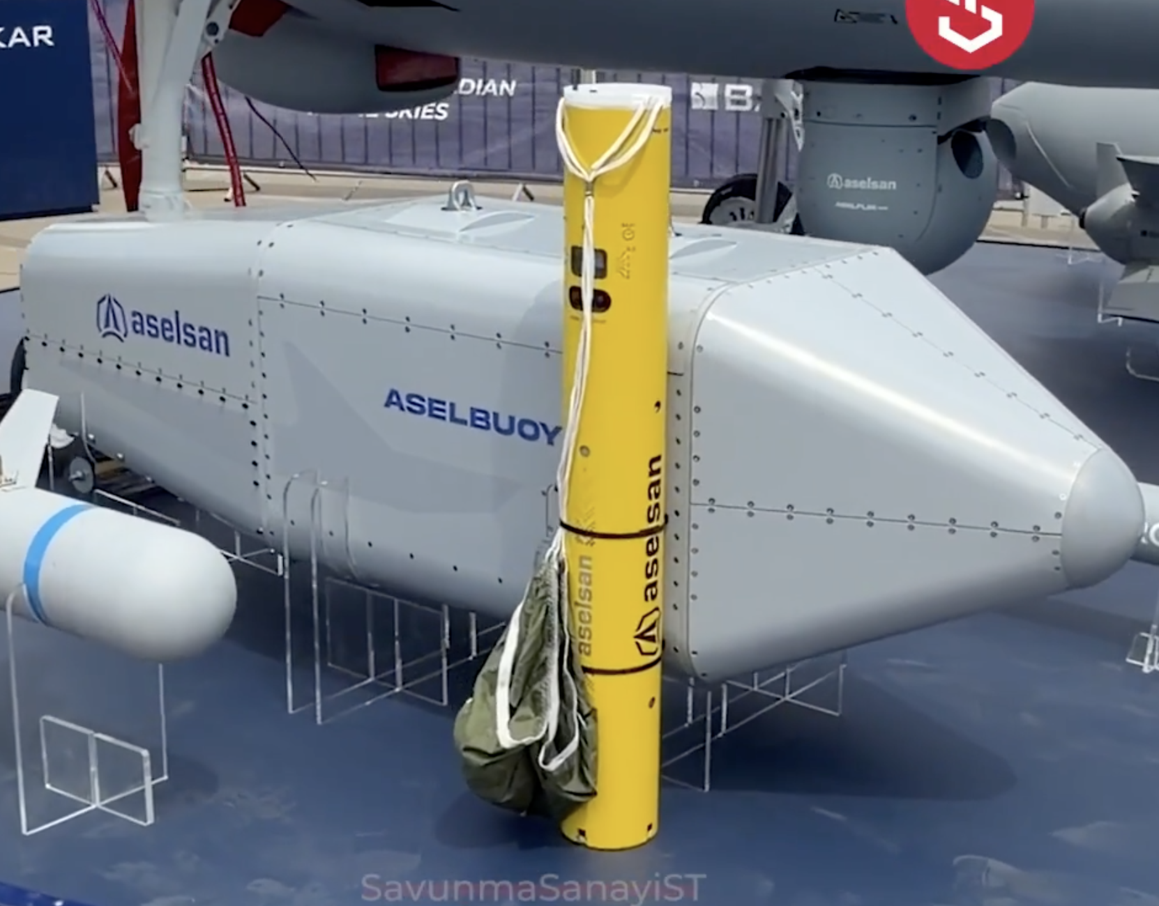

I wonder how many it can carry, I think it can fit 3 stacks of 3 for a total of 9 sonobuoys. Since under the body is out of the question, it must be on the wings and since no one in their right mind would just load the weight under one wing, it must be light enough to be carried under both wings. Maybe 6 to 8 buoys.

Assuming that the TB3 can take off safely from the TCG Anadolu deck with its maximum payload limit:
Hunter (1 UAV):
Electro-optical camera: around 50 kg
Two 4-cell Aselbuoy Pods containing 8 NATO A-size directional passive sonobuoys: around 130-140 kg
Lightweight MAD pod or antenna: around 20-25 kg
Sonobuoy Data Processing/Antenna Pod: around 15-20 kg
Lightweight SAR: around 25 kg
The remaining 280 kg payload margin is filled with embedded ESM antennas (to intercept radio and satellite signals) and an AIS receiver.
Killer (1 or 2 UAVs):
ORKA lightweight torpedo: approximately 220 kg
Mini-EOTS, Sonobuoy Receiver / Data Link Antenna, and a lightweight SAR radar: around 60 kg total
No navy in the world has yet been able to operate a fully autonomous, unmanned MPA/ASW wing from LHD with this level of radar, sonobuoy, ESM, and lightweight torpedo integration.

Sadly both payloads seem to surpass the limits, especially for the hunter which requires a long endurance.
Typically for work-ability we should divide them in three: Carrier platform (sonobuoys), A relay + ESM Node, A SAR platform and lastly the killer platform. The killer should also be agile and flow low&slow near the surface (which suits the TB3 but may as well require additional sensors) to launch the torpedo. Honestly too much of distribution that yields to inefficiency and elevated number of deck operations, which takes us to a new platform. We need a ship based drone with higher payload. Also note that, a few sonobuoys are not sufficient. There should be at least a few dozens laid on the field.
Moreover in doctrinal approach a LHD or AC shouldn't be occupied with ASW operations, it is the logic dictating it. It could support the destroyers, frigates in ASW operations nonetheless and be a relay node for MIMO integration of sonobuoys with ASW equipped ships.
