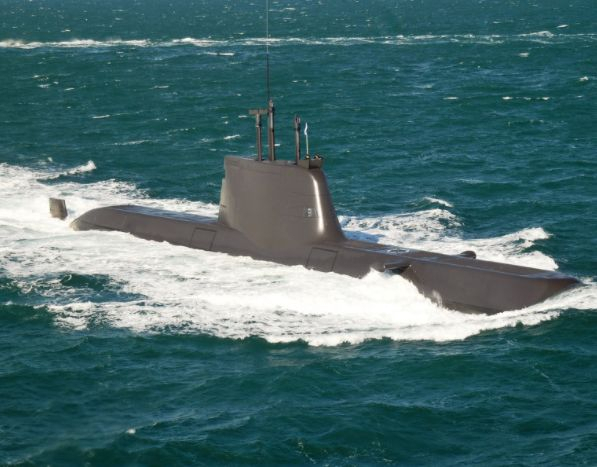

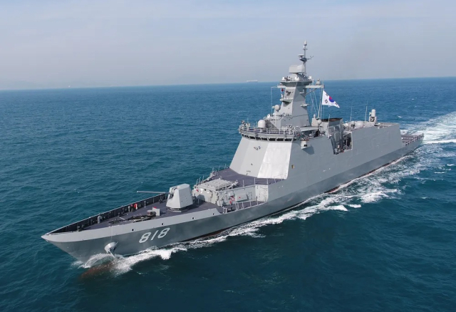

Makin lama makin banyak aja barang bikinan mereka yg bermasalah, kemaren type 214 juga ada masalah sekarang Daegu class
The ICC concluded that the problem with the type 214 was a defective part supplied by TKMS in Germany. As X said in your post, the Daegu-class is problematic, but the claim that the defect is so severe that all eight frigates cannot be operated is false.
A Navy official explained, “Since all eight new frigates of the large class are fully qualificated and in operation, we decided that it was not necessary to stop operation and make major repairs immediately, so we took preemptive action by investing the Navy's own budget, and discussed the problems that occurred with the Radiation Agency and took legal action against Hanwha Ocean.”

An investigation revealed that Hanwha Ocean, which was responsible for the detail design and construction of class lead ship ROKS Daegu, had used low-strength piping materials that differed from what was stipulated in the design drawings during construction, thus resulting in cracks.
No problems were found during the operation of Daegu after it was built, delivered, and put into service in 2018. However, the cracks and related problems began to manifest about five years later.
Nagapasa class case is the same, no problems found when delivered to TNI AL, not long after that problems start to show up, thus there was Operation Readines Enhancement (ORE) program for the Nagapasa class.
Hanwha Ocean said that a subcontractor had, "arbitrarily used a different pipe material [from] what the design drawings specified, and only realised that there was a problem," after an engine fuel leak had occurred.
DAPA argued that Hanwha Ocean had overall responsibility for the subcontractor's management and construction practices, and so there is no excuse for the defects.
DAPA has demanded that Hanwha Ocean shoulder all repair costs incurred due to the latter's culpability.
The request was initially rejected by Hanwha Ocean, and DAPA announced that it would impose sanctions. In response, Hanwha Ocean relented and agreed to cover the repair costs.
Hanwha Ocean will pay the repair cost, as for us? It become our own problems.
Its good that the 2nd batch of Nagapasa class is axed.
And back then several korean members keep talking sh1t towards us:
That It was our fault for receiving the submarine and found no technical problems, and later after we found problems with the submarine its also our fault for accepting it in the first place.
