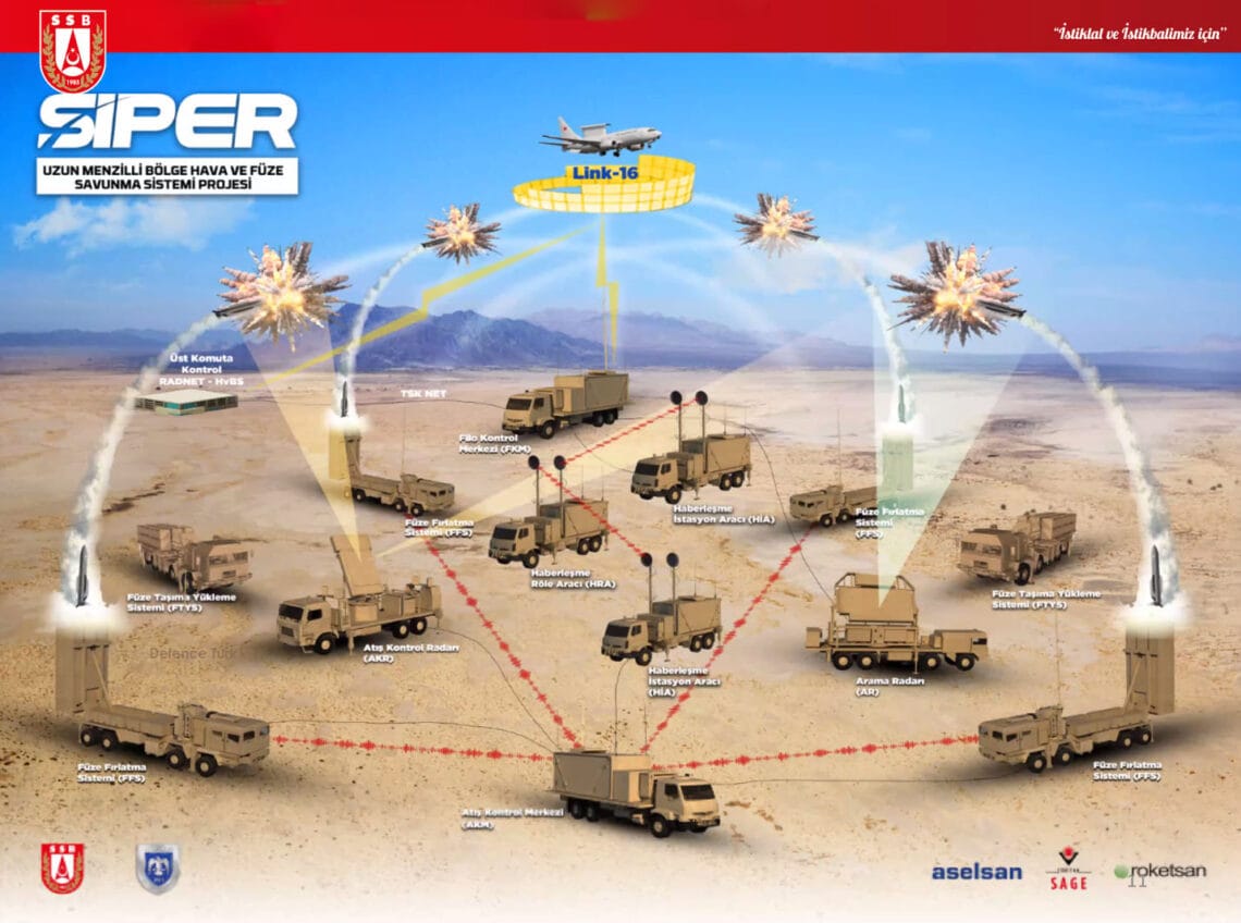

This is what I was looking for. Siper is going to be virtually unjammable with 7 different ways of detection and guidance needed to be jammed by the enemy to render it useless (S-band radar, X-band radar, active K(a/u)-band missile seeker, IIR guidance, uplink, downlink and HoJ).
An almost impossible job by any air platform.

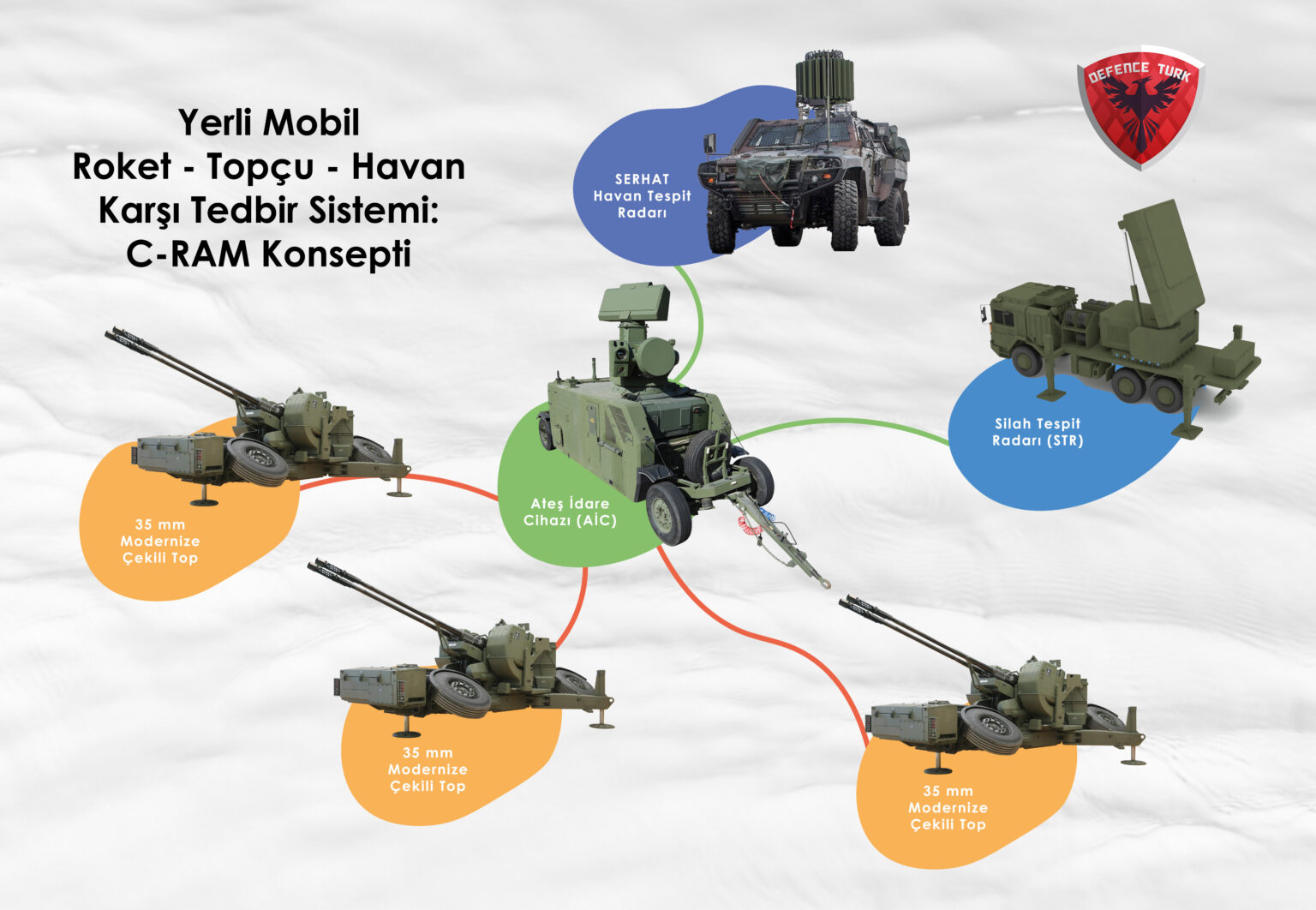

3-4 35mm ATOM MCT (Optimized for C-RAM)
AIC Air Defense Fire Control System
STR Counter-Battery Radar
Serhat II Counter Mortar Radar (Can be integrated with fire control systems)

Twin 35mm Oerlikon gun needs to be redesigned to an single-barrel for improved performance. Concept like MANTIS is the ideal cost-effective solution for us.
We should still develop a C-RAM missile to supplement system like this. For our requirements, we don't need as high performance missile like Tamir.
We most likely going to get a update with IDEF
The STR radar itself is a high value target, a technological wonder that can detect very low RCS targets like shells and rockets. So as you said in the second message, I think 35 mm short range guns should be supported with RAM like missiles and other defensive measures.

Siper is said to have an Ka-band active seeker and will be able to intercept incoming ballistic missiles at 30km. If true, very impressive for an first block/variant of the missile.
I think Tozkoparan will be something like Hisar-RF with an booster. Gurcan Okumus said that it will be "very agile" missile. Maybe we can even make a anti-SRBM variant of it in the future aside from Siper ABM family.

Does any one knows what are seekers used in hisar and sungur missiles ?
Imaging infrared (IIR) for Hisar-A+ and O+ variants and Sungur MANPADS. There is also a Hisar-RF variant that uses an RF seeker. Hisar missiles also have a two-way datalink. Those missiles are in production. The first Sungur and Hisar-A+batteries have been delivered. The first Hisar-O+ battery will be delivered by the end of this year.
A longer-range(~100km) missile named Hisar-U uses an RF seeker and two-way datalink for guidance. It is expected to be ready next year.
150km range Siper missile will use IIR+RF+two-way datalink. It is expected to be ready in 2023. All of the missiles above are designed to counter airbreathing threats. Siper missile will have partial ballistic missile interception capability.
The anti-ballistic missile design and development project is in the concept phase. It is expected to be finished in 2027-2028.
