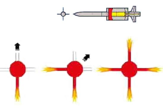

Destruction of a target in the space and the upper atmosphere is very different from the atmosphere. Explosives don’t work or very inefficient so, you need a hit-to-kill target. Winglets won’t direct you into your target, you need trust vectoring. At the end, your new missile won’t be a new block of Siper but, a totally new missile. What you can use in the Siper is the engine section which bring your effector to high altitude.

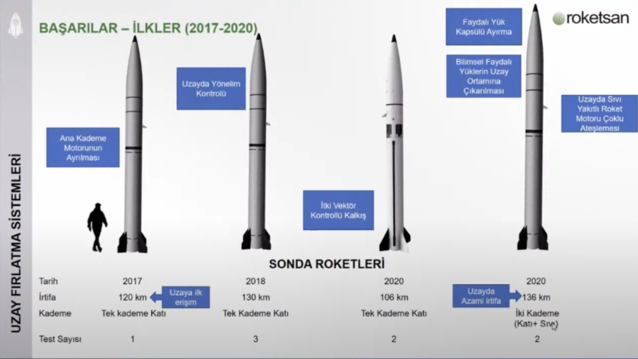

If we can reach Karman Line with sounding rockets, there's no reason why we couldn't develop a missile to take out a satellite or ballistic missile kinetically.

Advanced level Pif Paf Thrusters ? Terminal Stage two or tricolor ıır seeker ? Advanced KV ? Active radar seeker which long ranger enough to reach target without enemy ew ?, power supply for all of that things ? diameter and sizes and kinematic of missile with all of them ? launcher ? etc. etc.
