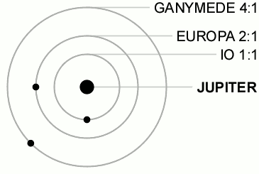

This is a more wide ranging phenomenon in the macro scale too...if you look at Resonant interactions at large, with the studies and works of poincare, hamilton, lagrange, fourier etc.
Take orbital resonances for example:
Looking at just Io and Europa for example (Any example will do, incl the planets themselves around the sun):
Shortest distance found between these two bodies (Io and Europa) in their respective orbits is roughly 250,000 km. At this point in time, they exert (due to their masses) about 4.5 *10^18 N on each other using Gmm/r^2.
If we look at Io, we find its centripetal force (mv^2 / R) due to jupiter is about 4.5X10^22 N.
So basically the latter is magnitude of 4 higher (10,000 times higher).
So a 0.01% relative force interaction (applied with enough consistency and time) is enough to achieve massive resonance lock.
(I did the numbers w.r.t distances, velocities and masses really quick without dbl checking so there is potentially an error somewhere , but the concept holds in general given magnitudes here I have explored before, trust me )
