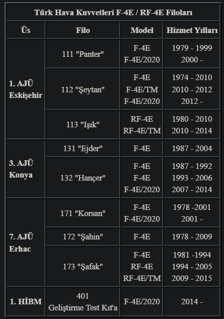

Hi mates. Which Turkish AF squadrons (Filo's) had Phantoms in 1987. and how manny
In 1987, Turkey received 40 F-4E Phantoms under the Peace Diamond V project, which primarily equipped the 131 Filo 'Ejder' (Dragon) and 132 Filo 'Hançer' (Dagger) squadrons at the 3rd Main Jet Base Command in Konya. These aircraft replaced older F-100 Super Sabres, transitioning the Konya wing from a training unit to an operational formation
4,245
127 19,217
That's the second(or third) batch.
This should be the full squadron listing:
So, Panter(Panther), Şeytan(Devil), Korsan(Pirate), Şahin(Hawk), Şafak(Dawn) which originally operated F-4s but then transitioned to RF-4s, as well as Ejder(Dragon) and Hançer(Dagger). So that's 7 F-4 squadrons in 1987.
