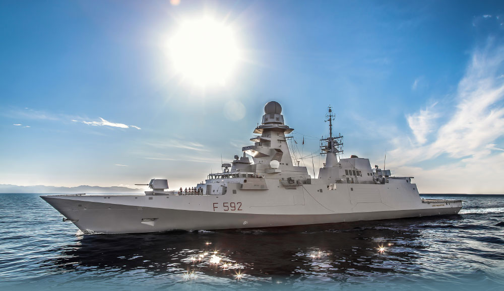

The appearance of the Italian FREMMs is heavily influenced by previous La Fayette class ships commissioned by the French Navy in the 1990s. The vessels' design reflects the attention to stealth that is apparent in all modern frontline warships. The VLS modules are placed in front of the superstructure just behind the ship's main gun. The small mast on the bridge houses the fire control and surface surveillance radar, and just behind it, the mainmast of the vessel rises, featuring two small exhausts on its either side. Resembling a Padoga, the most eye-catching systems on the mainmast are the Kronos radar inside the spherical radome at the top, and the ESM sensors immediately below the radome with a collar of IFF antennas positioned slightly lower down.
The 25mm autocannons are located on the same deck with the bridge on either side of the mainmast. The launchers of Teseo or MILAS missiles are placed between the mast and the main exhaust funnel. Against air and underwater threats, two OTO Melara SCLAR-H decoy launchers are positioned abreast the funnel on both sides of the ship. The antennas of various satellite communication systems are installed in the area between the exhaust funnel and the 76mm gun mounted on the starboard roof of the helicopter hangar. The ships also have two positions for rigid inflatable boats (RIBs) located to port and starboard of the main exhaust funnel. The 76mm gun on the helicopter hangar has an approximately 270-degree continuous firing arc thanks to its elevated position. The flight deck is located at the stern of the vessel and incorporates a Curtis-Wright TC-ASIST recovery system to assist safe handling and recovery. The ASW type ships have a variable depth towed sonar array housed in a room below the flight deck.
