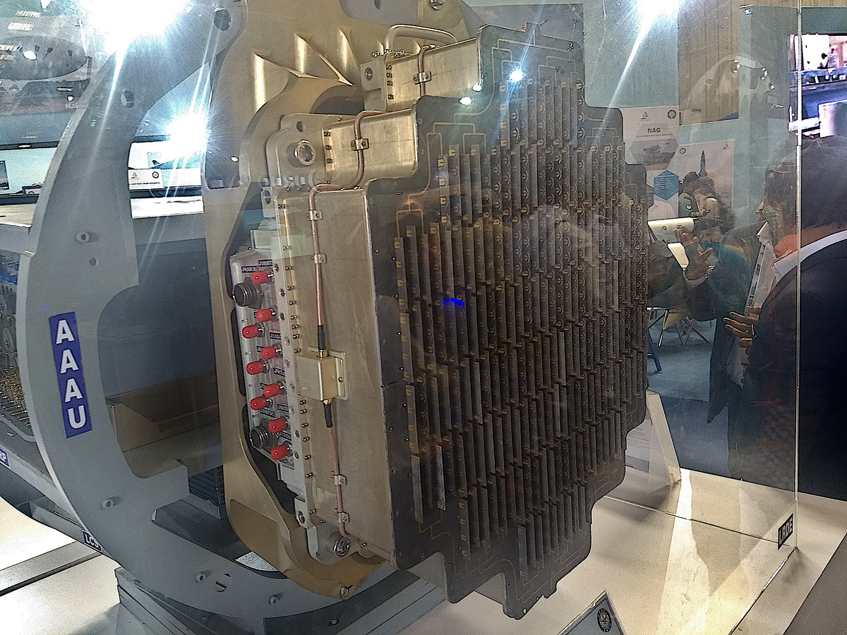

Basically It will be a medium weight multirole fighter with Indigenous AESA Uttam and IRST. Will have 11 hardpoints and will be able to carry Brahmos NG. In major components and weapons, apart from engine, pretty much everything will be Indigenous. Atleast this is what expected at this stage.
This is Uttam. Already Integrated to one of the Tejas airframes and trails are going on currently.

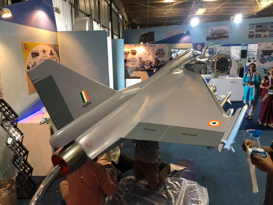

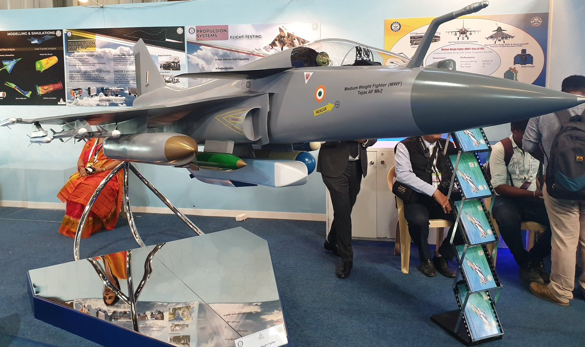

On a high level note, the MWF is an enlarged version of the LCA with enhanced range and capabilities.
Here's a basic spec comparison between the two
Spec​
LCA​
MWF​
Length13.2m14.6m
Wingspan8.2m8.5m
Height4.4m4.86m
Wing Area38.4 sq.m44 sq.m
Max Takeoff Weight13.5 tons17.5 tons
PowerplantGE-F404GE-F414
Max SpeedMach 1.6Mach 2.0
Range1850km2500km
Combat Range500km with internal tanks1500km
Ferry Range3200km with 2x external tanks3500km with two drop tanks
Service Ceiling50k ft50k+ ft (to be confirmed)
g limits+8/-3.5+9/-3.5 (to be confirmed)
Hardpoints811
Guns23mm Twin-Barrel GSh-23 cannon23mm Twin-Barrel GSh-23 cannon
The current LCA Mk-1s in production uses the Israeli Elta EL/M-2032 multi mode radar. The initial batch of LCA Mk-1A will use Elta's EL/M-2052 AESA Radar which will be replaced by DRDO's Uttam AESA Radar and the same will be used on the MWF as well.
The MWF will also sport indigenous infrared search and track, missile approach warning, internalized integrated EW suite, integrated life support system-onboard oxygen generation system (ILSS-OBOGS), increased payload capacity, network centric warfare and wide area multifunction display systems
Structural changes include overall increase in airframe/fuselage size, addition of close-coupled canards, increased hardpoints, retractable air-to-air refueling probe, modified spine/air-intakes/canopy shape, reduced radar cross-section, twisted air-intake ducts and extensive usage of radar-absorbent materials

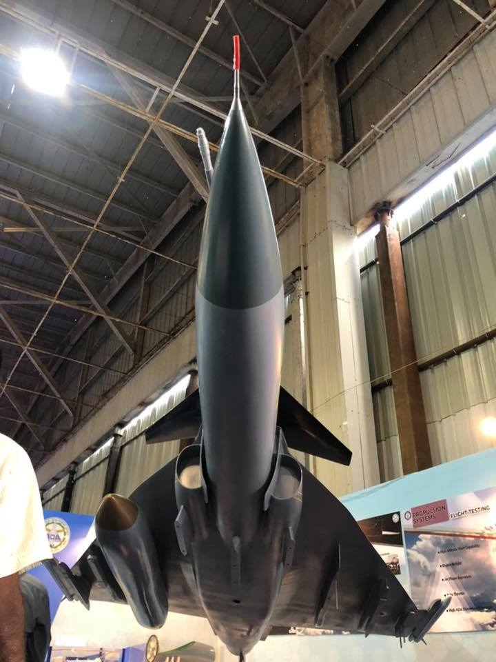

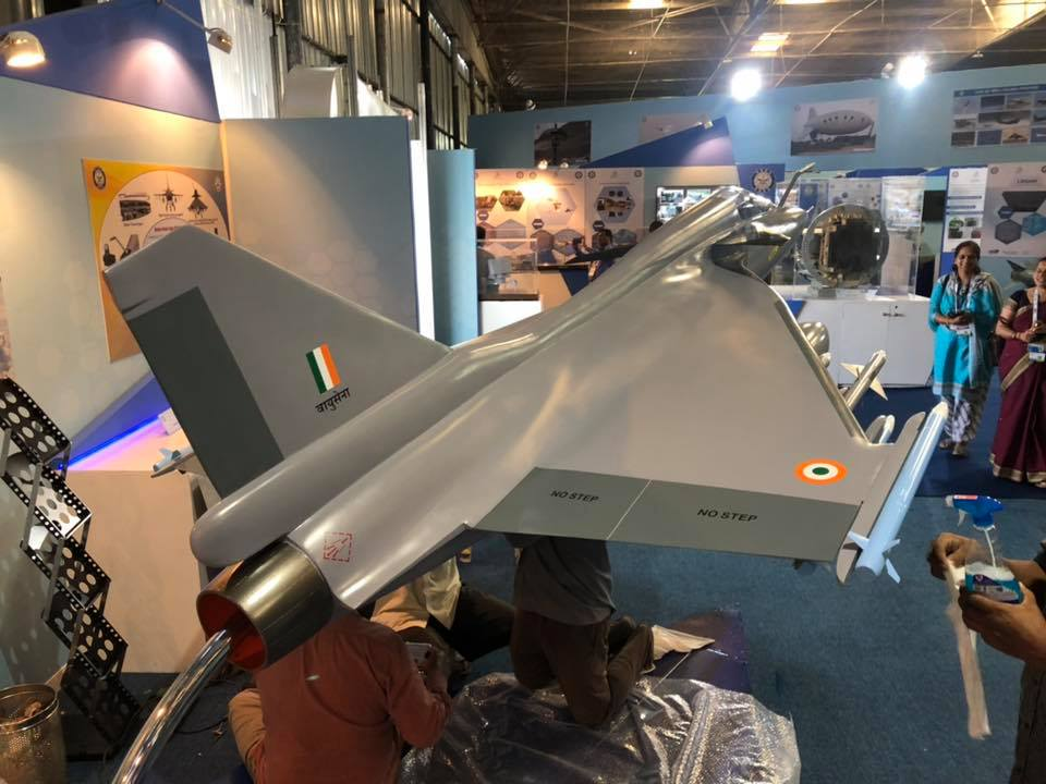

Tenders coming out of HAL for manufacturing of Tejas Mk2 are very informative :
No more custom-made TDs, PVs, LSPs. The very first LSPs for Mk2 will roll out from a standard production line (as stated by ADA chief and HAL Chairman). The three sections of the fuselage, the two wings and the fin will be made by Tier I private suppliers.
Fuel tanks and their respective capacities :
