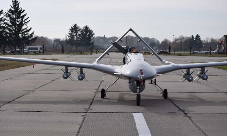

MOU for KSA ??
UAE/KSA possibly
There have been various rumors UAE is shifting out F-16E from service within decade. F-35 purchase was meant to complement and replace F-16 and that was 2020. F-35 isn’t going to happen and they don’t want something that is QMEd to death.
There was something odd I saw when MBZ visited Turkey.
Saudi Arabia needs Tornado replacement. EFTs and F-15SAs are here to stay for now.
