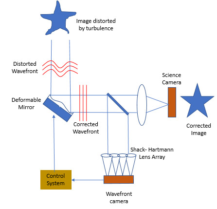

Telescopes that look up into space use "adaptive optics" to deal with the ripple effect of the moving atmospheric gasses. Do recon satellites use something similar to that to look down on Earth?
Yes and no.
The medium (atmosphere) in between is of course the same, so overall obstacle conceptually is the same at top tier system layout (and broad science) and solution.....but lot of things are different (that come into play in big way below block diagram for example, in specific science and engineering):
- Imaging requirements (distances and aperture involved, and resolutions needed)
- Volume and mass budget, very different for an optical system on the ground that can be sized outward with little restriction and far more ease compared to space system you need to launch at mass/volume and thus severely constrained
- Direction of the imaging....ground based system is immersed in the atmosphere and looking out into space past it... this also creates a different design driver for the optic and optic control compared to having a system in space looking reverse way...this is related to aperture that I mention before too...as basically you get a different intensity and pattern of the turbulence/scintillation effect in the raw ray-modelling that you account for in the control/post-processing algorithms.
- The material/objects of note also must be considered...these vary greatly between the two...given scattering and other effects of light on a close planetary system (compared to far field imaging for deep space, milky way or solar system etc). This can often trump the atmosphere consideration altogether as bigger design driver (sometimes often to the near-exclusion of it given heritage known science baked in), it depends on what you would like to image the most and how you would like to proceed imaging it...especially the more real-time and even dynamic imaging requirements you may have.
Hopefully a bit later I can bring an expert (good friend of mine) to talk about these more here down the road. I have limited knowledge on it.
My own expertise on it was different thing than the optics per se... I was working on the heat/thermal side of it and some vibration considerations too. That is lot less interesting subject overall to many, but it is also very transferable side...as now I dont work in satellites anymore at all.

Yes and no.
Nice, thanks for the info @Nilgiri it'd be nice to have your friend contribute to these topics at the expert level.
