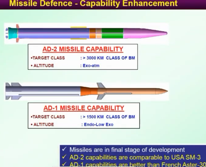

Nice chart on where everything falls in the US terminology as of 2017:
can you explain doctrinal logic behind AD 2 type capability ? because it seems to me, at the it will become operational, HGVs will take over the role of MRBMs.
HGVs are too shaky at the moment as a definitive system on which deterrence can be built. They are in the same league as Railguns which everyone thought would be the future and that fizzled out because they are too complicated to be reliable.
Just like SM-3 isn't going anywhere for a long time (there will undoubtedly be future Blocks), this class of interceptor has a long future.
Even with HGVs, the future developments will focus on changing up the type of Kill Vehicle loaded on these ABMs (taking cues from existing Midcourse & ASAT developments) to include likes of maneuverable or multi-object KKVs. The booster & missile itself will still be needed to get the KKV where it needs to go.

I would describe the AD-1 as roughly equivalent to the Aster-30 Block-1NT/Block-2 and SM-6. It would form the lower rung of the BMD Phase-II program with regard to range & altitude, and will primarily be aimed at intercepting missile threats inside the atmosphere. The higher rung would be formed by the AD-2, which is still in development and is in the league of SM-3 with theatre-level BMD capabilities i.e. interceptions outside the atmosphere.
The two systems (along with supporting next-gen radars) form Phase-2 BMD and will see both land & ship-based use. The vessel INS Anvesh is already outfitted to carry out tests of theses BMD missiles in combination with new radars & combat management systems. If you recall, Phase-I was a technology demonstration phase under which several ABM platforms like AAD, PAD & PDV together with their support systems were developed & tested over the last decade. Phase-II represents the development of fully operationalized capabilities based on the lessons learnt from Phase-I tech demo.
