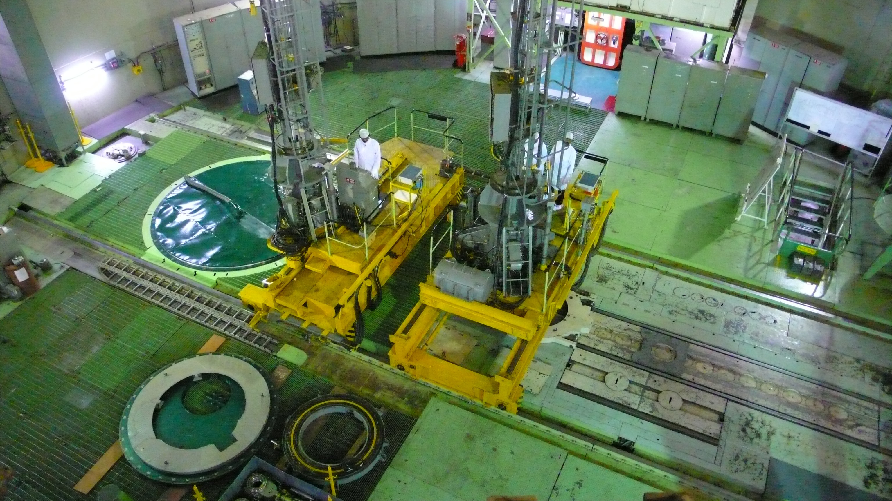

The Fast Breeder Test Reactor (FBTR), the precursor to the PFBR - Commissioned in 1985
