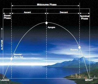

There's no such thing as pure ABM. An ABM works like ABM does but divided in which phase the interception occurs.
main-qimg-04e54c9996c0c4f0bafcd8669609de37-lq
intercepts happen in either this phase :
  1. Boost
  2. Mid-course
  3. Terminal
what differentiate ballistic missiles are the height of its apogees, the higher the apogees the longer reach it has. Now for maximum safety you might want to opt to kill ballistic missile as early as boost phase followed in midcourse if interception failed in boost, and Terminal phase would be your last chance to kill before the payloads rain down on you.
Now we can't do interception in either boost or midcourse, why not ? for one because of geography, even if we have the necessary ABM to do the job we don't have any host countries willing to host our interceptor missile so far further away from us. Because hey hey ...
So for now, boost phase interception are ruled out from the very beginning.

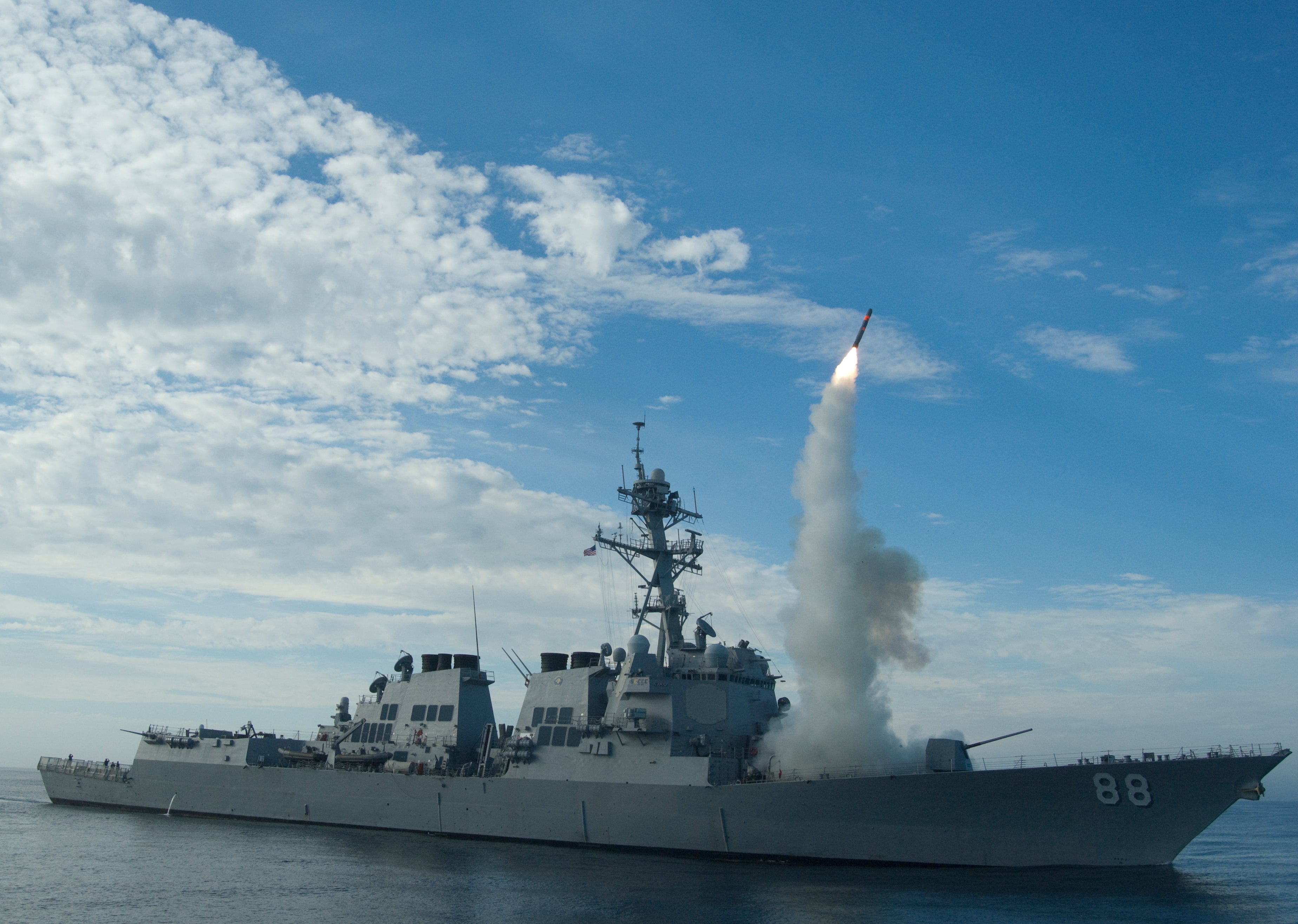

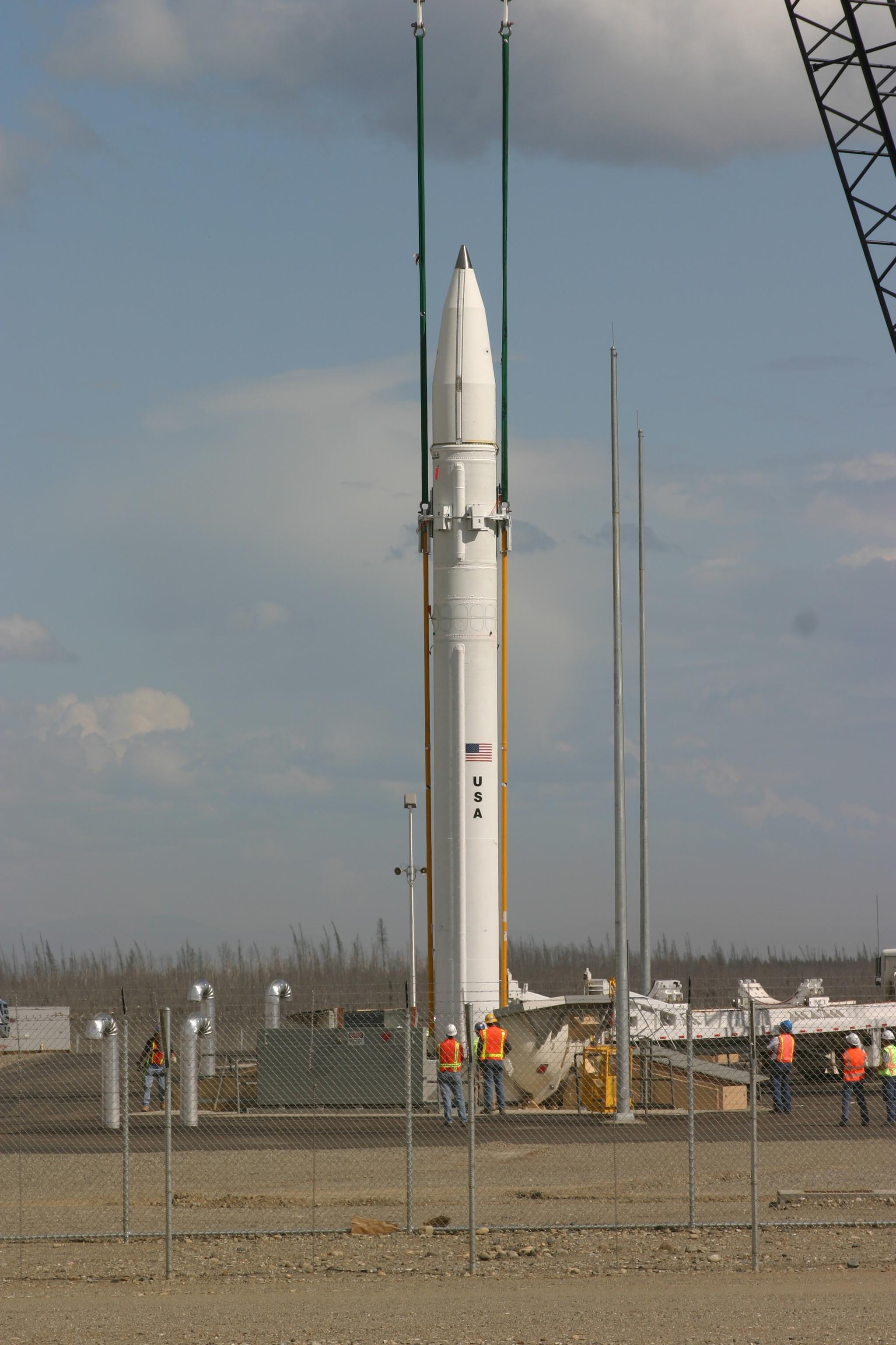

In midcourse, geography aren't really much of a problem. You just need the money, technology and around $500M to throw around per interceptor trying to kill a ballistic missile its apogee with around 56% chance to hit. Something like this.
Hence we only have one option left to try our luck killing a BM. during its terminal phase, which means the missile are now plunging right into you. The current solution in the Terminal phase on sale right now ranges from the IRBM capable THAAD (or soon to be ICBM capable THAAD-ER), or SRBM capable solutions like the ASTER 30, PAC2/3, S300VM.
SO what we do now ? There's only 3 out of 7 of our Asian neighbors that deploy ballistic missile capable of cratering our land (CN,INDIA,NK) the other 4 like Vietnam or Myanmar are too short legged or with questionable accuracy. If China, India or NK were to lob missile at us it would be either an IRBM or an MRBM, none of which are capable to be intercepted in its terminal phase by ABM system on offerings.
So what's even the point ?
And then there's the issue of cost..........how many interceptors we could afford ? on the contrary we could happily buy hundreds of AMRAAMS for NASAMS.
