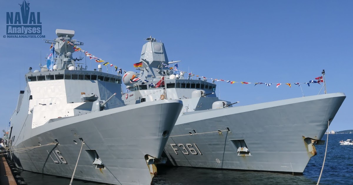

i guess i better repost the pict View attachment 45173
So that's why, they insisted with 143 meter version, hadeeeh....
This Remind me to Maya or Takao back then when the bow section of the boat consume more than 1/3 of boat total lenght. Thus, will make the steering ability gain more challenge in narrow strait or pier.
Twin 76,2 mm gun ? I think they still put option to go rogue in the table when the missile is run out.
Joke aside, i hope they put Kronos or somewhat equivalent in our 143m Vrygate derived from AH 140
The design is more similar to IH rather than AH, but with a little touch of Damen's SIGMA.
They tried to make it looking like AH140, (covered the top deck and missile bay and changed to 2x8 VLS)
Added a 5+ section to the forward section for VLS however i strongly doubt if they can ever fit a long VLS especially the ones on the most-starboard/aft ones there.
Tried to keep displacement around the IH after elongation and lowered the draft by 0.3
