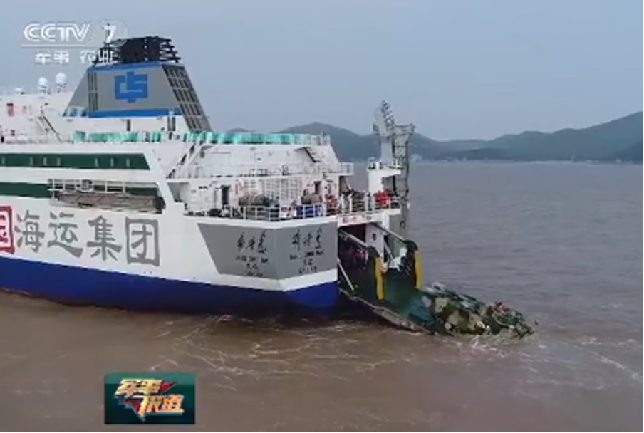

China is ahead in this case
We can modify our current and future LPD ramp door with longer and stronger ramp door that extends all the way to the water.
Even with civillian RoRoship?
All 'Civilian' ferries in China built in the 2010's and after has military sealift capability in mind. Something that we could copy. CMIIW after China and Japan, we're like the largest ferry operator in Asia.
Government could kickstart mass national shipbuilding industry replacing our many second hand Ro-Ro ferries using local ships built within a specific requirement that those design has military compatibility in mind. In peacetime good for inter-island transport, in war good for logistics and material movements.

Not to mention, isn't Ro-Ro's rampdoor's job is to do that on a daily basis? Now Idk the details, but a loaded Mitsubishi Canter would weigh more than a BMP-3, would it not?
3,538
5 3,210
Yes but it will connect to the pier/ land, but how about a ramp door that is extended all the way to the water?

The only viable option without endangering the crew within zaha/AAV would be an elevated floor .... Without that , the ramp angle would be too steep it creates a lot of more trouble than it's worth
# 1 example ... How much traction it would required for a fully loaded AAV to board up into the ship during a wet sea state 3 ( minimum !! ) and 19° angle of slope ??

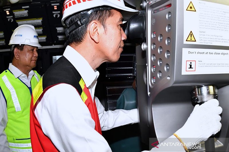

10. The screen table you see here
Is Navigation Command Table, provided by Anschütz GMBH

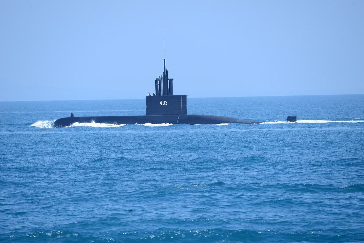

The Korean Chang Bogo I (Type 209 1200) is bought in late 90's with license built and modification, but still retain the orginal 1200 ton dimension, 56 meters
* The flat deck above the waterline doesn't have any specific name, and according to some source, it just called as "upper casing"
** The upper casing hold some tanks, piping, equipment storage, and electronic stuff, as shown here
and also here, the Type 212A German Navy
The ID Navy Chang Bogo is different, the hull is streched to 61-62meter, again, to accomodate more sophisticated equipment (both mechanical and electrical) and better storage.
While Nagapasa Class is in subclass of Type 209 1400ton. It is notably different from the same 1400ton class the original manufacturer built. The HDW (now owned by Thyssenkrupp Marine system) built has adopt some of the newer and more aerodynamic approach, especially the sail design, now is much bigger and wider, so there is no little pathway connecting from the forward to the stern
* i had to adjust the upper picture by reversing it so that it poses in similar direction with the lower one
**this comparison is Nagapasa class with newer Eqyptian Type 209 Mod1400 TKMS
As you can see, the Nagapasa class has still retain the original sail design from 1200 ton, it is proved with the same sail door position
But the TKMS built has the door on front side of the sail and on the rear right side, just like the Type 212 and 214
Another thing is the TKMS sail tower is slightly a little bit on forward position compared to Nagapasa,
this may not give any different in performance, but only fitting to the design of control room, as we understand, the control room is very cramped in space and utilized in very efficient way in placing such equipment, it is possible that if the periscope is positioned a little bit forward according to the arangement of control room (remember that the periscope is the only "pipe" that penetrate through the hull upwards to the conning tower)

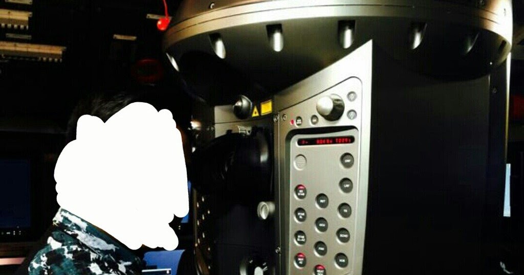

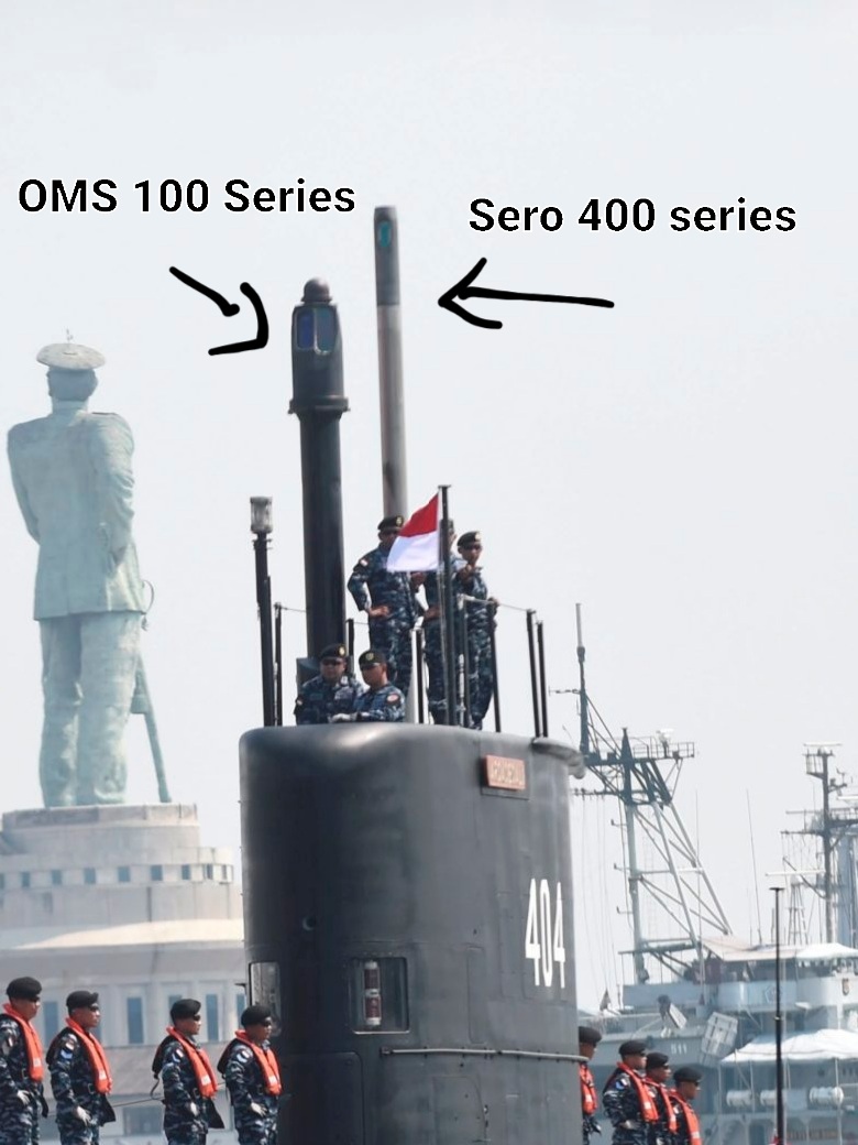

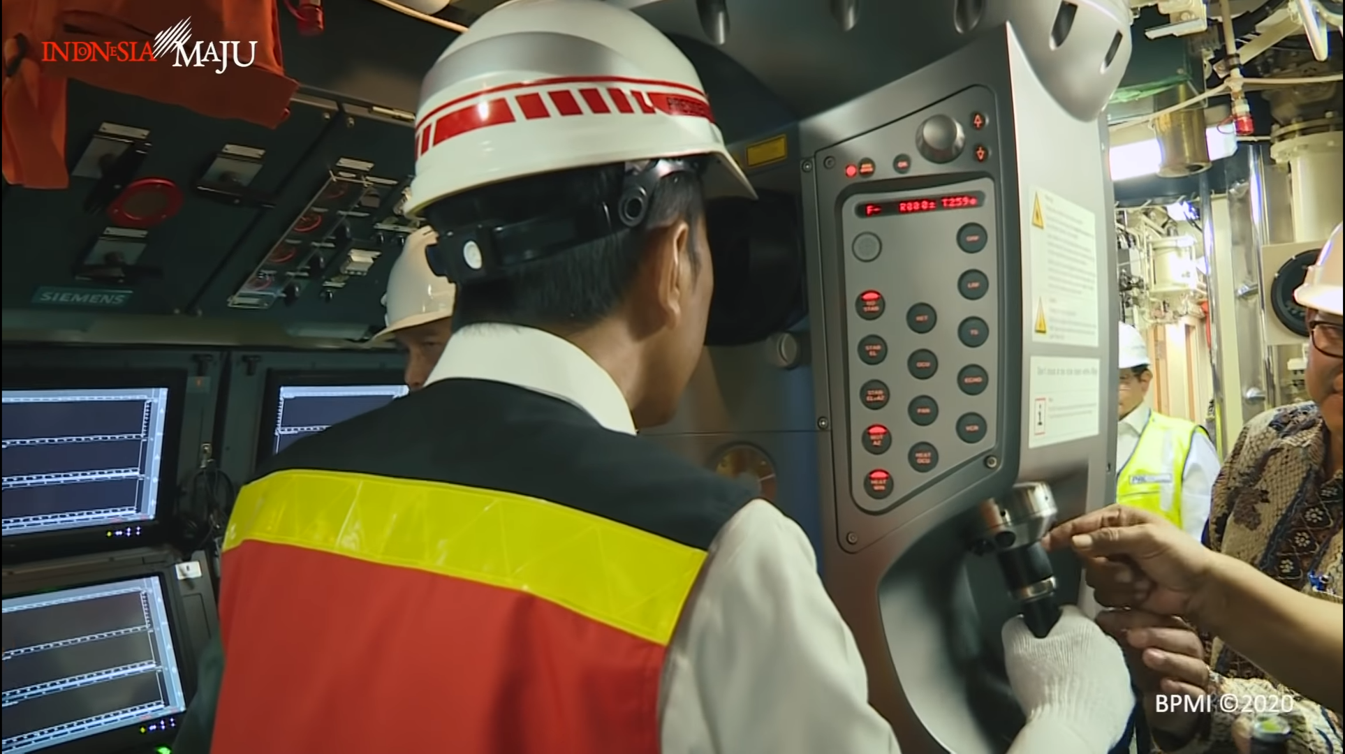

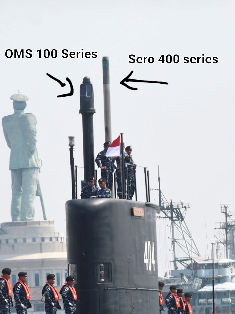

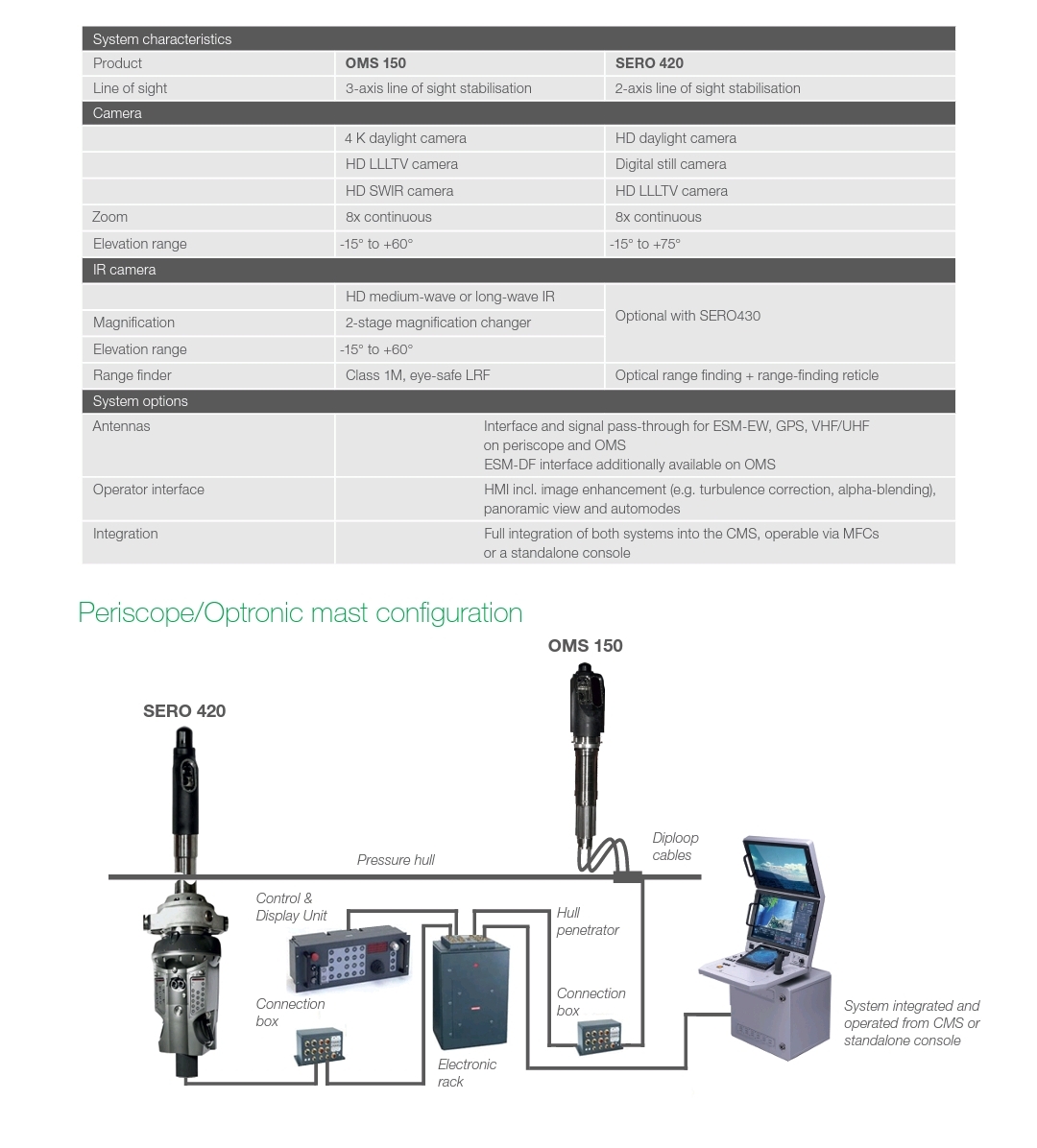

It's half right, but i have to correct this, we still use the conventional periscope, along with the non-penetrating periscope (they called it Optronic Mast ((optical electronic))). The vendor choosen for this is the old player in periscope business, Hensoldt AG.
The Sero 400 series and OMS 100 series is used in this submarine

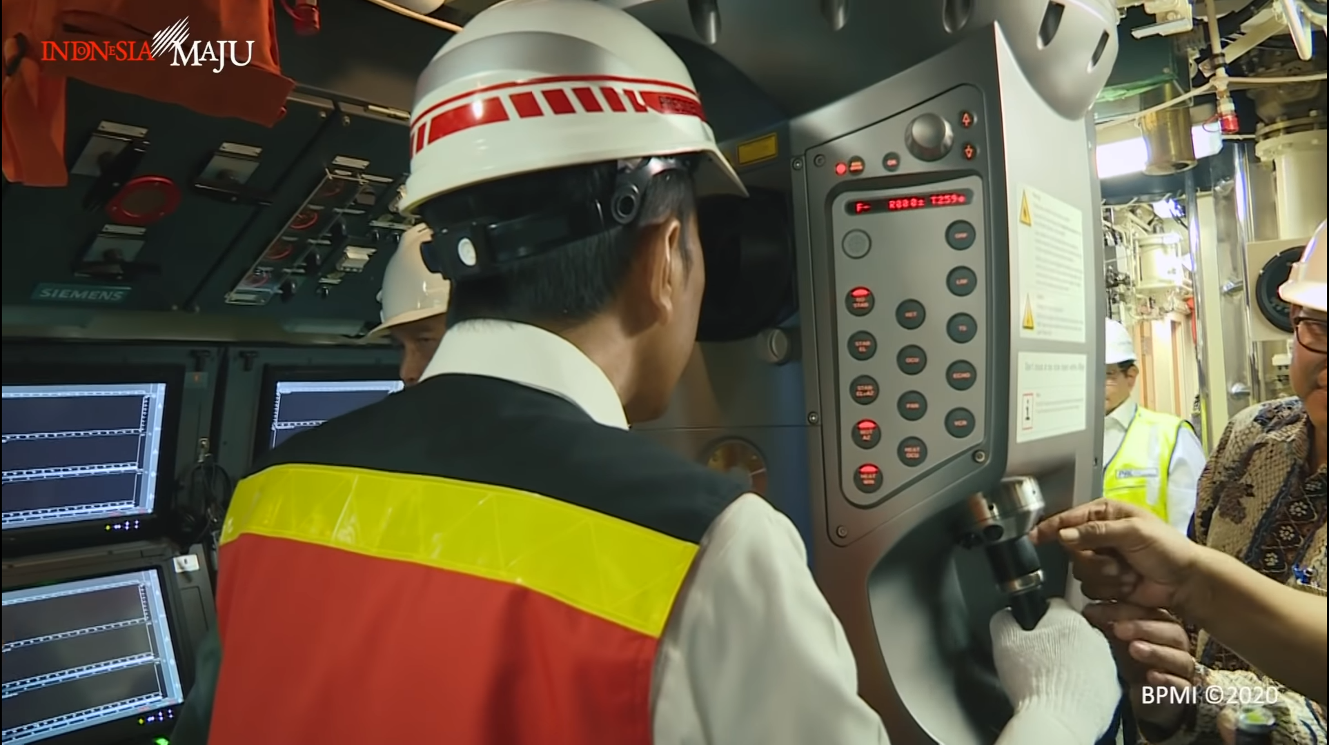

in this picture, Pak Dhe is using the Sero 400 series, this is the conventional periscope

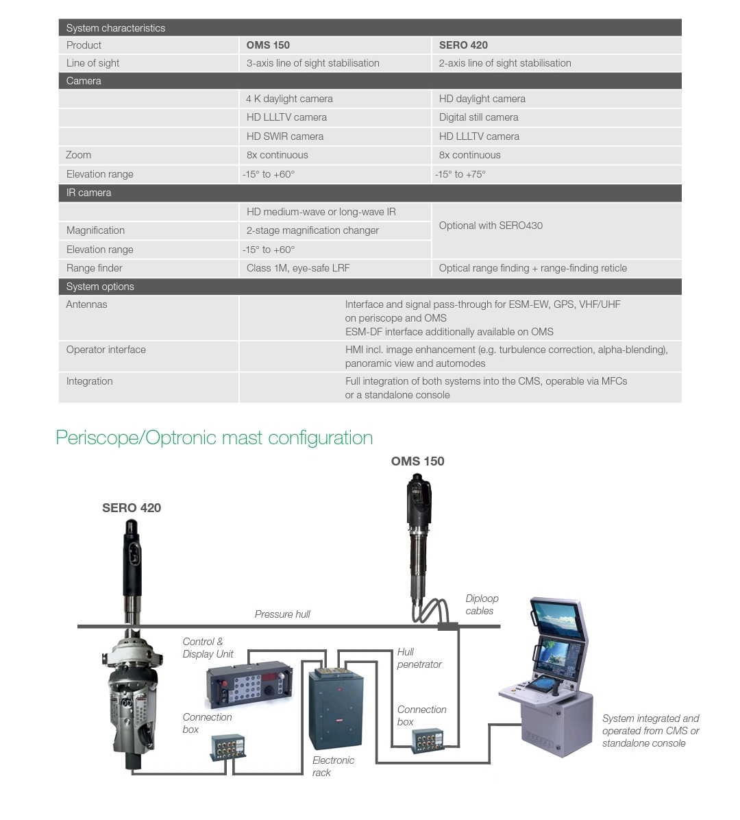

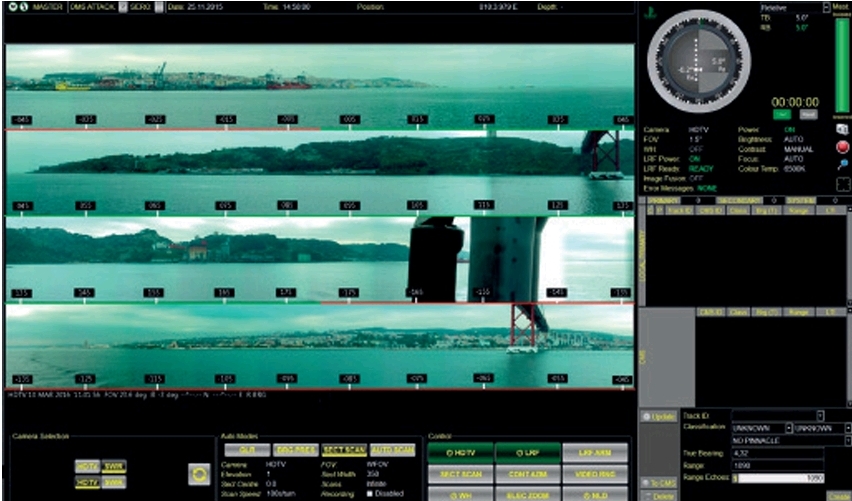

The other one, OMS 100 series is non-penetrating periscope, as you see in this chart

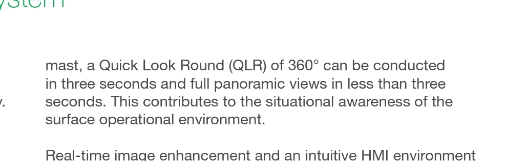

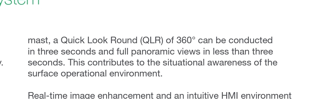

The Optronic Mast it has unique features
The existence of this periscope, SERO and OMS is confirmed here

Adding to this, our Nagapasa-class uses Non-hull penetrating mast for their periscope and sensor. So there are no 'pipe' that penetrate the pressure hull to the conning tower on these boats.
20230606_143232-jpg.57989
From the blueprint the periscope is penetrating the pressure hull.
The other one, OMS 100 series is non-penetrating periscope, as you see in this chart View attachment 58530
The Optronic Mast it has unique features View attachment 58531 View attachment 58532
I stand corrected, forgot they also get the SERO other than the OMSes,
