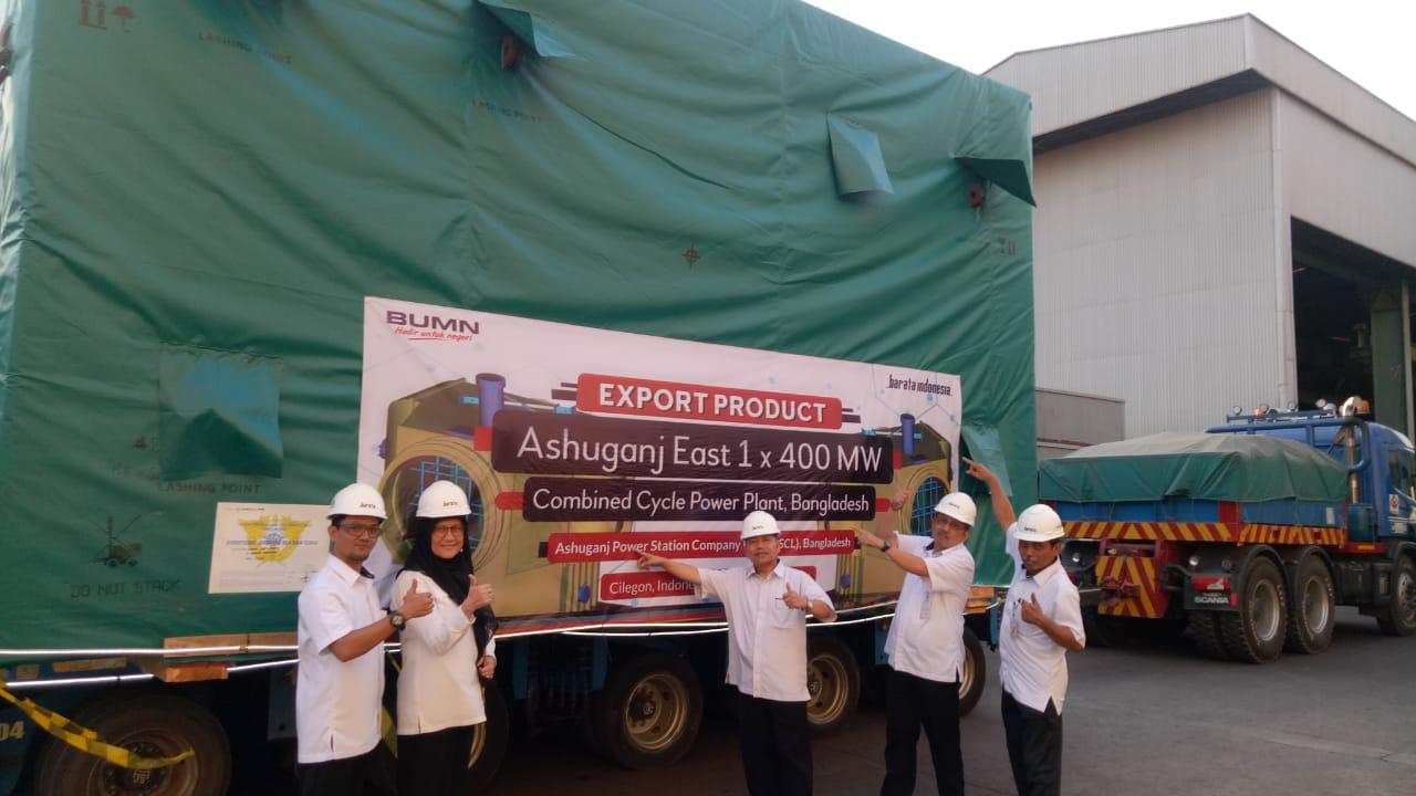

PT Barata Indonesia
Translation:
PT Barata Indonesia (Persero) has won a new contract for the turbine component of the Java 9 and 10 Steam Power Plant Project in Cilegon worth Rp. 187 billion. In this national strategic project, Barata Indonesia supplies the main components of a steam turbine with a total capacity of 2x1000MW.
"We are also proud to continue to take part in national strategic projects by supplying the main components of turbines whose quality has been recognized to five continents," said Bobby.

The above mentioned Gas Turbine component is a Silo-type combustion chamber for gas turbine. Whilst, for steam turbine component is the condenser housing's outer wall at the outlet of the steam turbine it self.
Hopefully in the future can manufacture the axial compressor & turbine section, as it is the most precision and complex design section.

Do you mean this one ?
PT Barata Indonesia (Persero) exported turbine components for power plants produced by the Turbine Component Plant – Power Plant Division, Monday (11/11).
The product being exported this time was a Condenser (with Axial Exhausting System) with the destination country of Bangladesh. This power plant component will be used for the 400 MW Ashuganj PLTGU PLTGU project to replace the existing 150 MW PLTU capacity.
The 400 MW PLTGU Ashuganj PLTGU Combined Power Plan is planned to produce an efficiency of up to 58.76%. The power plant which will start operating in April 2021 is expected to support the Bangladesh government program in providing an increase in electricity supply of up to 20,000 MW for the entire territory of Bangladesh.
In this project, Barata Indonesia undertook the work of making condensers for 10 months by absorbing 7500 working hours

Yes indeed, for the utmost secrecy things between gas turbine's manufacturer in their product is the alloys that they are used.
The Aerodynamic, thermodynamic, as well as rotor dynamic of gas turbine are the things we can pursue and optimized even by our own endeavor ( not to mentioned with sophisticated state of the art software technologies available in the market for computational design and modelling ).
The main limitation in designing or developing more advance gas turbine are the material technology and the turbine cooling technology. We could have designed in the paper more efficient gas turbine, for example, by increase more compressor pressure ratio and burn it the higher temperature. But, what materials or alloy can withstand such higher temperature ? (concerning the current firing temperature is already high, let say 1200 -1400 Celcius), how to design the turbine blades and disc cooling path so that it can run in a long periods of time?( we are talking about 30,000 - 40,000 hours of operation), not just in hundreds of hours of operation than it will disintegrates .
The alloy at all section will be expand and shrink, back and forth, in a wide range of temperature ( from ambient temperature to over thousands of degree Celcius) as the engine will be in start/stop frequently. Designing such highly precision "fit and clearance" dimension all over the parts of gas turbine is already a big headache
What I can see from pictures above from Barata, we still have very limited expertise in the making of gas turbine, as it just capable in manufacturing "the skin" by far, whilst the "flesh and blood" and to "the bones" of the gas turbine it self still out of reach by us.
Like I was written on my previous postings, gas turbine is not a rocket science....it is more than a rocket science.

The Power Division, through the Turbine Component Factory in Cilegon, exported power plant components on Friday, April 16, 2021. This time, PT Barata Indonesia (Persero) exported the components of the Silo Combustion Chamber power plant to Zhoushan, China.
The main component of the gas turbine (Combustion Chamber) will be used in Zhejiang Petrochemical Co.'s Zhoushan GT 20 project. Ltd. Do you know #baratizen, all components are made using high quality steel raw materials supplied by local companies. This is in line with the company's mission to continue to improve the competitiveness of the national manufacturing industry through a commitment to the use of high local content.
