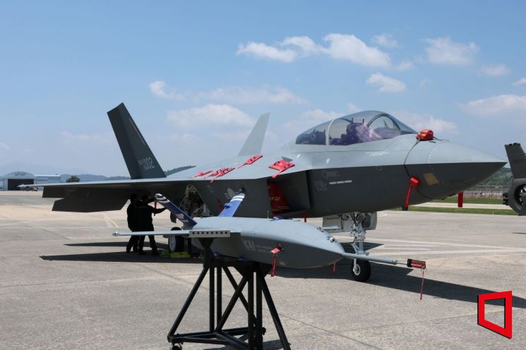

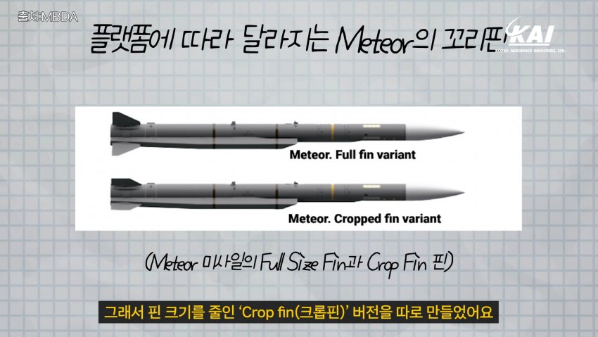

Can it bring 4 meteors internally?
urban mine
825
62 1,746
South Korea
South Korea
Yes. I understand that's the plan.
Probably to wide because of the fins
The KF-21 underwent launch tests using a Meteor cropped-fin variant from the very beginning. Since the future LRAAM will have a shape nearly identical to the Meteor’s, I believe the IWB will be developed to reflect this as much as possible in order to ensure it is capable of performing effectively.
