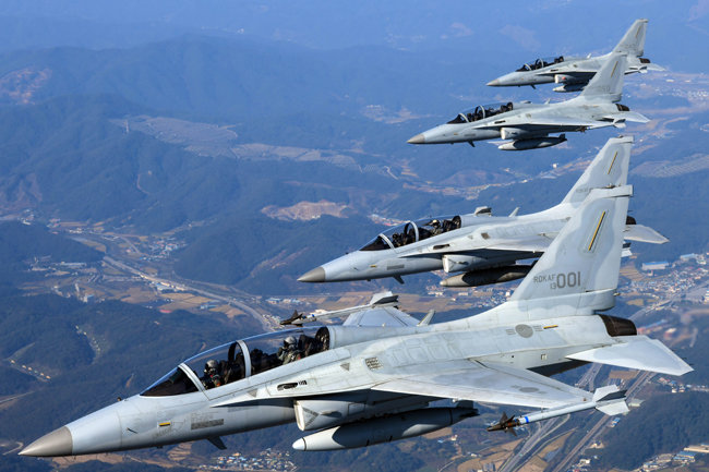

I think we'll only know once it's actually in production, but we could make some educated guess from the production capabilities of the FA-50. The KAI plant in Sacheon produces the T-50 series at its fixed-wing plant. Currently eight units are being assembled simultaneously from two production lines inside this plant, though it isn't specified how many production lines there are. There's at least three since the KF-21 prototypes are being assembled in one of those lines as well.
According to the officials, theoretically, if all lines and capabilities are used, one unit can be produced in four days. For the production time of a single plane, it is said that the whole process, including fuselage assembly - internal wiring work - engine assembly - engine run - painting - test flight, takes about 30 months for T-50 variants. However, there are other planes being manufactured in the same plant, one of which being FA-50PL that will still be produced after 2026 and will be produced alongside KF-21. Also FA-50 and KF-21 are not the same, requiring different production time.
As for KF-21, I heard that they will deliver 40 aircrafts between 2026-2028 according to the official schedule and you could deduce the yearly production rate based on those numbers. We have no choice but to get these planes as fast as we can and the schedule must be completed before the KF-5,F-4E kills more pilots.
How much is the flyaway cost? Optimistically, the price of KF-21 should be kept at around $60 million. That's the figure given by KAI and DAPA, but these days the price of any aircraft is going up day by day and I'm not sure if Indonesia will really buy 50. There's a possibility of them buying less than 50 aircraft or not buy altogether. But that's the goal. We have to keep the $60 million mark. I think that's the only way to be competitive.
Add to that, KAI can manufacture 5 TA-50s a month from the two production lines they have assigned for the T-50 variant production. So that's 60 aircrafts a year from two lines. KF-21 will certainly take longer than that, but current plans are to deliver 80 aircrafts within 4 years, which means 20 per year. Add to that, KAI would've prepared to manufacture parts and fuselage for the Indonesian Air Force while they were committed, which means there's still a headroom to grow. Also, KAI's production lines are modular and reconfigurable, which means they could transition from one aircraft type to another based on orders/demands.
