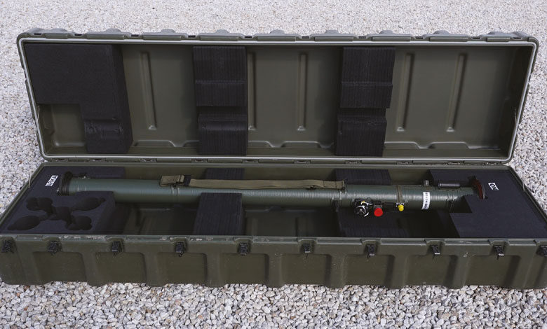

Sungur air defense missile (in canister)
