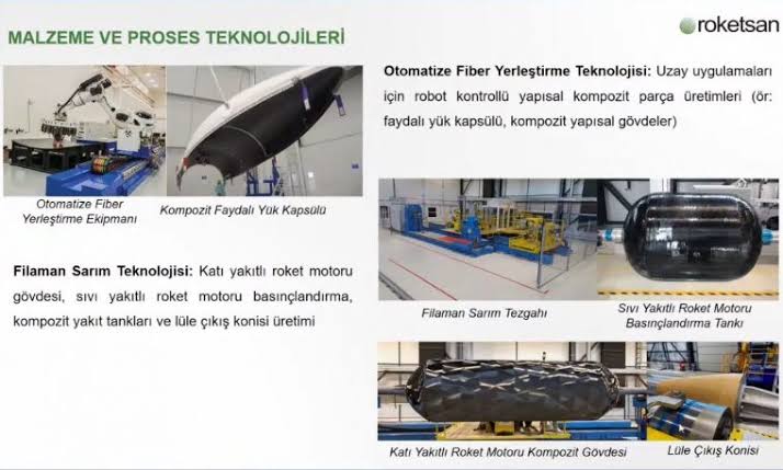

Any ideas (maybe based on knowledge of existing Turkish missile tech) on the materials used in this CENK missile? The missile's range would vary greatly if the motor casing (or even the outer shell) was made of carbon composite instead of more traditional materials like steel.
5,263
81 44,647
If I remember corrrectly, It has been around 5/6 years since Roketsan introduced composite motor casing technology to the public so all new generation Turkish ballistic missiles and 1,35m diameter Şimsek SLV are produced/will be produced with composite technology...
Impressive. If these technologies are applied to CENK then you probably have a quite high performance missile in the 1000-1500km range class.
4,840
49 16,865
One of the technologies used in Cenk
1-png.51019
Another one
images-32-jpeg.57353
Another one regarding fuel
Another one is about ablative material for the engine.
I see people comparing it to DF-12A. Cenk is a state-of-the-art, cutting-edge missile.
It is not based on a sounding rocket or based on DF-12A as İbrahim Sünnetçi suspects.
